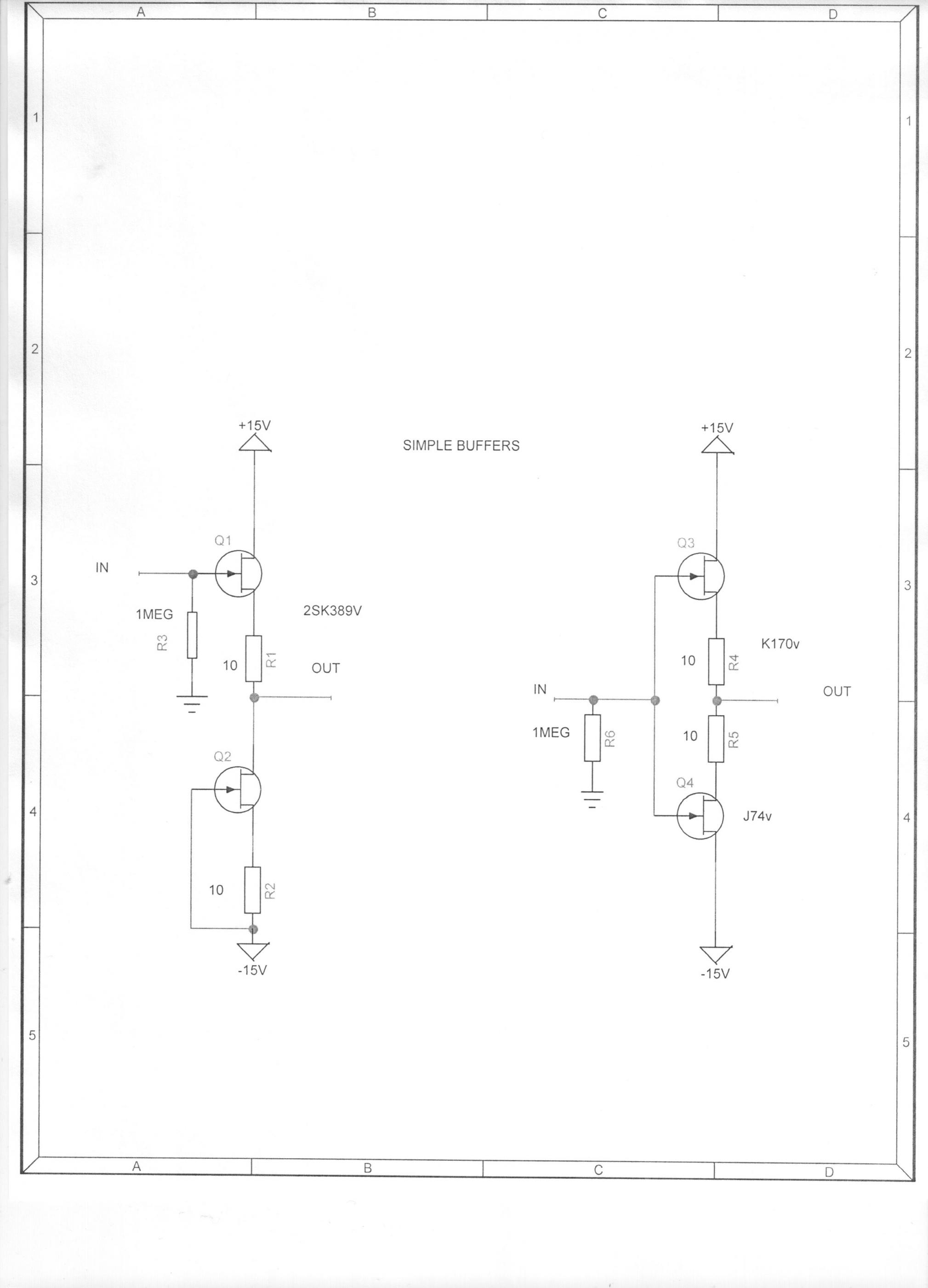

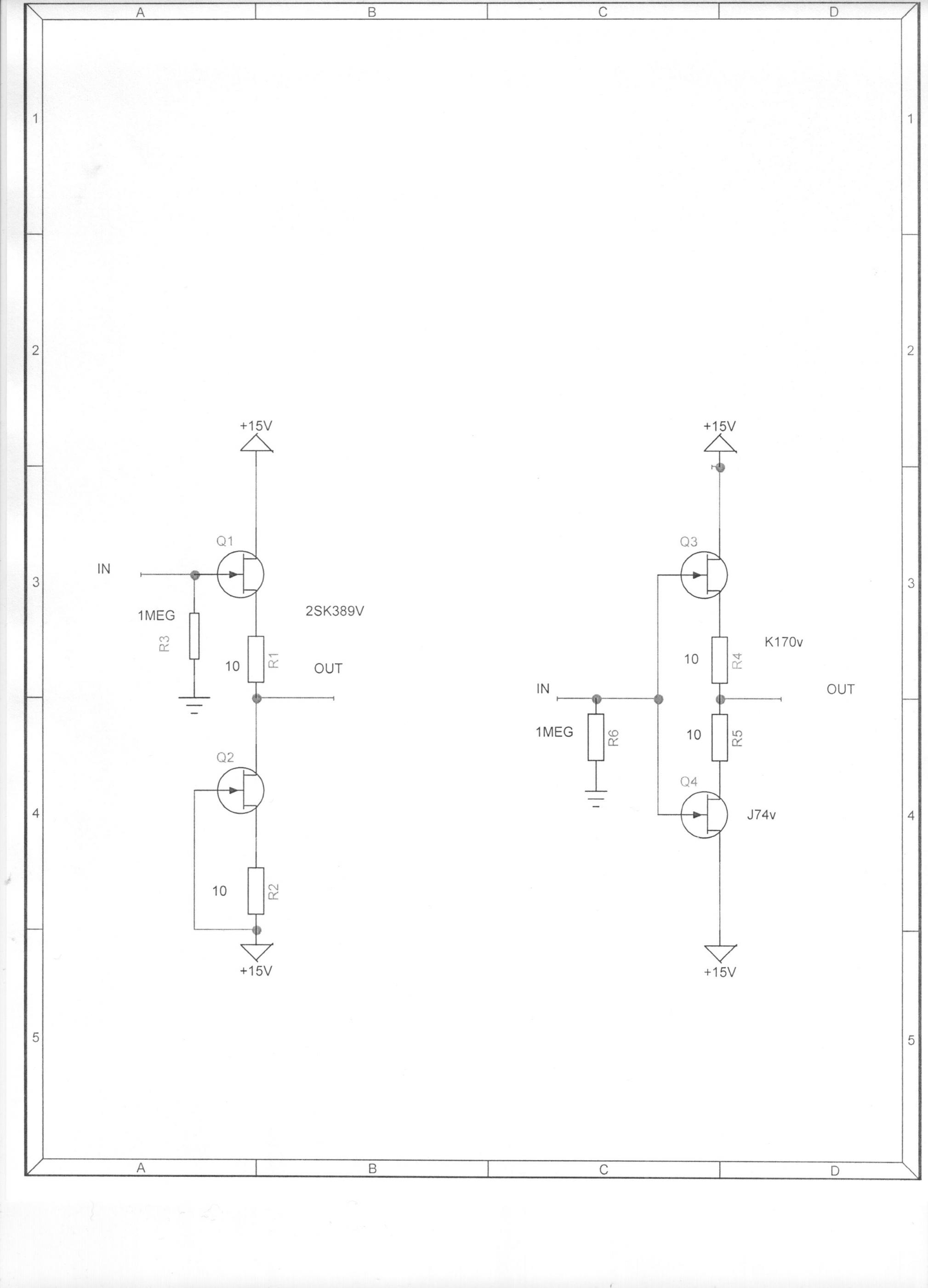

Buffer questions
Thanks, John.
If I may ask you some other questions, concerning buffers.
I purchased a double autoformer mounted on a proper selector (IVC – Inductive Volume Control) to be used as passive preamp.
I connected it to my power. The purity and quality of the sound were superb, like I never heard before on any sound setup (I wasn't fortunate to hear your CTC Blowtorch). Alas, the dynamics of the sound is gone. Since the input impedance of my power amp is 20 KOhm (Pass Labs XA 30.5), I thought that the low input impedance of the power amp may be to blame.
So I connected the output of the IVC to one of the inputs of my preamp, which has a tape out buffer, probably designed by you, and connected the tape out to the input of my power amp. Not only the dynamics is back again, actually it's much better than ever before, along with all other SQ benefits.
So I intend to build a JFET buffer to replace the preamp.
Sorting out my storage I found out that I have over 100 pieced of 2SK170V, 100 pieces 2SJ74V and similar quantities of BL and GR grades.
Here come my questions:
1. The present buffer uses 1 x 2SK389 per channel. I can use a couple of 2SK170 per channel thermally coupled. However, wouldn't there be any SQ improvement by using a complementary pair of 2SK170 / 2SJ74 per channel?
2. In either case, would there be any benefit in cascoding the initial pair?
3. In either case, would there be a benefit by using higher supply voltages, about -24V and somewhat less positive?
4. The buffer supply voltages are generated by Zeners, decoupled by film capacitor. Would there be any benefit by using better supply smoothing, like capacitance multiplier or even Jung's Super Regulator?
You see, my setup sounds so superb by having he buffer between the IVC and power amp, that I want the best possible good sounding buffer.

Joshua, that is a lot of questions.
It is possible to make a pretty darn good buffer, either by using a matched dual device, like the 2SK389, or with a complementary matched pair, that can be tweaked for low DC offset. More to follow.
Hi John,
Thank you.
I'm eager to hear more.
Please bear in mind that I'm looking here for the best possible buffer.
I'm interested in your views as for the advised topology, or topologies, no need for detailed schematics.
When using complementary pair, I can manage to get negligible DC offset. It can be done by adjusting the (+) and/or (-) supply voltage(s), and/or by trimming one, or both, source resistor(s). Servo wouldn't be necessary here.
