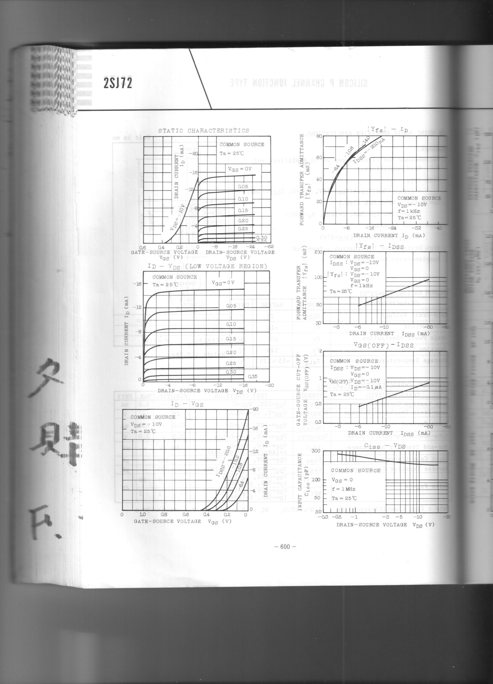

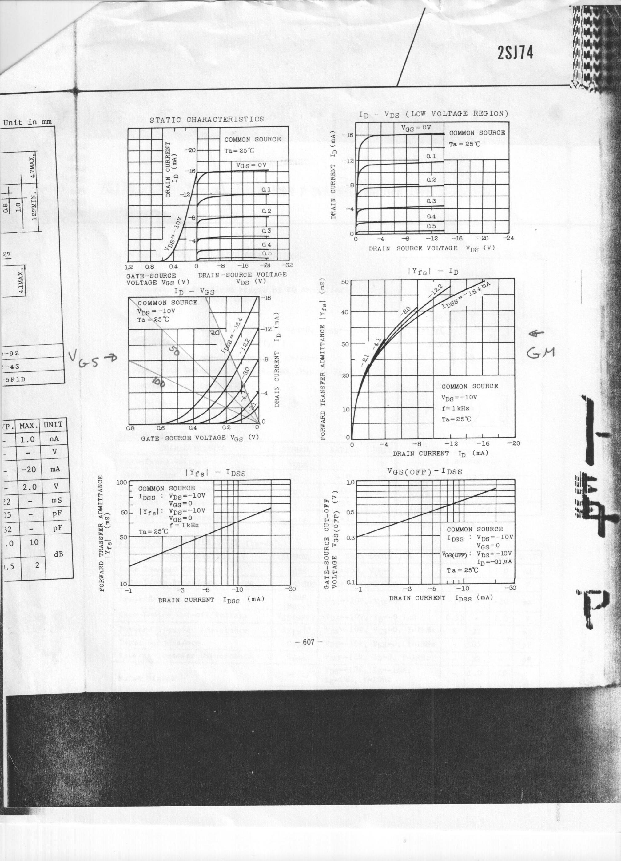

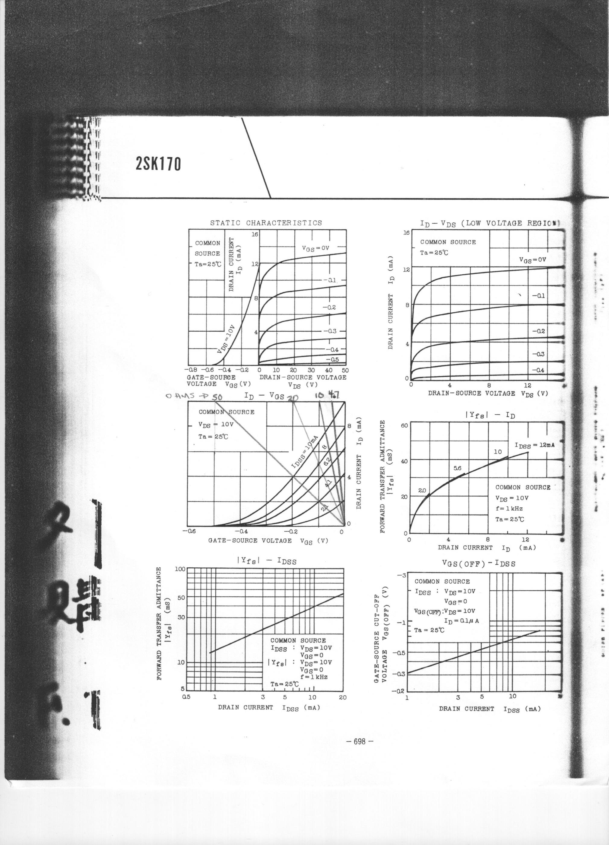

This is where my style of design is somewhat different from many other designers. I don't use a computer model, I use the graphs from the data sheets.
