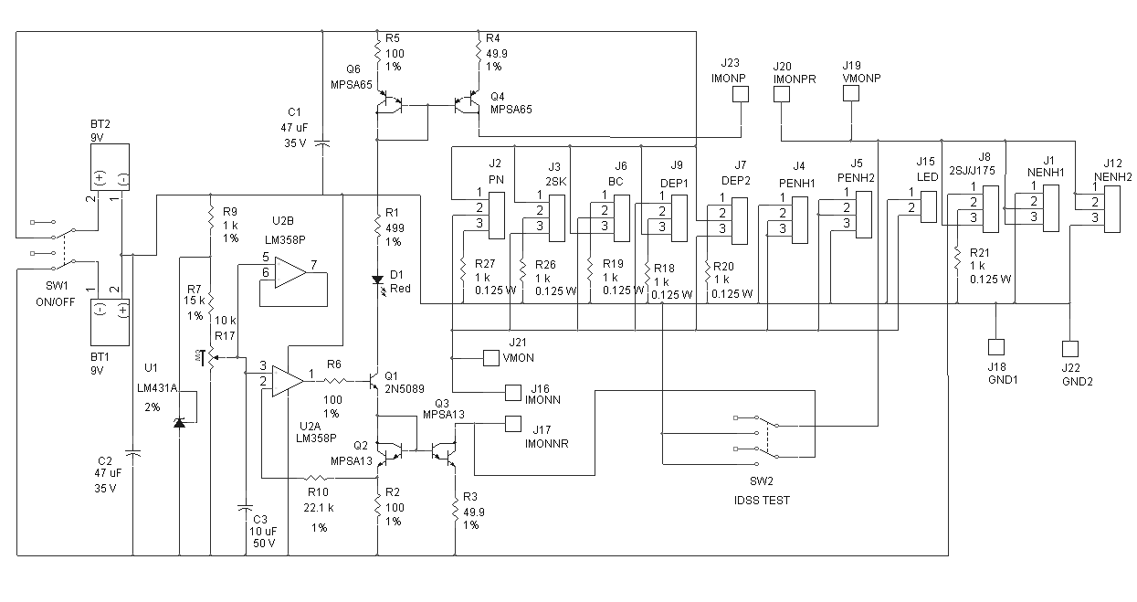

Thoughts regarding JFET selection:
How about a jig with resistors equal to R1 and R6 in place, plug in an assortment of JFET’s one at a time, measure and record. Then select JFET’s with equal current as tested in a bread board (test jig) with circuit values that match the circuit you will build? This does not test for Idss or any other single text book variable but the in circuit installed sum of variable interactions. Pick a current value that you like or fits the stock on hand.
I know, why don’t I do it? Just thoughts. I have not seen selection done this way. Seems like a practical approach

Andrew - nobody said a word about IDSS, not one. The tester I refer to has a variable current source and a jig to allow sorting Vgs vs. Id. For the SRPP circuit it appears essential to get a good Vgs match at your chosen operating current for proper output centering. Once you have the Vgs and Id, the source resistors follow (Ohm's law).
This is the fet sorting jig I currently use. It allows sorting jfets, and both depletion and enhancement mode mosfets. Current is continuously variable up to ~20 mA using a 10-turn precision pot. Two DVMs plug in via tip jacks for the measurements (reasonably good DVMs are much cheaper than panel meters, and you can use them elsewhere once you're done sorting). Though I put in a switch for testing IDSS, I've never used it.
Wrench,
you don't understand your method.
I am not criticising you nor your method.
I am confirming that Id vs Vgs takes account of both transconductance and Idss.
If you get two devices that "match up" for Id @ set Vgs for three different Vgs (but equal between matches) then you have effectively defined a curve/line that shows the relation between Id and Vgs. That curve is an expression of Idss and transconductance.
If you want to check what I have just written then include Vgs= zero volts as one of the test curve values and you will see that the curve of both devices starts at Idss and slopes up through the first point and the second point.
Now take that same pair of matched devices and set Vgs such that you have the middle Vgs value giving the bias/quiescent current and select two Vgs values that give +10% Idq and -10% Idq. You will see again that these lie on that same curve that passes through Idss.
There are other parameters that will interfere with that matching, but I contend that if you get Idss and transconductance to match in the thermally coupled pair then the effect of variability in the other parameters is relatively minor.

Maybe, but it's a lot easier to sort out pairs based on Vgs vs. Id. The gain matching between two sets of cascaded stages I've shown several times in this thread (even with an intervening RIAA network) shows that the technique suffices.
Andrew, I don't see why you insist on unnecessarily complicating the process of getting from a pile of fets to a finished SRPP gain cell. The method I have described has already resulted in 4 to 5 boards (most documented) here that have all had pretty close to the desired gain in each stage, and have matched very precisely left to right. Voltage centering in a given stage is also acceptable - indeed, this the first thing I measure when bringing up an SRPP stage to make sure that nothing has gone amiss.The only place where I have run into problems is the symmetric cascode, probably for the reasons I've enumerated already. It'll be interesting to see if I'm right.
Anyway, why don't you use the sorting method of your choice, make up a gain cell, and report the measurement results?

What I did with the cascode SRPP I currently have sitting around was to carefully select the Vgs vs. Id for the bottom fets, but not for the fets on top of the cascodes. This was a mistake, especially as the Id vs Vds characteristics aren't perfectly flat for the PN4393, less so than for devices with a longer channel.
When I get all my PN4391s together I need to yank out the 4391 cascode fets in my prototype and replace them with ones closely matched for Vgs at the Id of the bottom fets. If my reasoning is correct the stages should balance out better - after all , they center perfectly in the simulations, where all fets are precisely matched. I'll accept being within a volt or two of 1/2VCC, especially on the input stage, where the output amplitude is small. I'd want a little closer centering for the output stage, but that portion uses lower gm fets anyway.
I pick a drain current that generates good results in the simulation and then select at that current. This is relatively easy for me, as I have a jig where I can set the Id to anything I want up to ~20 mA. Unfortunately, you have to go with whatever matches fall out of your pile of fets, so the source resistors of the bottom fets may not exactly match what you have in the simulation.
I suppose you could also make a jig with the resistor of your choice in the source (don't forget a stopper resistor on the gate) and go with the Vgs values that match in that situation. In that case, your Id would be variable (though matching for the fets that match in Vgs), depending on what you have in your population of fets - hopefully not too terribly different than your desired design current. The PN4393s are problematic in that respect, as they have a wide range of specified IDSS. Parts that are binned more closely will be easier to select, like the 2SK30 - harder to get, but still a reasonable choice. There's an Ebay seller who is offering both the 2SK30 and 2SK117 in quantity. Both Salas and I have some of the 2SK30s - he thinks they may be legit.
As far as I can tell both methods posited here should yield good gain matching. Check the gain-phase plots I've posted so far for several prototypes in this thread. I also suspect that loading the SRPP cell the way I do makes for a more predictable gain.
