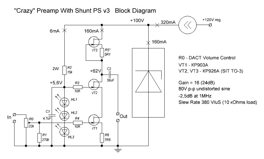

Here is a Block Diagram of the preamp that I specially designed for buffer-like power amps (no voltage gain).
Another fancy parts, SITs in TO-3 case, were used here. The gain and the balance between channels are achieved by parts selection, no NFB used. Zout near 300 Ohms.

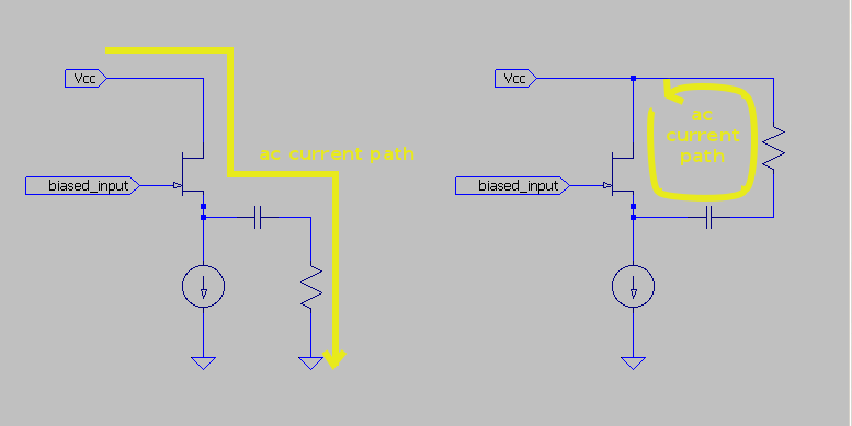

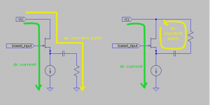

When a CCS is the only element connected to power or ground in a circuit, the power-supply draw will be constant (in the ideal). However, the typical follower circuit on the left is class-A single-ended biased with a CCS, but the current draw from the supply is not constant (all AC current to the load is drawn directly from the supply). In contrast, the variation of the OP (and Ciuffoli), on the right, does draw constant current from the supply (having only a single CCS to ground). Everyone, including me, has simply been pointing out this distinction to you.

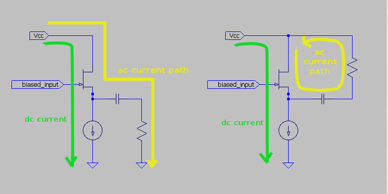

WuYit,
I really don't know how to break it down more clearly, except maybe to add the DC current flow to the graphic and appeal to its properties. Understanding that 'total current=dc current + ac current' at any 'edge' in the circuit graph: We see that the left circuit has varying current drawn from the supply (DC+AC) while the circuit on the right has only unvarying current (DC) drawn from the supply.
If this explanation is still too muddled, I recommend reviewing Kirchkoff's circuit laws, and the concept of superposition.

Andrea is correct.
The leftmost diagram is not constant current. The rightmost diagram is essentially constant current.
Almost all SE ClassA (buffer) stages adopt the leftmost diagram.
Use of the rightmost diagram is extremely rare.

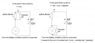

to avoid including an accuracy aspect, we assume that the CCS`s are perfect. In both circuits, the same amount of DC current flows through the amplifying device and the CCS, determined by the CCS, not changing or exceeding its value. It is the total current. A portion of it is converted to AC for the load (and will be used up), an affair strictly between the amplifier and the load, not seen by the power supply. While the DC current is constant, the AC power is anything but constant, all values are instantaneous. Kirchhoff's Law and other laws apply, but not needed for the explanation, everything is straightforward.
This is another one variant of explainations. If WuYit accepts this, many will be happy
