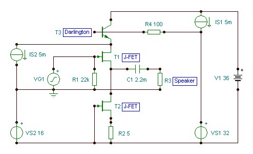

the decent conventional biasing method, whereby the voltage is directly applied to the gate and source is not in need of improvement. Reverse bias gives linearity. Acting as a voltage source, the series pass device should be bipolar. (Shall we call it the poor man`s choke?)

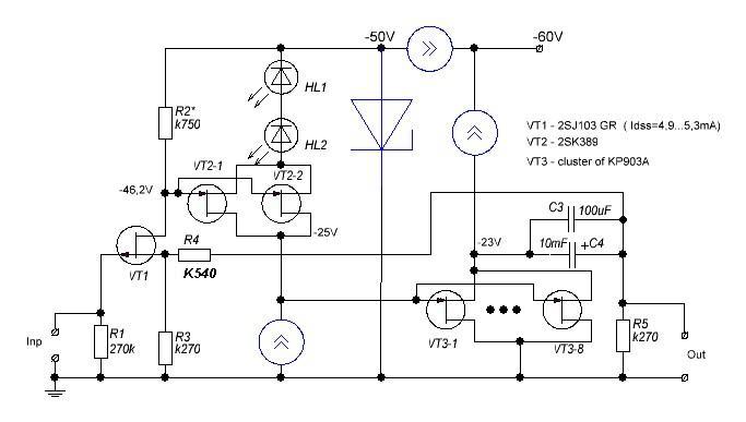

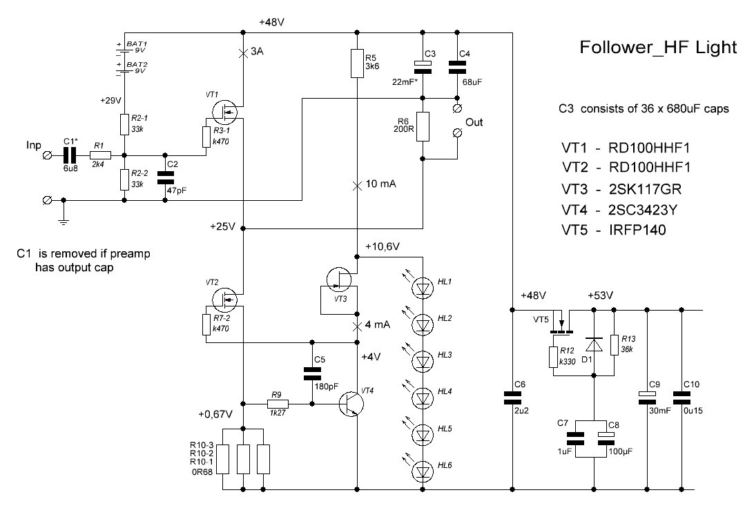

This is another version of ground referencing and load connection.
People noted that in this version an influence of the output caps C3 and C4 is additionally diminished.
In this version, EMF of distortions from electrolytics do not sum up directly with output signal, instead, it is applied to the drain of the active device and act as power rail distortions. Active device suppresses it partially.

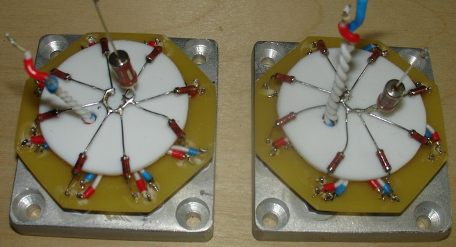

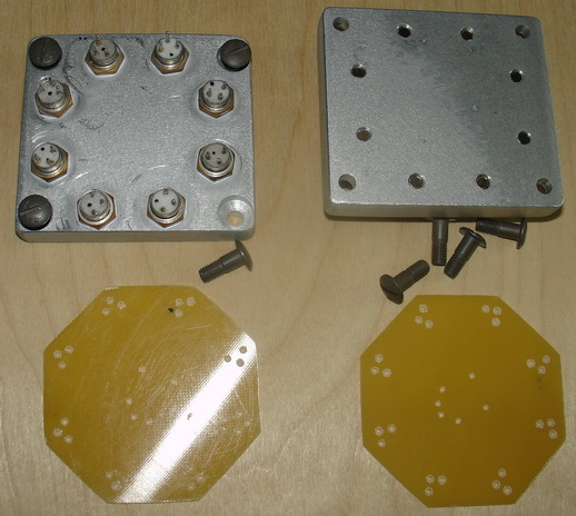

This is my next step to more powerful jFET, cluster of 8pcs matched KP903A.
Idss is close to 4A, Ciss less than 200pF. It is planned for using with 2,5A idle current.
The heat is spreaded by 12mm aluminium slab, the screws are from non-magnetic material (titanium).
New buffer will be probably extended by front-end amplification stages, and probably current NFB will be added for achieving Zout less than 0,1 Ohms.

What will the circuit board material be used for? Looks like you screwed in the JFETs and then drilled the circuit board material to match where the pins ended up after tightening them into the aluminum slab.
se
Hello, Steve
I used standard PCB material, glass fiber plastic. It is not copper plated, just a plastic. I did p-to-point wiring (monowire in teflon), then put teflon circle over the wires, and gate stopper resistors over it.

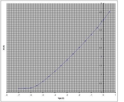

Here I enclose shots of the assembled devices, and some measurement results.
Working point is planned at Id=2,2A, Vgs=-2,4V. Linearity around the working point is very good, although transconductance at this point is near 0,7S only, not so high.
Therefore, using of some NFB for decreasing Zout could be desired.

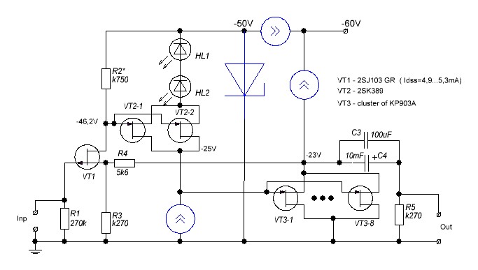

mea culpa - I meant like this , but forgot on source potential .......... 😉
This version is also attractive, it will need removal of R5.
And, from my previous experience with Zen9, taking the NFB after output cap, although theoretically attractive (cap distorsions are suppressed), cuases unfavourable electromagnetic interactions, and makes difficult (additional correction needed) to have a nice square-wave responce.
At the moment, I would prefer your previous version, it is suitable for integrated amp, and Zout can be close to 0,1 Ohms.

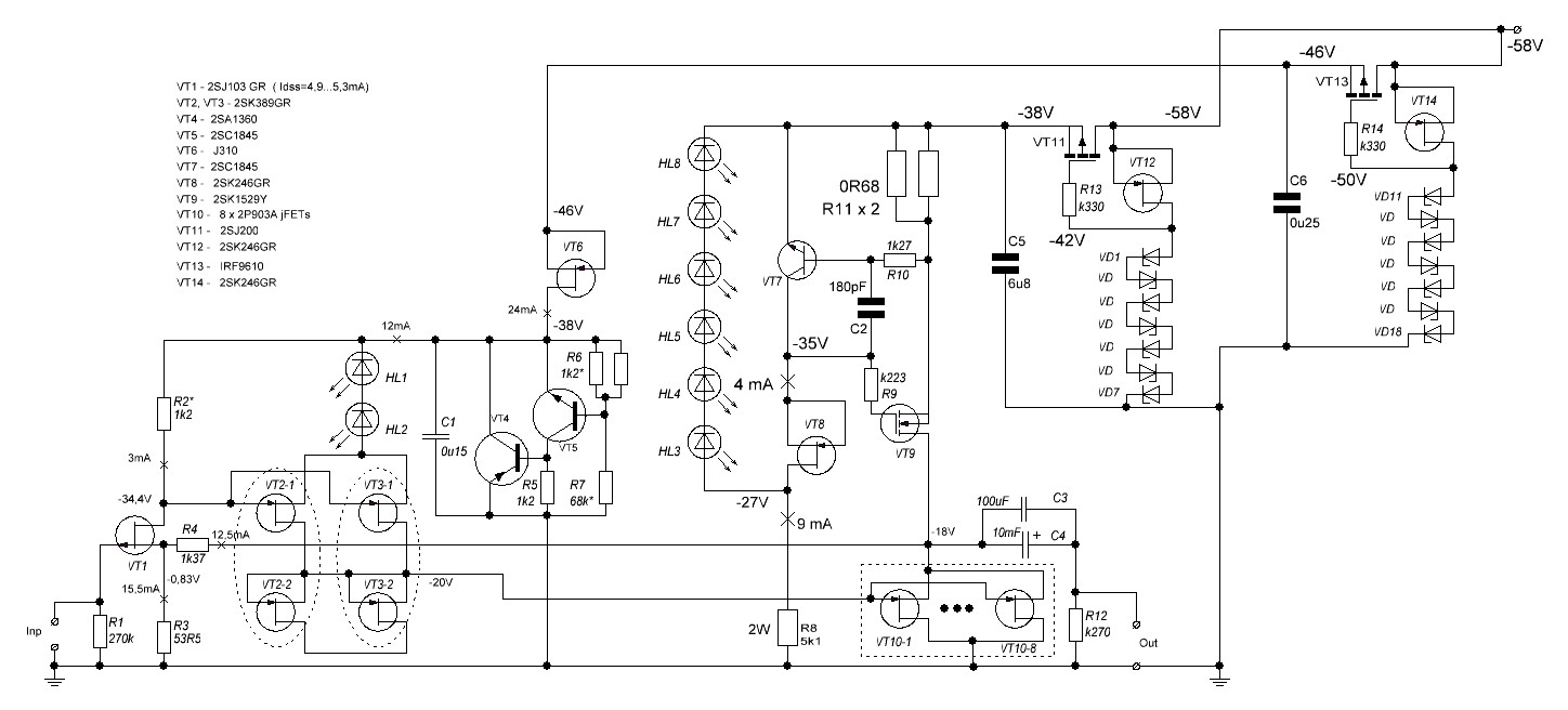

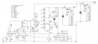

This is an implementation of the draft schematics into more detailed schematics layout.
I hope that using 2SK389 as VT2, VT3 will ensure thermal stability, that is usually a problem with CCS-like load. If it is not the case, than resistive load will be used.
but your GND is now directly connected to the main PSU and transformer....the purety in the previous was that the CCS shielded the GND or low voltage ans the higher rail was regulated..So you by those choices took the PSU effectively out of the loop.. Now you put them back in..??
