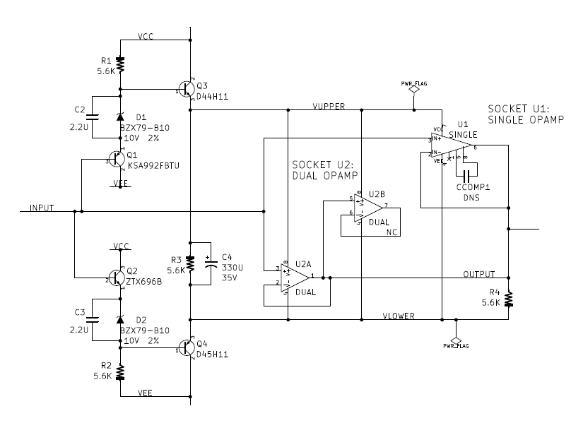

Some people are using the circuit attached below, as the input buffer of their First Watt M2x power amp.
It's a unity gain opamp, whose power supply rails "VUPPER" and "VLOWER" are bootstrapped to the input signal. Thanks to the unity gain connection, this is also the output signal.
Now the music signal is superimposed upon the supply rails. PSRR shoots through the roof, and "common mode distortion" is drastically reduced.
Also of note, the output loading resistor "R4" is bootstrapped so it becomes a constant current source. This helps to linearize the opamp's output stage and reduces crossover distortion.
If you want to see more, google search for "M2x" and "IPS7" on site diyaudio.com
{the funny business with three triangles on the schematic is simple: there are two DIP-8 sockets on the PCB. One of them for dual opamps like NE5532. Another of them for single opamps like LT1122. Builders can try whatever opamp they happen to prefer, whether it be a single OR a dual. But of course only one DIP-8 at a time!!}

thanks Mark. question is , with OPAMPS like OPA1642 which are unity gain stable and very good common mode rejection , is it really necessary to use such design? I'm trying to keep it simple as possible , while allowing some flexibility to play with different ICs.

You can get some measured improvements with bootstrapping. But in my experience, distortion is already so low it doesn't translate into audible improvements. Same with class A biasing.
This said, I would add a low pass filter at the input of your schematic to keep HF out. Your 1K input resistor is very low too. If your source can drive that, you don't need a buffer at all. I'd use at least 10k. Finally, an output resistor around 47r would be good practice.

A bootstrapped input with BJT somewhat defeats the purpose of a JFET input amp.
