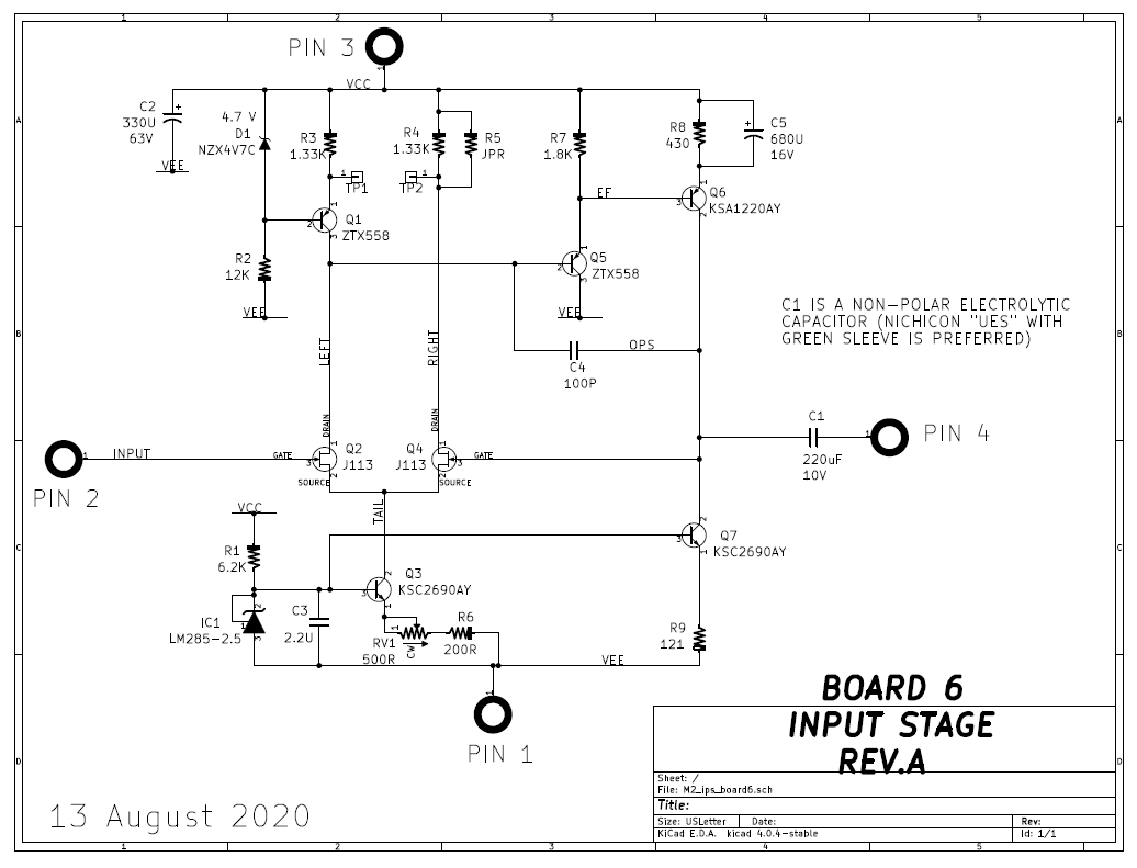

My most recent JFET circuit is shown below. A quick analysis indicates that these JFETs spend all of their time working in a much narrower range of maybe one or two orders of magnitude of Idrain. So to simulate this circuit I only want good agreement between model and real device, on a small piece of the log(Idrain) vs Vgs curve. So there's a much better chance of getting a pleasing agreement.
But: just how representative is this circuit? Just how big a crackpot am I? Judgement calls.
