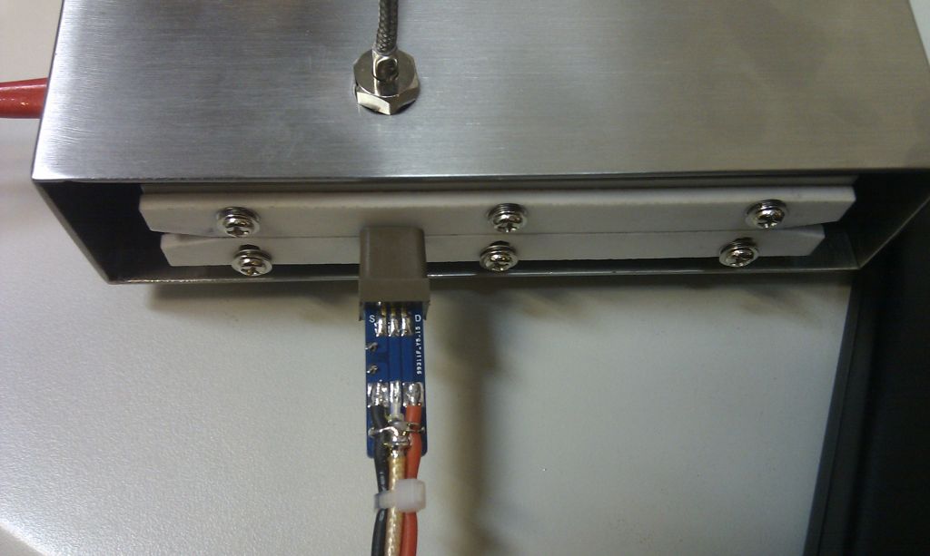

made me once this tester-Jig ....think its built after Borbely´s circuit suggestions.
Looks a bit like a women´s remote commander, doesn´t it? 😉
You noticed the hightech temperature control dome at the lower right?
All that just to grab the FET at the *****
jauu
Calvin
.... we´re weirdos from another planet 😉

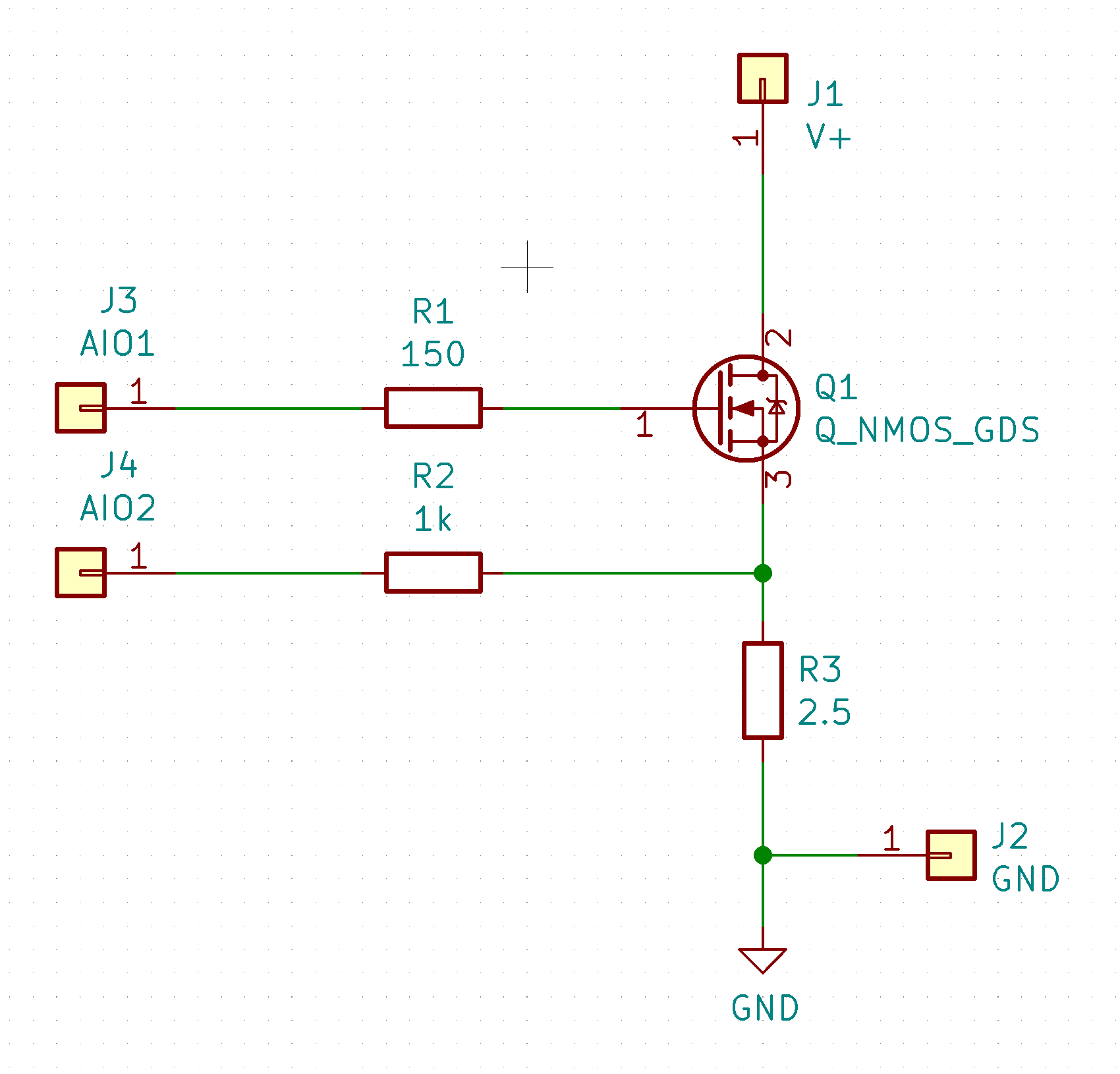

I'm moving in the direction of low duty cycle pulse testing.
Thoughts on this idea? An Arduino can output 0-5 V on AIO1 to drive the gate of the nmos. AIO2 can measure the voltage on the top of the source resistor to determine Ids. Vgs=AIO1-AIO2. The Arduino can automatically step through various Vgs to generate a curve from which transconductance can be estimated.
For power mosfets, Vishay suggests a 80us pulse width at a low duty cycle (e.g., < 2%). https://www.vishay.com/docs/90715/an957.pdf. This would be straightforward to implement on the Arduino.
If we wanted to stabilize temperatures, we could have a thermistor on the mosfet's heatsink and the Arduino could set the "off" Vgs to some baseline Vgs that heats the heatsink enough to reach a target voltage drop across the thermistor (gotta break out my controls textbook for the PID chapter). The "on" pulses could simply deviate from this baseline.

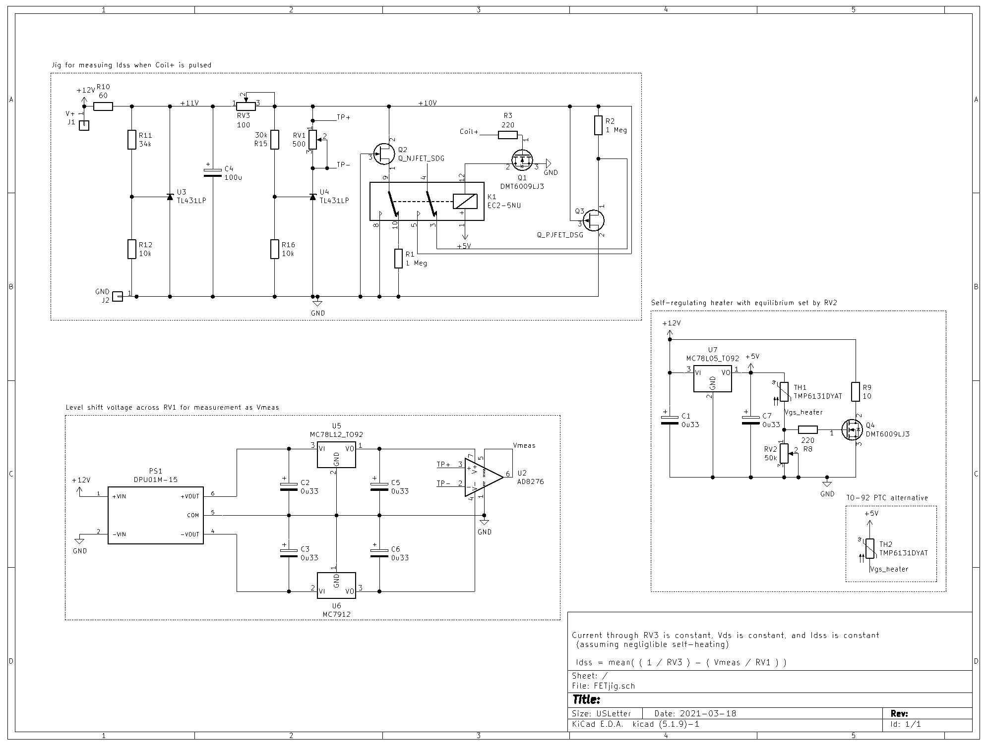

Self-heating jig for pulsed measurement by microcontroller
Here's my current thought on a jig for pulsed measurement of Idss, especially in the context of a SOT-23 package (e.g., 2SK209, MMBFJ270). The SOT-23 DUT can be clamped onto oversized pads using a spring clamp for consistent clamping pressure. An Arduino-type device can measure Vmeas with +5V used as Aref.
The board can have a 10 Ohm DPAK power resistor switched by an NMOS to pump heat into the area around the DUT, and a PTC thermistor nearby the DUT will manage the Vgs on the NMOS to reach a consistent target temp. The SOT-23 DUT should (!) be close to the board temperature due to its relatively little thermal mass.
There's a little complexity introduced by trying to keep Vds on the DUT constant, which prevents a current sense resistor to be inserted in series. That might be an unnecessary complication, given the relative stability of Idss over Vds - thoughts?
EDIT: forgot to note on the schematic that the current through the 30k and 10k resistor on the 10V shunt is about 250 uA, and should be included in the calculation of Idss
If you're going to test big power MOSFETs with big QGtot, the Arduino is going to need to supply a LOT of output current. It needs to charge up the MOSFET gate to the desired analog value (example: Vgs = 3.61V) in 20 microseconds (1/4 of your 80 microsecond measurement window). You might want to install a buffer opamp between the Arduino pin and the MOSFET gate, then install a series resistor to prevent that opamp from oscillating with a gigantic capacitive load.
This setup was only designed to test jfet Idss. To test power mosfets, I'd also need to rethink the PSU.
EDIT: I apologize for any confusion caused by post #32 - that was a half-baked idea from last year. Post #33 is a JFET-only jig.
