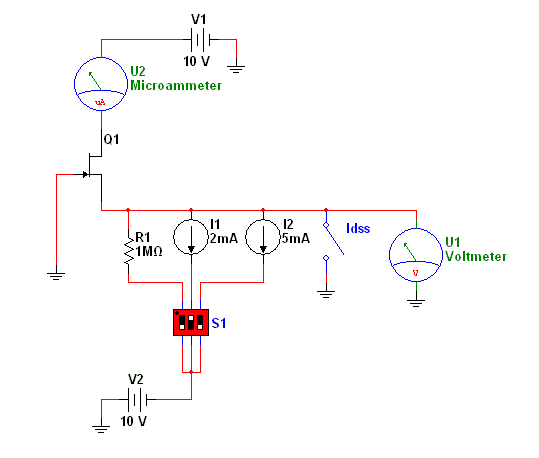

I am currently matching my jfets using a breadboard. But I wanted to make something more permanent.
The nicest arrangement I found was the one from runoffgroove. It allows idss and Vp measurement.
A closer look at the Fetzer Valve
The 10M used for Vp still allows some current through the jfet, but it should be close enough for matching.

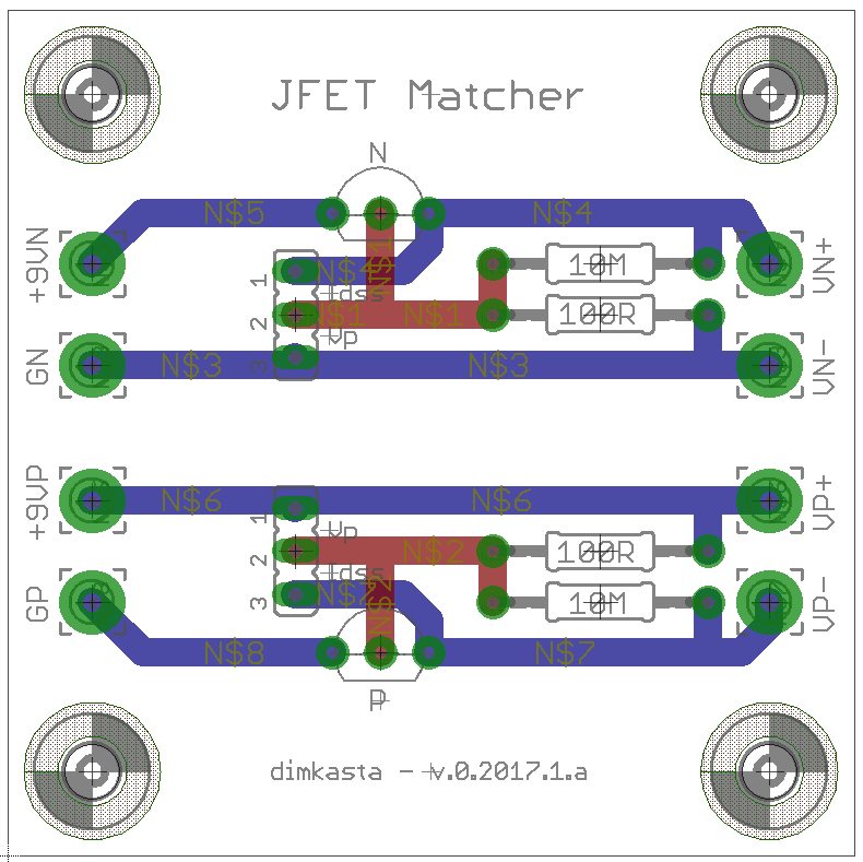

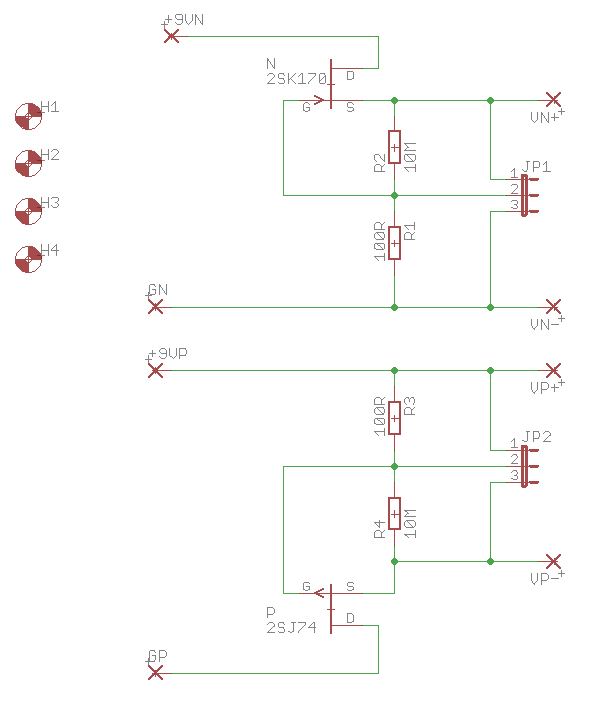

Here is my schematic
attachment.php
And this is the pcb
attachment.php
A jumper or a switch will be used to change between idss and Vp mode.
I will order the pcb on Monday. In the meantime any input is welcome.

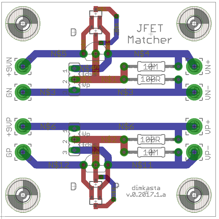

Better allow for surface mount devices -- TO-92's are going the way of the dodo.
Yeah I was already working on that :)
attachment.php
It allows for any drain/source pinout combination, so that non-symmetrical devices can be measured.
D marks the drain.
Through hole devices can just be reversed if they have a different pinout.
