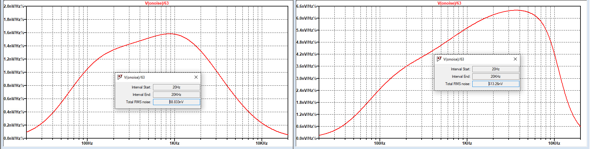

When computing the A-weighted S/N for a specific Cart while connected to an amp, the total A-weighted noise from the amp’s output, including all voltage and current noise elements, has to be normalised for its gain at 1Khz and compared to the Cart’s output at 5cm/sec@1Khz, mostly 5mV for an MM or 0.5mV for an MC unless a more exact figure is known.
Question: How do we call this A-weighted output noise divided by the gain at 1Khz: This is the A-weighted Equivalent Input Noise @ 1Khz, right ?
One could look at the normalised spectrum and read the spot noise at 1Khz. This is what Syn08 does in his reports, and he calls this En@1Khz.
When looking again at the normalised spectra below as given in #105, spot noise at 1Khz is resp. 1.6nV/rtHz and 5.5nV/rtHz for the used MC and MM.
But since the shapes of these noise spectra are quite different, I find this spot noise figure not as representative as the average A-weighted noise over the same 20Khz, in this case 0.63nV/rtHz and 4.4nV/rthz, quite a difference from the above spot noise figures and giving a much better feeling about their to be perceived noise performance.
Of course nobody has to use these averaged figures, but I find them much more useful than a figure for the total noise.
When the normalised A-weighted total noise in Volt be called: A-weighted EIN@1Khz, then the averaged version in V/rtHz should be called: A-weighted AEIN@1Khz (for AveragedEIN), can we agree on that ?
Hans
