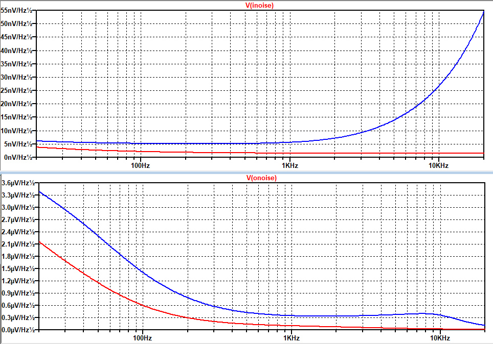

I have put the generic model into LTspice, using 2SK170 and 2SJ74 for the input and 2SK1056 and 2SJ162 for the output.Sorry but it is the inductive impedance magnitude in parallel with 47k input resistor that makes the noise. Please let's not speculate about iron losses, if you put the circuit into Microcap you get the same noise rise. And Microcap knows nothing about iron losses in the ideal inductor used for the simulation.
A gave the input Fet's 1 mA bias each and the Mosfet's an idle current of 23mA.
With that setup, I was completely surprised by the very low noise level at the input.
With 50R at the input the equivalent A-weighted input noise for this Riaa amp gave 631pV/rtHz, that's adequate for almost all MC Carts !!
A 50R MC Cart would have a S/N of 75dB(A) ref 0.5mV@1Khz.
This of course under the premise that my LTspice models for both input Fets are correct.
But if so, it is the first amp that I came across that could be used for MC and for MM.
A second amp directly behind this amp with switchable gain could adjust for the overall required MM or MC gain, at the same time giving a low impedance output impedance, making the connection to a preamp less susceptible for EMF from outside.
The images below are resp. showing the unweighted input and output noise at 36dB gain for a 50R MC Cart in Red and for a 700mH/1.3K Orto Cart, terminated with 47K//125Pf in Blue.
Hans

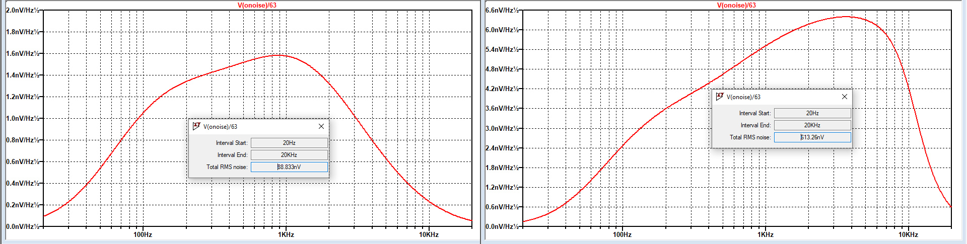

And here for completeness the A-weighted noise spectra for a 50R MC Cart and a 700mH + 1K3 MM Cart terminated with 47K//125pF.
20*log(0.5mv/89nV) = 75.0 dB(A) for a 50R MC Cart ref 0.5mV@1Khz
20*log (5mV/613nV) = 78.2 dB(A) for a Orto 2M Blue Cart ref 5mV@1kHz.
equivalent A-weighted input noise with the MC Cart is 89mV/Sqrt(20Khz)=630pV/rthz
Equivalent A-weighted input noise with the Orto Cart is 613nV/Sqrt(20Khz) =4.4nV/rtHz
For both MC and MM excellent figures.
Hans

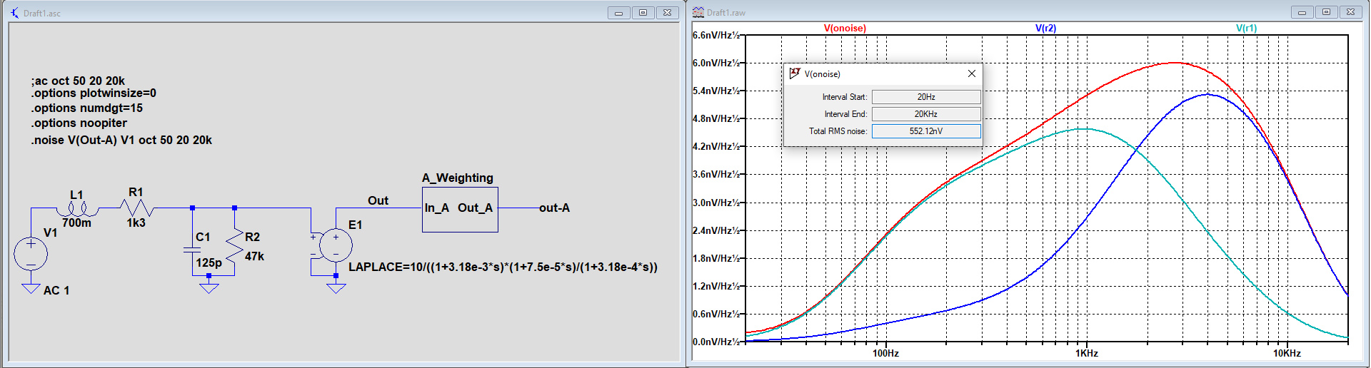

Those last two equations make no sense, as the noise bandwidth of a RIAA correction filter followed by an A-weighting filter is only 3212 Hz...3220 Hz (relative to the gain at 1 kHz), not 20 kHz.
RIAA and A, 1 Hz ... 1 MHz: 3220.23 Hz
RIAA and A, 20 Hz ... 20 kHz: 3214.16 Hz
IEC-amended RIAA and A, 1 Hz ... 1 MHz: 3218.79 Hz
IEC-amended RIAA and A, 20 Hz ... 20 kHz: 3212.71 Hz
With 700 mH cartridge inductance, the 47 kohm termination resistor's noise is already close to 10 nV/sqrt(Hz) RIAA- and A-weighted average.

Marcel,
Sorry, but I have no idea what are trying to tell.
See image below for a 700mH + 1k3 Cart terminated with 125pF//47K,
noiselessly processed by Riaa and A-Weighting, with a gain of 0dB at 1kHz,
output noise is 552nV and you also see the noise contribution from the 47K and the 1k3 resistors, resp V(r2) and V(r1).
I don't understand your 10nV/rtHz for the 47K resistor.
A flat Amp with 3.9nV/rtHz input noise will produce exactly the same input noise over a BW of 20Khz [3.9nV*Sqrt(20Khz) = 552nV].
Maybe this equivalent noise figure is not what you are used to look at, but I find this figure quite informative.
Hans

If you check the integrated output noise due to just the 1.3 kohm, you will see it is roughly sqrt(4 k T * 1.3 kohm * 3214.16 Hz * gain at 1 kHz), not sqrt(4 k T * 1.3 kohm * 20 kHz * gain at 1 kHz).
Let’s agree that we look in a different way at the same things.
For me the equivalent input noise is just another figure that I like to use, but you seem to have your own methodology.
But the only thing that really matters is the S/N, there can be no disagreement on that.
Hans
Hans
I don't think Hans is doing that, he is just creating his own figure of merit. He is comparing the heavily frequency shaped noise of the circuit in a 20k BW to what flat noise in a 20k BW gives the same rms noise, some might find that useful.
Hans, of course you can calculate whatever you want, but when you write "Equivalent A-weighted input noise with the Orto Cart is 613nV/Sqrt(20Khz) =4.4nV/rtHz" I get the impression that you mean that 4.4 nV/sqrt(Hz) of white voltage noise at the RIAA amplifier input would produce the same integrated A-weighted noise at its output as the noise that is actually there.
Apparently you don't mean that at all, you mean that 4.4 nV/sqrt(Hz) of white voltage noise at the input of some fictitious amplifier with a 20 kHz bandwidth that has the same gain as the RIAA amplifier has at 1 kHz, produces the same amount of noise at the fictitious amplifier's output as there is at the output of the A-weighting filter that the RIAA amplifier is connected to. That's such an unusual definition of equivalent input noise that I would never have guessed that that is what you mean.
So for example, the equivalent A-weighted input voltage noise of an NE5534A would be 3.5 nV/sqrt(Hz) * sqrt(3214.16 Hz/20 kHz) ~= 1.403 nV/sqrt(Hz) according to your definition.
