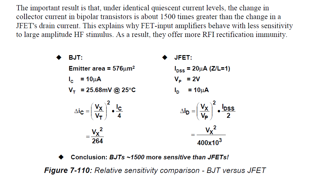

You might be surprised, but I have a different reason why to vote for the JFET input. The reason is much higher RFI immunity and immunity to input rectification, of the JFETs. JFETs are much better in this regard than BJTs and BJT input opamps. I also want for my phono preamp to be absolutely hum an buzz free, when connected into the audio chain. Real life whole audio chain is the target, not the single component theoretical parameters.

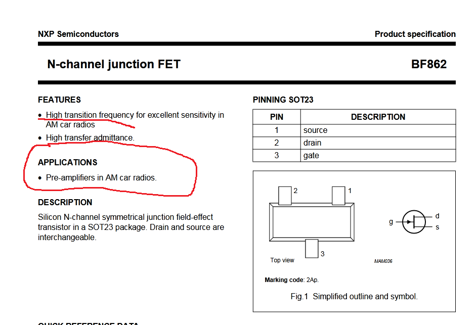

Really? I thought that bf862 became some sort of miracle j-fet for both mm and mc especially because you can put a lot of them in parallel and raise the input capacitance a bit as 1 2sk170 has the input capacitance of three paralleled bf862, but then you still need to add some more capacitance to load the cart , otherwise...

A ferrite bead works wonders for RF suppression of bipolar input opamps or discrete amplifiers. I spent many an hour in an EMC chamber decades ago discovering this.
Oh goodness me! I just forgot for a minute that they bigly affect the sound deleteriously.
This might very well be the case, but I just wonder why I have never heard this argument before for this sort of applications.
Could you substantiate this with a suggestion how to make this measurable, for instance by placing a GSM close to the Cart or maybe you even have some measurements available.
Hans
You could just connect an AM modulated signal generator to the input, or look up the many EMC standards and do some standardized conducted interference tests. The effect of an AM modulated signal at the input should also be visible in LTSpice, although differential pairs will have better matching than in real life, so the even-order terms that cause unwanted demodulation may be weaker than in reality, and board parasitics will be non-existent.

A quick search here and in the Web brought up this:
https://www.analog.com/media/en/training-seminars/design-handbooks/Op-Amp-Applications/Section7.pdf
Page 7.122
and
https://www.analog.com/media/en/training-seminars/tutorials/MT-096.pdf

Thanks for posting the links to the documents, sottomano, that's exactly what I mean and what has been investigated decades ago.
Hans, Marcel, there is not much reason to repeat those thorough investigations mentioned hereabove again, I think we all did our kind of research decades ago as well. The linked data are just facts. Until now I routinely find the issue with BJT input bad RFI immunity in some higher gain circuits for instrumentation. And I think all of us who live near to strong AM radio transmitters know the situation when BJT input phono preamp adds a local radio demodulation into the signal, though JFET input preamp is silent.
A small relevant screenshot from the linked document is attached.
