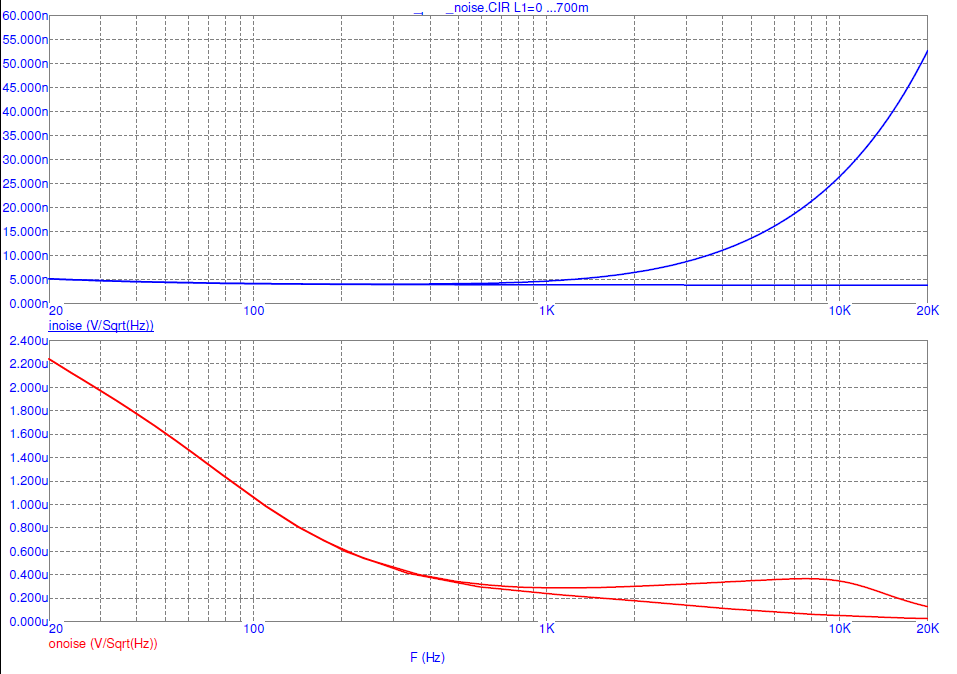

One can see that noise resulting from cartridge inductance is dominating at middle and high frequencies and can't be improved by lower noise design.
That doesn't make sense to me: inductance is reactive and doesn't produce any thermal noise. The noise increase with a cartridge connected must be due to a combination of the iron and other losses of the cartridge and the noise of the input termination resistors of the amplifier, which you could replace with an electronically cooled version if you like.
Sorry but it is the inductive impedance magnitude in parallel with 47k input resistor that makes the noise. Please let's not speculate about iron losses, if you put the circuit into Microcap you get the same noise rise. And Microcap knows nothing about iron losses in the ideal inductor used for the simulation.

Re-measured for you in dBV/sqrt(Hz), PSD. To get input noise, please consider that 1kHz gain is 36dB. The soundcard with considerably lower noise was used for this measurements, so the RMS value for 50 ohm has improved a bit.
One can see that noise resulting from cartridge inductance is dominating at middle and high frequencies and can't be improved by lower noise design. Last but not least, real life noise is determined by empty groove noise and is at least 20dB higher than the preamp noise, so the fight for lowest noise design does not make much sense.
This is more in line with what I’m getting - your spot noise floor numbers are better. I get c. -124 to -127 dBV with the input to the pre shorted at 1 kHz and get -75 dB ref 5 mV with a 1350 Ohm plus 500 mH inductance shunting 47k.

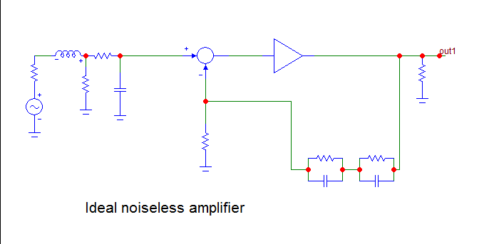

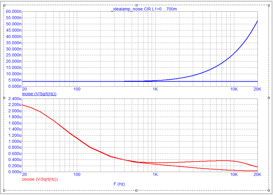

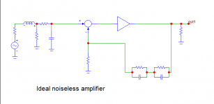

Yes that's correct, but as long as 47kohm is a recommended load value for the MM cartridge my statement is right. To demonstrate, there is the same circuit with MM cartridge simulated impedance and ideal noiseless amplifier used. The results are just same as with the real amp. So, with an usual MM cartridge and 47k recommended load resistance, circuit design cannot improve the intrinsic noise. It can make it worse, if the design is poor, but there is almost no chance to get worse than empty groove residual noise. So we have nice toys with almost no real life impact on "sound quality".

I gather you are not familiar with electronic cooling. When you make an amplifier with a gain of -A and put a resistor of A + 1 times 47 kohm between its input and output, you have effectively made a 47 kohm resistor to ground, but with ideally an A + 1 times smaller noise power spectral density. It's a very common technique in RF design and it has been known since 1939, but you don't see it much in audio.

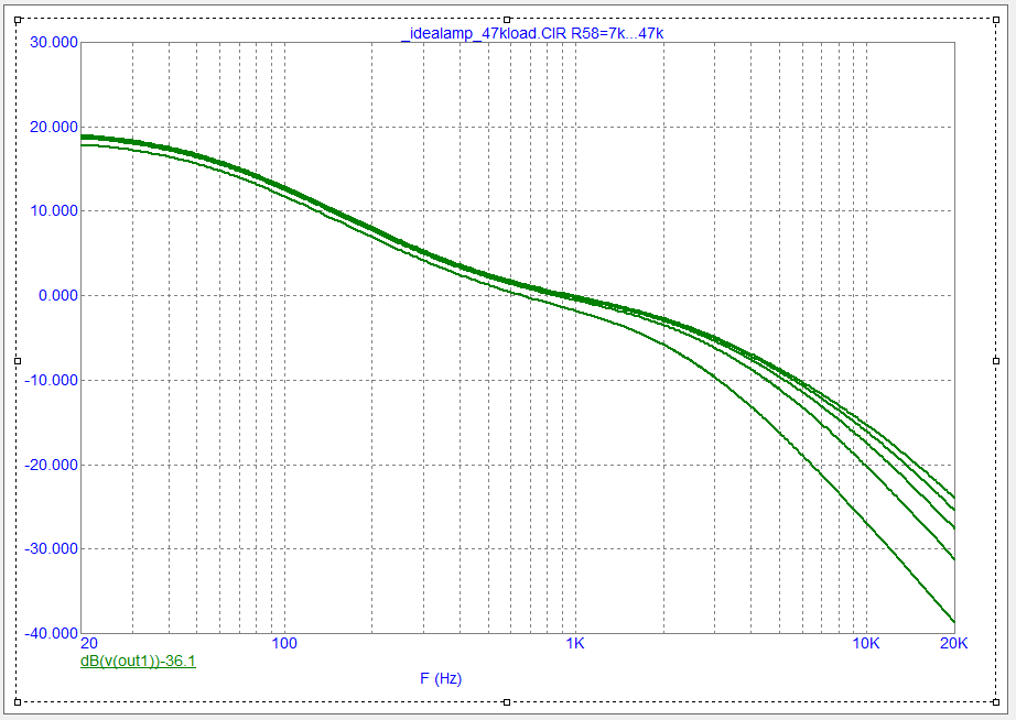

Changing the 47k load resistance of the MM cartridge significantly changes the frequency response. Remember that MM lumped impedance is a series combination of the resistor and the inductor. This loaded by recommended 47k. If you change the 47k to something else, you get different frequency response of the Rs-Ls to Rload divider. Below is the simulation for 1166ohm + 510mH cartridge loaded with 7k to 47k resistance. You would need to change the RIAA EQ feedback values when changing the 47k to something else.

The load resistor can be reduced to address peaking. There are some graphs around the forum showing this - the peaking more often than not due to stylus tip resonance than cart L interacting with load capacitance. I’ve tried this with my Ortofon 2 Red and interestingly, you can soften the top a bit.

The short answer is no. You have to measure the cart as the specs can be all over the place. Loading down that far also gives a 7dB noise penalty (which cooled loading can claw back for added complexity) so the Cordell approach of putting the L-R pole and 8KHz and a matching zero in the RIAA response seems to be a good half way house.
