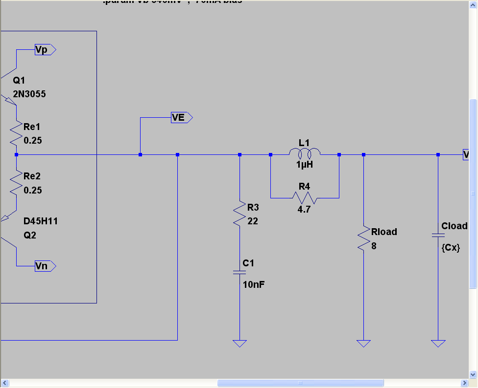

output coil

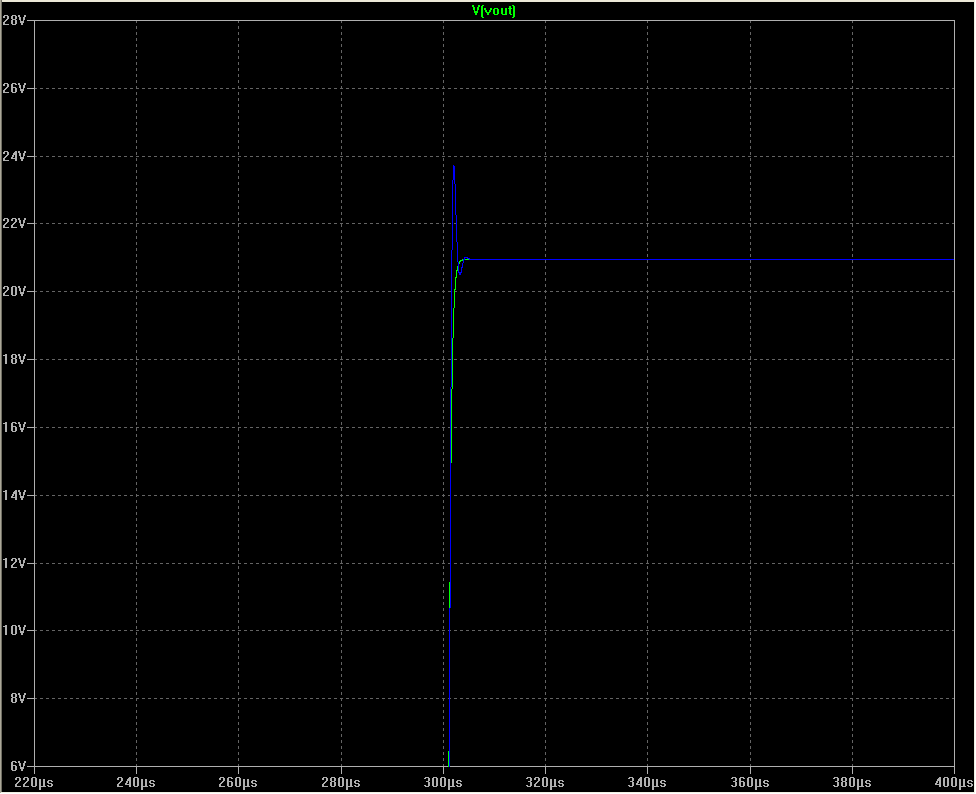

I took a simulator example that Paul had sent me to look at quelling the ringing when driving the 100nf load. The first example is what I will call the baseline example. The sim steps through a 1p load and then a 100nf load. The green trace is the 1pf and the blue is the 100nf.

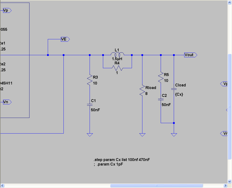

output coil part two

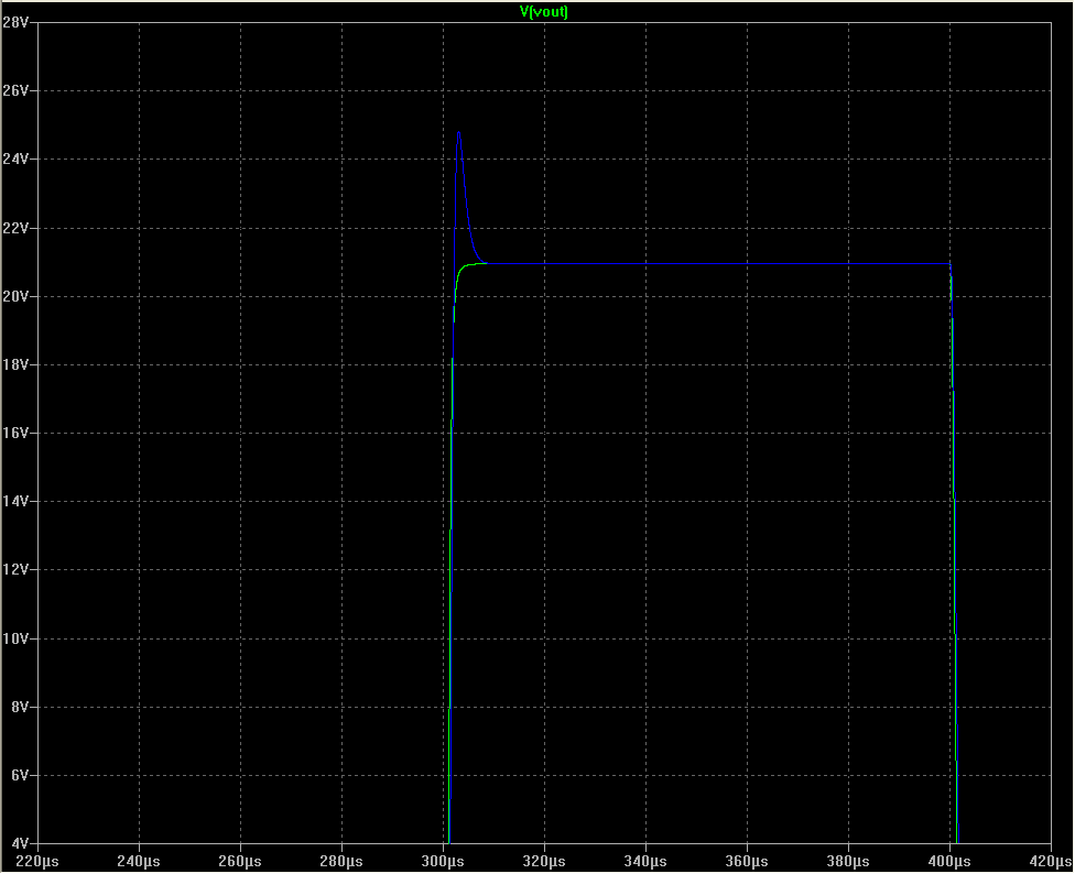

zobel_2_plot.pngIn this second series, I added a cap and resistor after the coil as well. I fiddled with the values a bit compared to Andrew's spread sheet, and got the following plots. Adding the cap and resistor after the coil clearly helped along with reducing the resistor value parallel to the coil. Obviously your results will vary...
p.s. I think I changed the cap load values to 100nf and 470nf for this run, so, the 100nf show no ringing and the 470nf has a bit of ringing.
