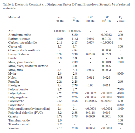

If construction quality is not taken into account, perhaps polystyrene is the best, but to really get that good the cap MUST be constructed well. Usually they aren't. That is my understanding at least.
Conrad Hoffman has made some interesting tests using a bridge on a variety of caps, available at his site. I'm not sure I would trust styrene caps too much. One of the ones I have has loose leads which can be pulled right out and inserted back again. Others have tears in the outer film, exposing the foil. If you are serious, I think you would have to test them yourself.
There are silver mica SMD caps on Mouser, even Teflon caps from 1pF-9pF.
- keantoken
this might help choose capacitors...doesn't say how it sounds though!
I have never seen such low DF on a datasheet. Usually low-loss caps will specify DF in the datasheet. I've only seen as low as .03% for the Evox Rifa PFR series. So it seems to me that construction may matter more than the dielectric itself, at least as far as DF is concerned.
- keantoken
Hmm..must try those Vaseline caps one day!
It's puzzling though, what the bonding methods for mica dielectrics there actually refer to. Perhaps we can assume it ain't standard silvered mica type you're looking at there.
Actually. it should be realised that these will be lab. figures for a standard slab or volume of the material, not in cap form with all the associated series and parallel reactances, It looks at the substance in isolation.
Yes, Mike, I do. PS is good, but silver mica is better still - but expensive.

This is untrue and misleading, polistyrene has much lower DA which is a big advantage when using pole zero compensation for vas circuits to optimise phase margins and distortion. DA causes time delay errors, papers have been shown numerous times on this forum about this subject. Even good quality high voltage COG caps outperform silver mica. Sonically polistyrene sound better or on par with the other cap types that outperform silver micas which are COG, polypropelene and teflon.
