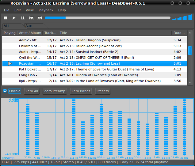

Well, I equalized my speakers using a random dynamic microphone sitting around, and this is what I got.
Guess I will have to find some thick rugs and staple them to the back of my OB to damp the LF stuff...
I found an electret sitting around, and taped a pen barrel onto the end, though I think it has some resonance issues.

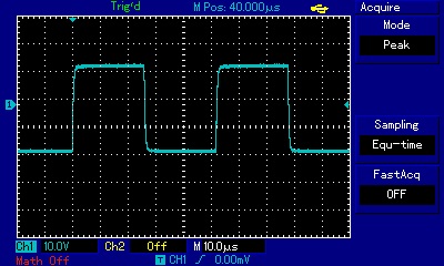

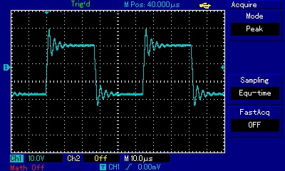

Kean,
Interesting work.
Here are the 20kHz square waves into 7R and 7R + 100nF. No compensation whatsoever.
As I said, terrible. But sounds fantastic!
I am running only 7mA in the VAS, hence the slow fall time. Also running output at 1.2A which sounds absolutely surreal.
Will get on to your other test soon.

The second mentioned load so as the curvature from second image indicates a not present serial network consists of two devices in parallel:
An inductor (air coil of approximately 10-20 windings) and a resistor.
This coil I missed also by various commercial amps, e. g. Naim Audio's NAP110, NAP160 and NAP250 (thus it is to understand, why their cable to the loudspeakers have this special look.
Speaker Cables Naim NAC A5 SPEAKER CABLE | hifix.co.uk.
Should this really be the best solution respective the royal way ??
I would say, no. The use of such a coil for prevent "ring-ring" by square-wave signal and capacitive loads is the right solution - so I think.

Ha, thanks mike.
Actually, I have tried an output inductor and it did not seem to help much. One thing I am doing is running "naim style" cables - two separate wires not joined together. It slightly improves the ringing and is a fairly benign way to add a little inductance and keep the capacitance low. I quite like my tailored solution with my specialized audio cables made of $1/5m hookup wire that sounds brilliant. I can see the marketing ploy now.
I look forward to you guys posting some square waves too. I found that the ZVP2110G and hybrid MOSFET ccs seemed far better in this regard, but this is the circuit I like the sound of most.
As I have said, with my particular circuit choice it takes ridiculous amounts of compensation to get rid of this ringing, all of which sound worse to my ears than just leaving it there.

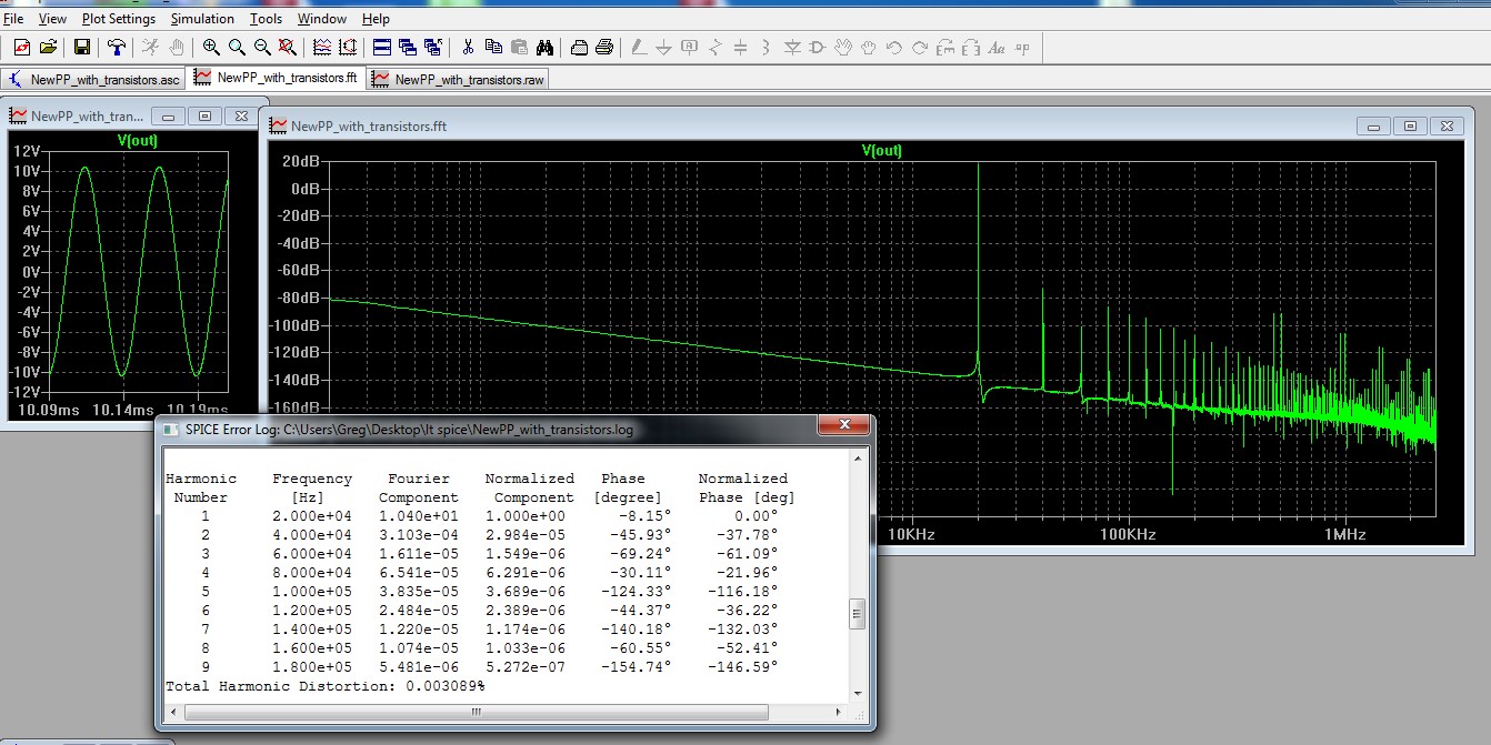

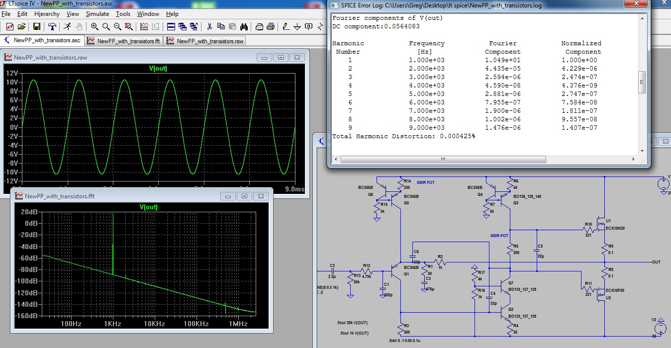

A little more complicated....
For some reason I feel the need to go more complicated and I remember mike had some good simulations by using a cascoded BJT vas.
This is where I'm heading... might be better in a new thread but I thought I would see what you guys here think first.
The cascoded VAS has very low distortion, but boy does the spectrum get messy at 20kHz. Looks good at 1kHz though, huh? Note the simulation is at 20v P-P!
20kHz
Here is the spectrum at 20Khz, 20V P-P.
Looks quite messy, though distortion is still so low it may not matter.
