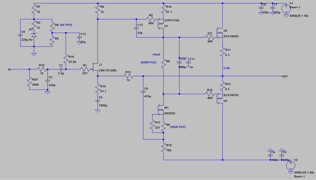

And another....
The star of this version is the ZVP2110G which Hugh and I decided was the best device available for this purpose.
Unfortunately the extra transconductance means that in my lash up the miller cap was needed for stability. I have not yet tried phase lead with this device, though it may also work.
Also, I had to make the device, which is an SMT item, fit in my current board which means the layout was messy. A proper PCB may have no such oscillation problems. Sounds great.
using post1525 schematic.I do not understand your description above.
Bias current enters R4 (1k0), down through J1, across through R13 (1k0), across to output then down through Re (speaker), finally to Ground (0V0).
Let's assume that supply is +-25Vdc, bias current is 4mAdc, Re=6r0 and output offset is set to zero by adjusting the current unbalance at the output to -4mA, i.e. the output is acting as a -4mA source or 4mA sink.
The voltage at the bottom of R4 is 21V.
The voltage at the speaker output is 6r0 * [-4mA+4mA) = 0V0 precisely.
The voltage at the left end of the NFB upper leg is 4V0.
and J1 has (21-4) 17Vds.
Now, without adjusting the output offset pot, swap a 4ohm speaker for an 8ohm speaker. The new voltage at the speaker output -12mV offset. (this is confirmed by adding a second parallel speaker to the output). One would need to adjust the pot to bring back the output offset to 0V0.

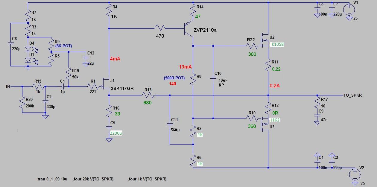

I modified one of my Fetzilla boards to the following:
Replace the input JFET with a 2SK117GR (lower gain).
Replace the VAS BJT (2SA1538) with a ZVP2110a.
Replace a few resistors to get the right bias current.
I am listening to it & surprisingly it sounds very good.
I don't have the DN2530 & the shipping charge is just too much for a small order. I will listen for a while before I replace R2 with a JFET (2SK117GR) CCS.
Cheers, Stanley
Stan,
I didn't realise you still had a BJT in the VAS. You have been shooting yourself in the foot! The FET is light years ahead for this particular application.
I would switch to the 2SK170 for the input if you can. Higher gain in the input is essential for good bass with this amp, IMO.
Oh, and the CCS is also mandatory for good bass too, even a simple LED/BJT one will do.
Glad you like the sound.

Hi Greg,
I have two Fetzilla boards, the first one is a rats-nest with the BJT VAS & I modified this version to try out the hybrid-CCS. The second one is a proper PCB with the ZVP2110a VAS and IRF610+LED as CCS. It is always good to have two boards to do incremental changes as my audio memory is short.

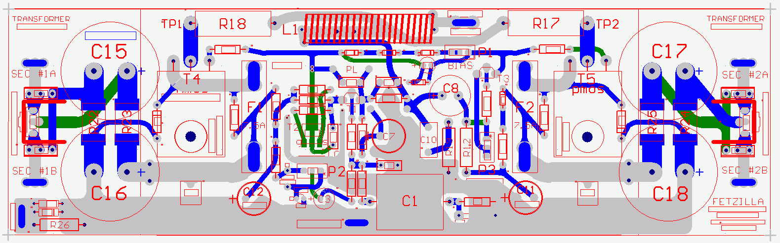

It's worth mentioning that Hugh has made a few independent changes to allow 36v rails and more power. I am happy with 25v rails and I prefer to run lower power and more bias current in the VAS and output as I can already play music louder than I care to.
Hugh's PCB is looking pretty nice and uses the ZVP2110G which has a perfect dissipation rating for this purpose and high transconductance.

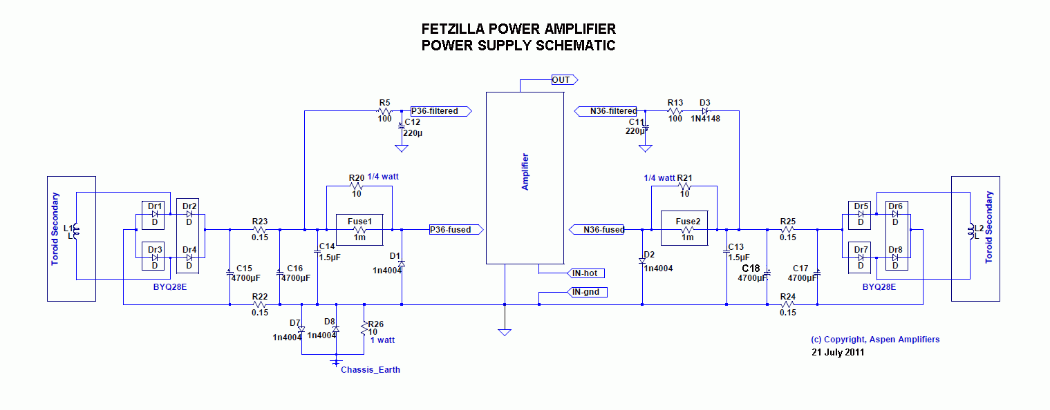

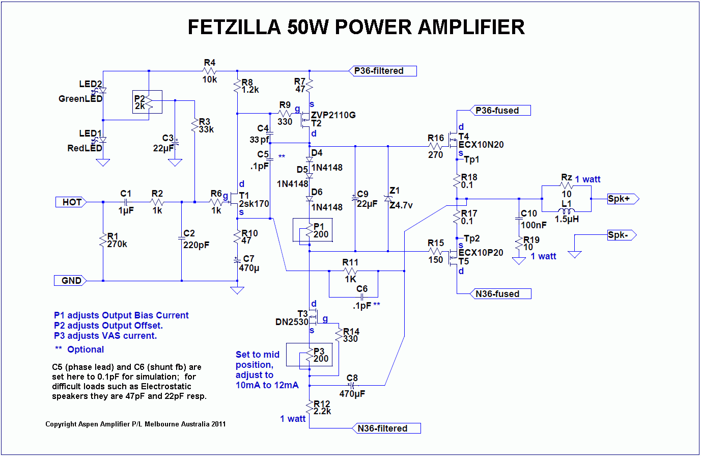

I do hope that Hugh will post his final schematic here....so that we all can share the last findings, This has been a joint project with efforts from around the globe. hope it stays like that and that we all bring forward what we have to offer..
Hey Mike,
Here are the two circuits, unchanged from earlier!!
One is amp, the other, power supply. I've also included the pcb and the parts list. These will now be the OFFICIAL project documents as they incorporate corrections made courtesy Ken and George.
Paul actually drew it up for me, but it's the circuit I've designed the pcb for. Note that BOTH schematics are actually incorporated onto the ONE pcb. Two pcbs are required for a stereo pair, of course.

KT,
See comment on schematic. Essentially, it takes them out for the simulation while keeping the symbols in the schematic for testing with a variety of values.
Hugh
