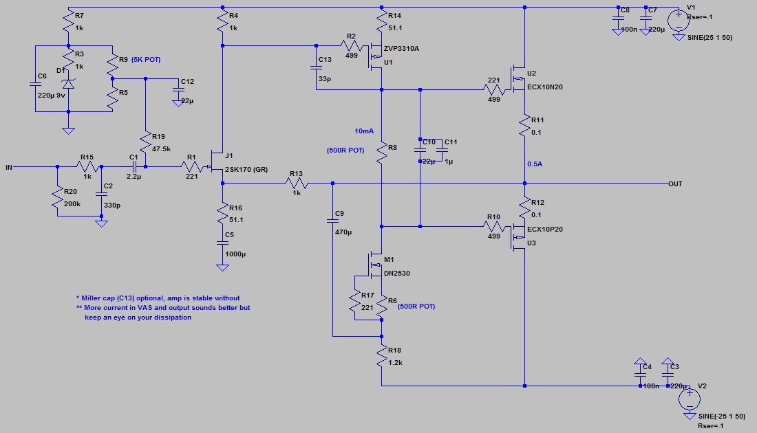

Latest Version....
Hybrid CCS courtesy of Paul Bysouth

Hey, just a thought. Now that the CCS is bootstrapped, it should have pretty even dissipation. Maybe it could be changed to a Jfet, for better performance?
Perhaps a GR grade 2SK170, with R18 being 1.8k, would give about 6-7V across it, for about 56mW of dissipation. There is plenty of room here to experiment with bootstrap values and voltages, to compromise between bootstrap and Jfet.
EDIT: I calculated this based on 8mA VAS current, but now I see in the schematic VAS current is 10mA.
I wish I had thought of this earlier.
- keantoken

Why would a jfet give better performance as a CCS than a DN2530 mosfet?
There are many circuits you come up with BTW where I think, Duh, why didn't I think of that? Not one of us can come up with everything new under the sun!!

What is the measured value of the source rheostat beneath the mosfet? I would think around 100R?
Hugh
Erm, I dunno. The Jfet has lower capacitance.
To be honest, not having much experience with FETs of any kind, I don't really understand the mechanisms which make one better than another. My guess is that the one with higher Gm at the chosen current will have better self-regulation. However this effect is totally spoiled if Early effect (or it's FET equivalent) is bad.
The bootstrap takes care of the rails, so they aren't a concern for the Jfet. Here a good device must be chosen to prevent the MOSFET gate-source voltage distortions from entering the VAS via the CCS resistance.
Would it sound better? I don't know. I suspect in this case DC regulation is what we want in the CCS, capacitive effects seem to be taken care of. But I could be wrong.

One question
Much earlier in the thread we switched to a simple resistor for setting o/p bias and now we're looking at an electrolytic across this to stabilise the voltage across this resistor . . . . I was wondering why we moved away from an amplified diode or diode chain + small variable R which I imagine would be quite good to give a defined voltage.

Hi Gaetan,
I amalgamates the surreal bootstrap vocal performance with the vastly superior bass performance of a conventional CCS quite nicely. I think it can be further improved by reducing the size of the bottom resistor.

Mike,
On the pcb I'm having made there is indeed a three diode string, with a 200R variable pot, to set the output bias. This means that the adjustment range is nicely limited, and different VAS currents can be trialled. There is even a 4.7V zener across the bias generator to limit quiescent to no more than about 2.5A in case of 'accidents'.
The Fetzilla board incorporates many options for stability. There is space for a miller cap, a phase lead cap, and a shunt cap across the series 1K fb resistor to tidy up phase shift at high frequencies. None have to be used; but the option is conveniently there. This gives tolerance for a wide variety of speaker loads, including electrostatics. It also permits tweaking for those so inclined.

SWF, Bootstrap performance will be increased by increasing the bottom resistor. However this will give less Vds for the CCS. Vds dramatically impacts CCS performance in this case. Higher is better. So there may be a tradeoff between bootstrap performance and CCS performance. Usually I go for no less than 5V.

This is the most perfect amplifier I have spiced.
It is simple but yet very, very good.
- JFET input with minimal offset problems.
- MOSFET VAS for speed and gain
- LATERAL output for be a light load to VAS
When CLass AB operation, 350mA bias, it shows only
THD 0.00018% at 1 Watt
And there is almost no increase of THD at 25 Watt output
Enjoy!! :)
