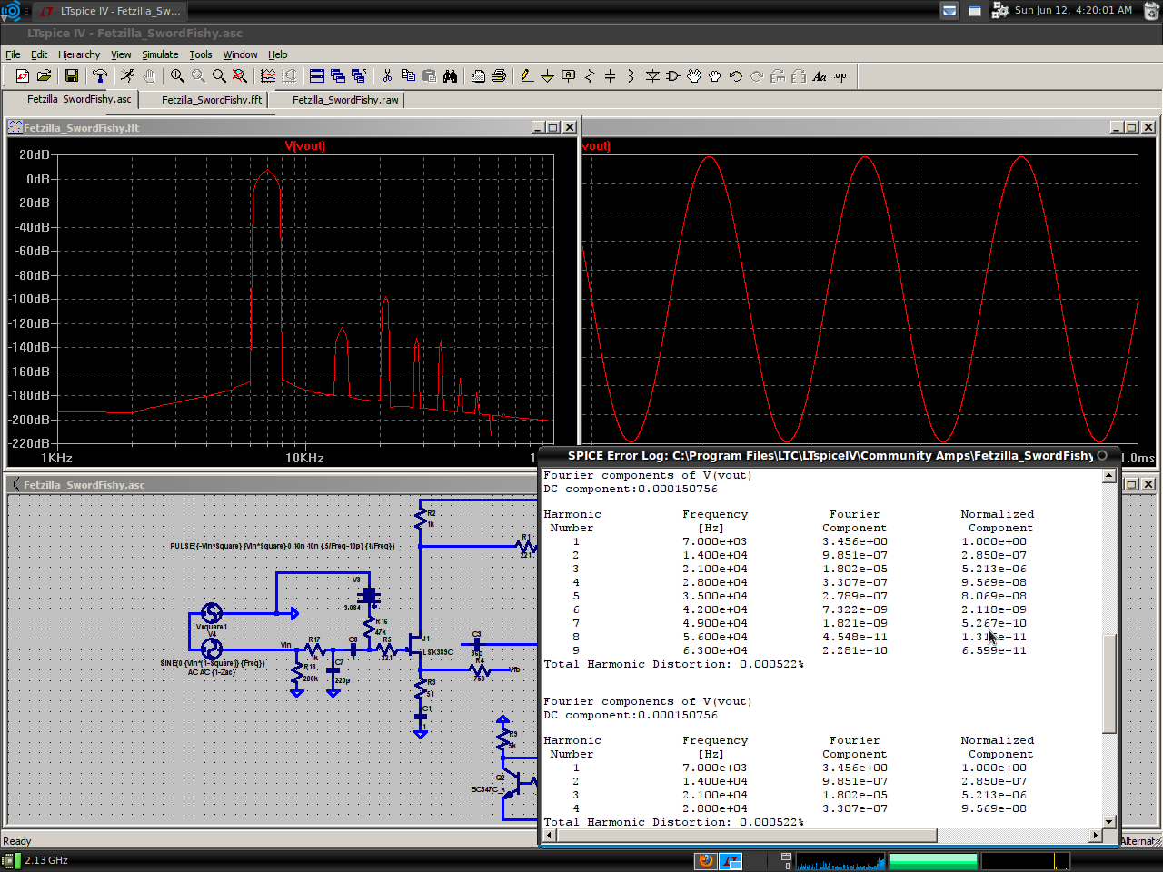

Although the harmonic profile looks less appealing, the 98% criteria is still fulfilled. Regulating the frontend removes a lot of the input stage distortion, which reveals the distortion of the output stage, which is primarily odd-harmonics but still has little high-order content.
EDIT: Attachment attached!
- keantoken
SWF, more filtering should be better. A separate supply or heavy filtering for the frontend is better. I thought at first the filter caps were resonating with something but it turns out that is not the case. In fact, if there is a problem it's that there is not enough filtering. Giving the frontend a separate supply or filtering from a capacitance multiplier will go a great way towards lowering the distortion of the amplifier without increasing OLG or adding more active devices in the signal path. It will also decrease the contribution of the filter caps to the output signal, as I mentioned before. I have attached a simulation showing THD and FFT with separate rails (with stability compensation removed).
- keantoken
Wait a sec, I made a mistake. The distortion benefit doesn't occur at 7KHz, because the vast majority of input Jfet loading is from the capacitance of the VAS and output MOSFETs. 7KHz distortion benefits little from filtering. It is distortion below 4KHz that benefits from filtering, because this is when low PSRR begins to outweigh capacitive loading as the main source of distortion.
500Hz distortion is drastically reduced. Harmonic profile is the same as in the above photo, but distortion and output impedance are both reduced by about a factor of 10.
- keantoken
- keantoken
