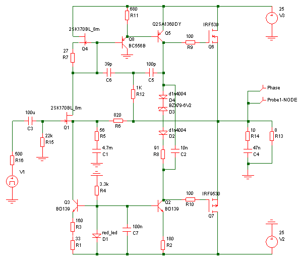

This sort of oscillation is difficult to find, SWF. I don't think it's the VAS because increasing the miller cap makes no difference. It's true there is no input filter, but instability is instability and would still be there with such a filter; it must be found and prevented.
Wahab's solution is a good one from a linearity POV but I'm leery about the sound quality. It would be a technically superb version, that is certain, and I think it would be stable but the CCS on the jfet source and drain, the EF driving the bipolar VAS and the TMC are radical departures from the original topology.
If you want to stay with the original topology, I'm thinking a 500R base stopper on Q1, the active element of the CCS for the VAS, would cure the oscillation.

If the problem is the miller cap because they do not use an RC filter at the input of the VAS?
GEirin
I think this would work, but adjustment will be more involving.
1: Set the cap to a large value (say 10uF), then lower the resistor until oscillation stops (start with a 1k resistor).
2: Lower the cap until stability begins to worsen, and then return it to a satisfactory value.
- keantoken

Anyway, I'm having a little oscillation problem on the negative half cycle. I'm thinking it might be due to the VAS CCS oscillating. The current circuit is shown below, but I have tried up to 150pF of miller capacitance to no avail. I'd be interested to know what you think might be the cause.
Did you try just going back to "slower" devices ? i.e. irf9610 &/or BD139 ?
Perhaps you did this already but I would try switching back to BD139 as a first step.
I'm going to build with the slower devices - because a 200kHz nice square wave is fast enough for me !

Anyway, need to run, but yes keantoken you are right, I forgot to update the schematic and still had the 20mA figure there from when I was running a different CCS. I am now running about 6-8mA with a LED/BJT ccs. Same kind of oscillation as before (but only with no load attached).
Keantoken, your post says feed a sig gen into the output? Am I reading this right? Do you really mean output or input?
OK, I'm about to get strangled. Gotta run.
Last thing!
I'm thinking that given that it is stable with a load attached, an output snubber (which I currently am not using), might fix things. However, it will have to be pretty solid as I almost set fire to a few 2W snubber resistors last time I was fiddling with the ZVP3310A! Seems a bit excessive.

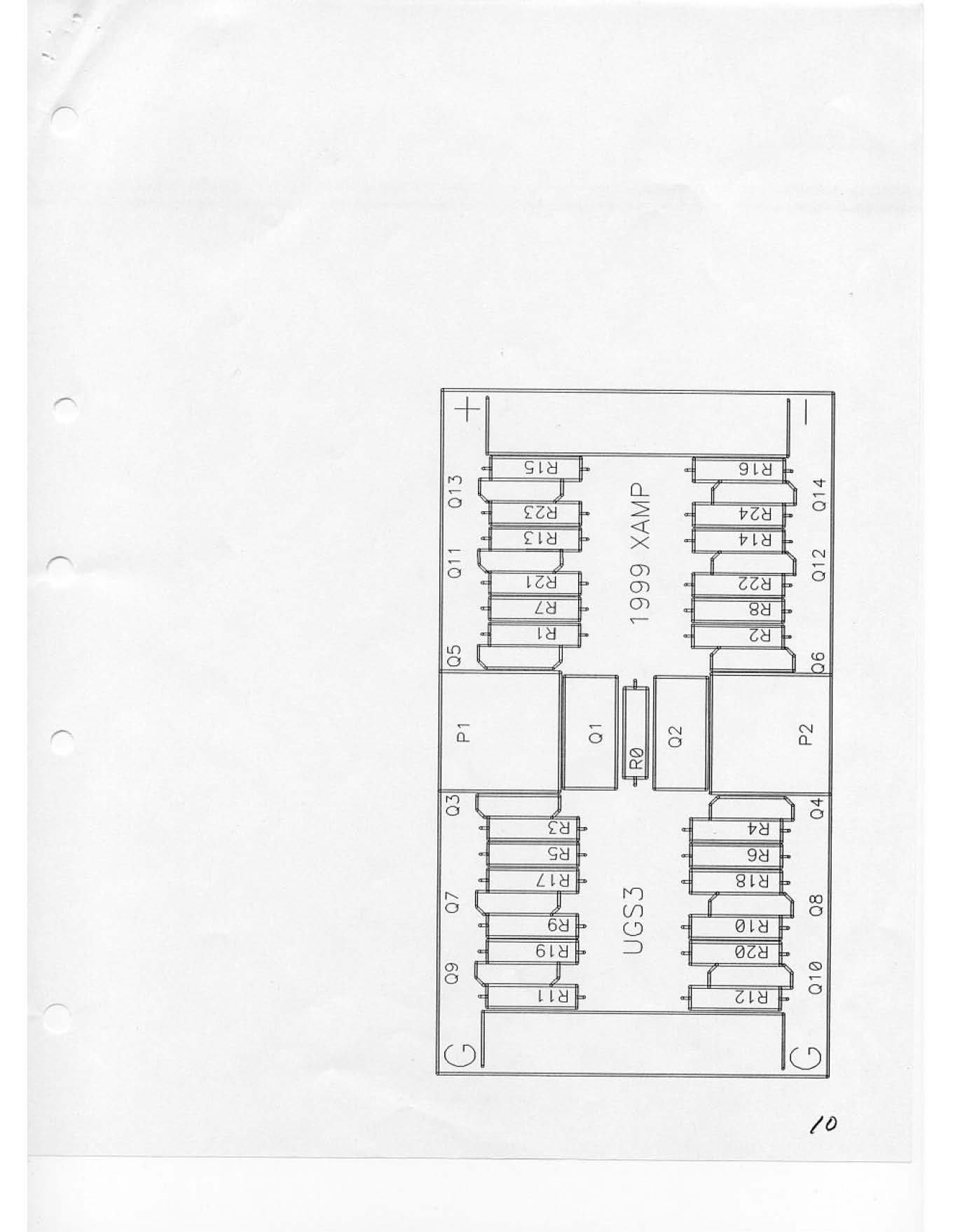

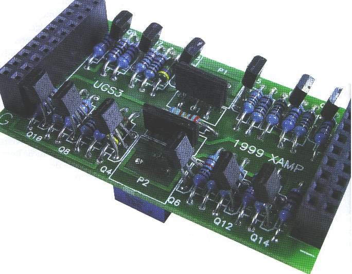

Universal Gain Stage board of the 1st generation Pass Labs X-amps.
(ZVP2110 has twice the capacitance of the ZVP3310, the UGS4 has one ZVP2110 per quadrant opposed to two ZVP3310 in the UGS3 module. Same drive for the Vertical output stage, same capacitance, better sound)
An output snubber seems right to me too. Maybe you should try carbon comp resistors here?
Another option is to add a snubber to the VAS output. Actually, isn't that effectively what you are doing when you downgrade the CCS? Is it possible that you could keep the good CCS and just insert an equivalent snubber? This is looking more and more to be the solution to me.

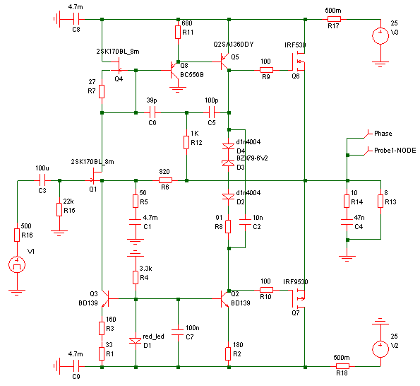

Incidentally, removing the filter caps entirely improves the harmonic profile, by increasing even harmonics. I think you should add .5R series resistance to your supplies in simulation like I did, because this changed some things. Is it possible that optimistic simulation is showing an optimistic profile?
- keantoken
It seems that there is positive feedback between the output MOSFETs and the Early effect of the Jfet. The inductance characteristic of the amplifier's output impedance may be resonating with something in the amp that is producing a capacitance multiplier effect. Or it could be something stupidly simple that I never thought of. However when the input+VAS and output stage rails are separated, the effect seems to go away.
- keantoken
I just tried 100R+1mF filters on both rails to the Jfet+VAS and it didn't work. But I just figured it out.
There is no resonance, just a convergence of three curves. The PSRR of the amp, the rail AC response, and the output impedance of the amp. Reducing the rail filtering to 39uF eliminates the dip. Alternately, increasing the filtering by a great amount will increase the amp's OLG and decrease it's output impedance by a large margin.
There is no resonance, but what I have discovered is that there is a large gain to be had from regulating the input stage rails. Distortion and output impedance decrease by a large margin. Furthermore, if the amp is left with such low PSRR, the filtering caps' characteristics will have a large influence over the final outcome.

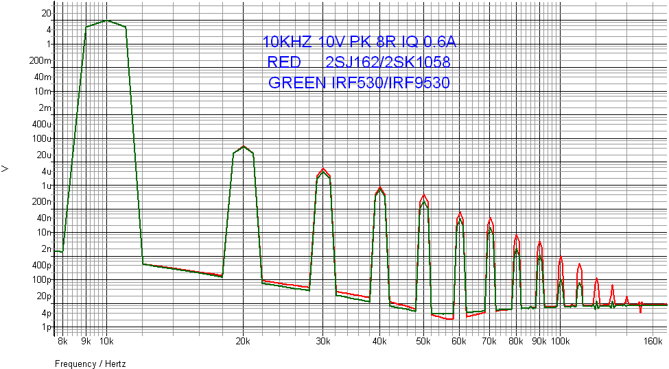

Wahab, please verify your output MOSFET models, I seem to remember those models were flawed. I think TMC should be explored only after the circuit is stable
Well , i think that the models are quite accurate enough , but who knows..
Would like to try with the models you re using since you ve got also
the Hitachi s ones.
Anyway, using any hexfets from IR will yield exactly the same results.
As for stability, it is implemented thanks to this very same TMC network
that allow robust compensation while preserving the potential linearity.
Indeed , this kind of topology is often dismissed due to its inferior
linearity, but with enhanced VAS and TMC , it can be classified
as high definition audio amp with THD residual below 100db ,
surpassing the CD noise/thd usual ratios , as should any amp
if it is to be used with such sources.

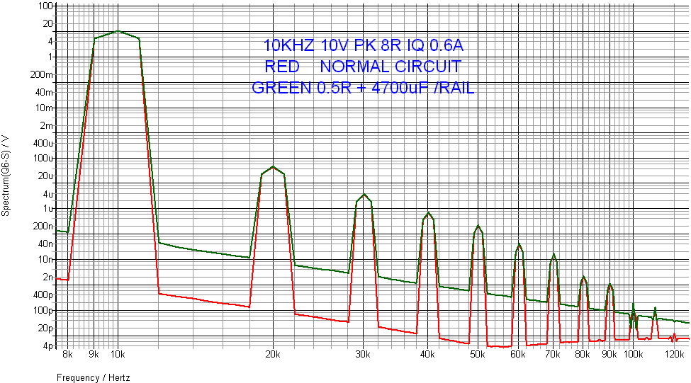

Wahab, add .5R series resistance to those 25V supplies and add however much filtering you like, and look at the specs again.
- keantoken
With 0.5R and 4700uF , the THD is exactly the same , as can be expected
due to very high OLG and the resultant PSRR that increase as well with
available loop gain.
Or are these RC circuits there to test other parameters ?
Not sure about what is to be measured.
