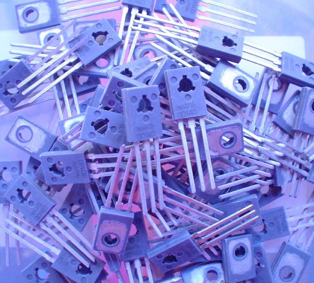

it was just a response to the claim that a BD140 is a not well regarded transistor.
A Phily-16 is a Philips BD140-16, but a totally different animal than say a Fairchild BD140.

Agree that the Phillips have seemingly way higher Ft than so called
equivalents from other manufacturers.

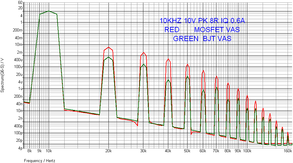

In the waiting, a comparison of mosfet and Bjt VAS versions,
using Lineup s schematic.
BJT is exponential transfer; mosfet is square law.
Distortion profiles will be different, with the mosfet having less higher order artefacts.
THD will indeed be lower for the bjt, but what there is will be more sonically objectionable.
However, if THD is your goal, Wahab is absolutely right.

BTW Stanley, substituting a 1.7A mosfet for a 74A device in the VAS position is fraught with issues, mostly to do with the huge gate capacitance which will slow the amplifier hugely, giving you appalling square waves!! Best to use the IRF9610, which has a small gate of just 170pF Ciss, easily driven by a jfet at 4mA.

If you want to talk simulated figures, as some do, the circuit actually simulates better with a mosfet VAS. Not that that means anything, right?

In spice, with the combination of Jfet i/p and BJT VAS - bd140, this amp only had OLG of 70dB - 26dB CLG = 45dB FB - not very much
An identical circuit the irf9610 as VAS gave an OLG of well over 100dB and it rolls off nicely so this amp a can operate without any compensation with a resistive load and produce a very creditable 100KHz square wave, has very low THD with a nice signature, and swordfishy says it sounds great. Good grief, what more do you want !
So for me any theoretical reasons why FET VAS don't work well are really swept away into total insignificance.
If you are desparate to use a BJT VAS a cascode with 2 BD140 ( or similar ) does work quite well and gives similar THD to the irf9610 with a nice signature with less OLG ( just under 100dB ) but, it is more complicated and needs more attention to stabilisation.

My simulations using IRF9610 are also good results.
So, I do not only recommend IRF9610 by listening impression.
I am glad you, mikelm, have found same as me: IRF9610 works very well.
