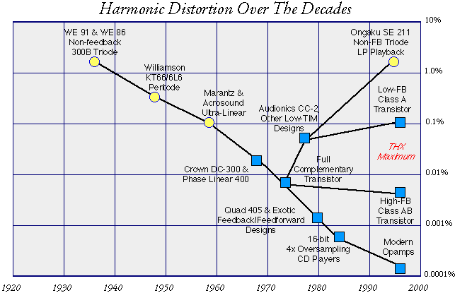

Harmonic Distortion over the Decades
Seems that the tube entiousiasts have right, some harmonics can richen the sound, special the first couple of harmonics, as you can see in the graph the distortion of modern amps is far lower but are more clinical, you now the reason is not the distortion below 5 khz, but the distortion above it, the high frequentie behavior of amplifiers is important to get good sound, the fase distortion there high in the sky where it is of much important is not plotted, just take a scope a tone generator and follw the input and output, if it go shift in high frequenties you're in trouble, I talk then between 5 khz 50 khz..
