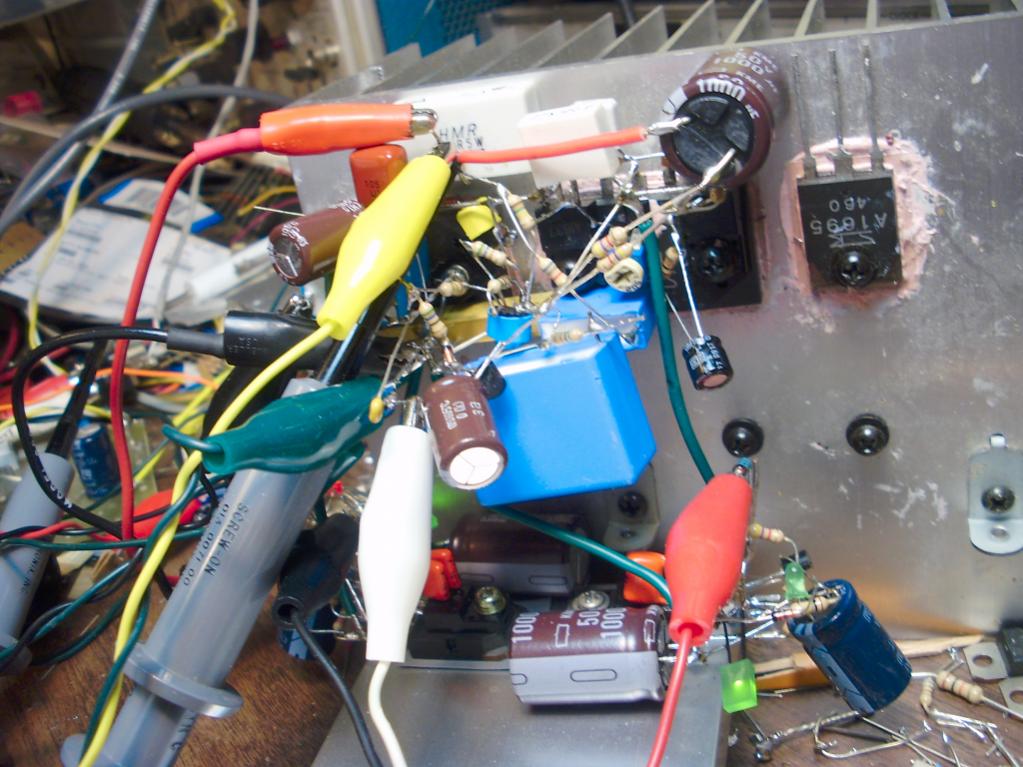

For me, Fetzilla is off the bench for the moment. It has been replaced by a BJT amp I threw together yesterday. Boy is it nice to be getting faster at this!!!
I will be working on this until further notice.
On another subject, I fried my negative K-multiplier. Once I replaced the faulty diode, I discovered after hours of frustration that the new diode had been marked with the wrong polarity. Shoot, surplus components...
The amp is built from the remains of an Onkyo integrated amp, but I suspect it would have been a nice amp if I had fixed it instead...

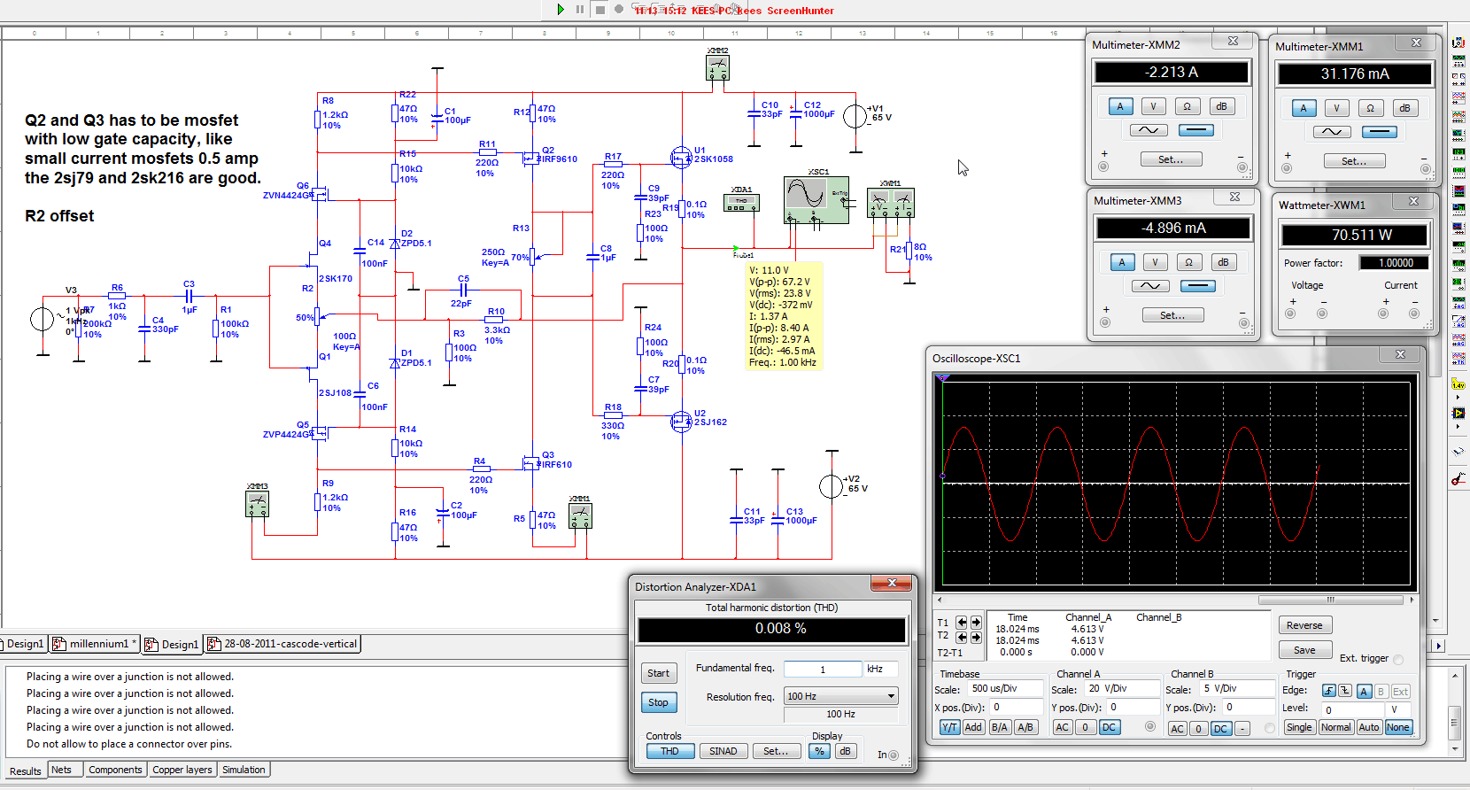

I had simulate the Borbely millennium amp a time ago.
here is the schematic, everything is close to the specs mentioned by borbely, I was curious about it but after I did go on with my own hybrid.

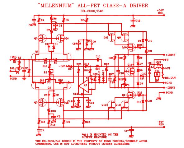

Why do you use double cascode in the IPS? I would go for JFET-MOSFET cascode and no JFET-JFET-MOSFET. First of all it will be almost not possible to source proper SK170/SJ74 with required Vgs. If you want to keep this kind of cascode better switch to sk246/sj103 or soemthing from 2nxxxx eg. 2n2457/2n2462 afair. I am planing to build something like this soon.

The schematic is a real Borbely design,, the j fets was what I had in sim to test it, the cascode is because of the high dc supply of the amp, Borbely has reasons to to it like this way I presume.

Please find Millenium documentation attached:
There is simple cascode

I have not build it yet, but simulate, the reason Borbely did double the fets was because of a lower input capacity, so I think that make it single like yours have not much impact if the source can drive low impedance.
This one I have done with the idea high supply voltage and more power with low distortion, with 20 khz sinus om 140 watt 4 ohm it gives 0.035 THD in simulation.
It is complete balanced so matching is needed, I have this design already here on forum but this is a little changed in the meantime.
