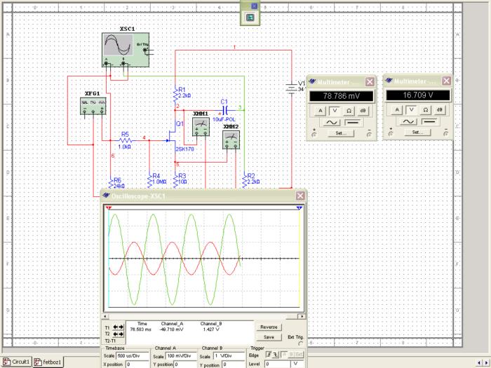

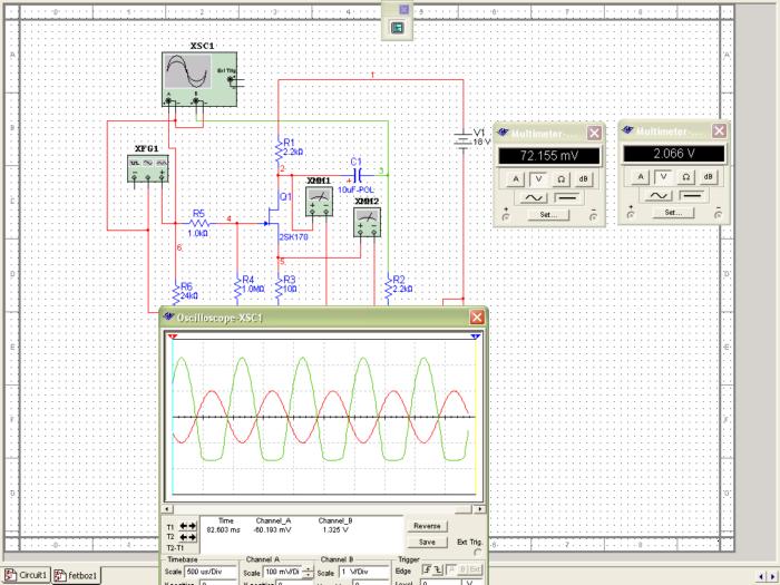

with a drain res = 2,2k psu at 18v is too low.........34v as shown in the pass schematic will fit.
here is an example - sim:
input sinus 200mv red, output = green
with 18v ........and with 34v
