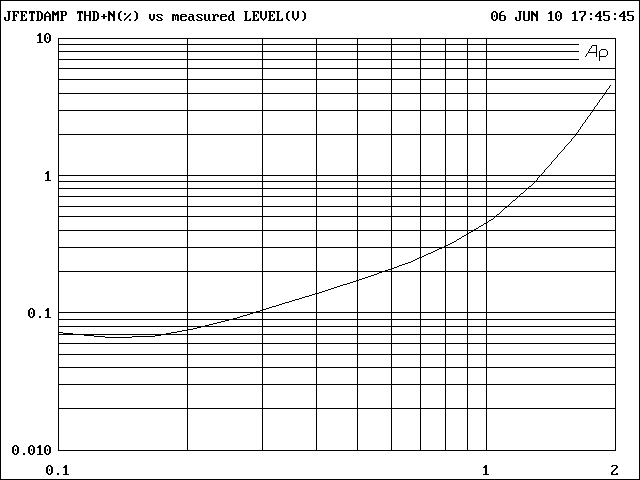

Nelson Pass said:
Since the question has come up and not answered, the
situation with the gain, bias, and resistor values is as
follows.
The device is self biased, and we want the highest value of
bias possible for lowest distortion which makes us want to
use a low value Source resistor to ground.
At the same time, it would be nice to not have too much gain
by virtue of that Source resistor value. The apparent resistance
of the JFET is about 50 ohms, so the gain into a 10 K ohm load is
about 1000 / 60 which is about 24 dB.
We can get lower gain, but the distortion will increase - it's
all a trade-off. I didn't make any effort to exactly optimize these
values - they were just thumbnail calculations.

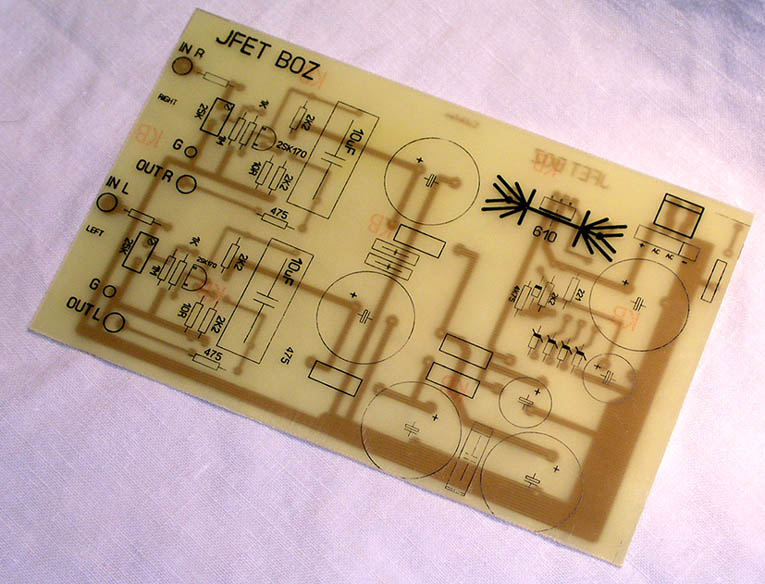

Done.
Oh I forgot drilling.
:bawling:
Manu.
