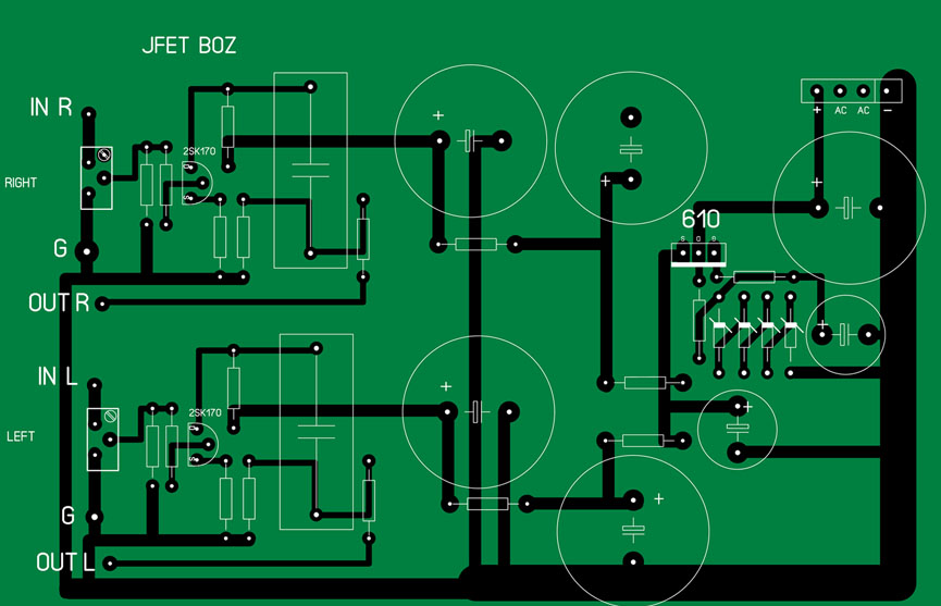

D&G reversed
I have to apologize - I have the pinout incorrect on the jfet - I thought it was GDS but it's DGS (stoopid newbie mistake
I'll revise and repost. Sorry about this
Stephen
Edit: Actually, I have the jfet facing backward as well
- reminder to self - don't get overexcited and attempt layouts late at night
Edit2: Actually, it's not that it's late at night, it's because I didn't check the datasheet first.
Stephen

Thanks for the input mpmarino - I didn't start out thinking I was going to share this layout and did it with a pair of 10uF Blackgate N caps I have that I ordered for a P1.7 (Veteran's boards) in mind.

Could this be used as a headphone amp, and would it be possible to run it at say 18V (2 9V batteries)?
I redid the layout and etched it and it is tiny
It could dethrone CMOY in terms of sound and simplicity
Here's the (hopefully) fixed layout
