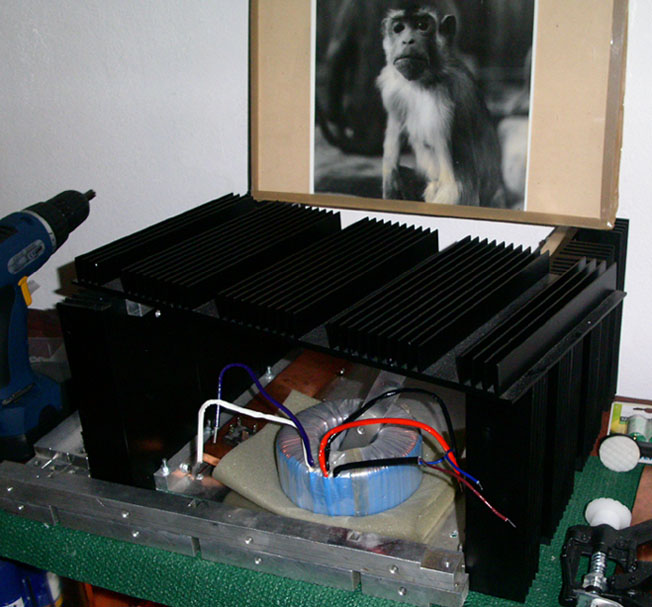

Pic of the chassis enclosed. It too big for just one stereo but could be usefull if I need a // config later

Thanks for the excellent description. If you like going to classic concerts and experience how the real thing sounds, I think its a very good thing for you to build the F4. It has the best soundstage that I ever heard. Both width and depth is tremendous. I build mine as dualmono all the way, and I suggest you do the same. To my ears a dualmono layout adds to the soundstage.

Dual mono, I agree, will be a must (but is one trafo for both channel still Ok?)

You can do it with one trafo. If each channel is running from seperate cap-banks the crosstalk will be minimal🙂

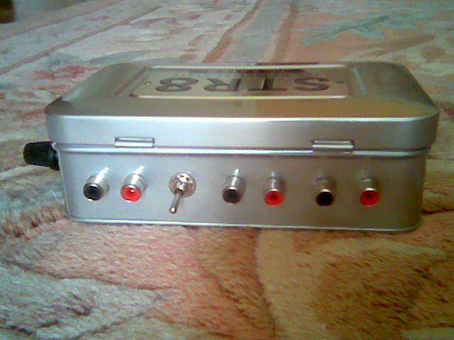

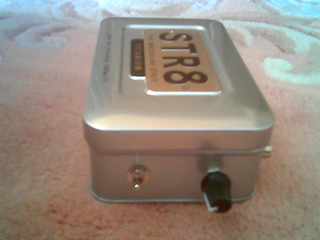

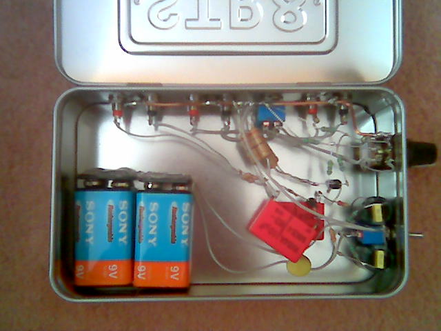

I just finished it, works excellent! It draws around 6 mA per channel. I divided the supply by putting 220 ohm resistors and then 1000 uF+100 nF capacitors. Voltage drop across these resistors is
1, 333 V. Source resistors are 2x27 ohm in parallel (somewhat bigger-I just had them in a box), other values are just as in the original schematic. I strongly encourage everyone to build this one. Looks like a toy, but...

The volume knob doesn't have a proper odour, gotta replace it 😀 That one is just temporary...

Those pics are done improperly (via phone camera). I'll borrow a decent one those days, and make shots again. I get upset when I see blurry pics. They should be at par with Jfet Boz sound: Crystal clear!

BTW : a good samaritain came along.
Vix : Very nice work. The sound is great isn't it ?
I see, I'am the only one who's happy with Rs at 22R...
manu
