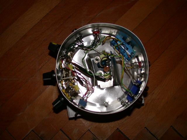

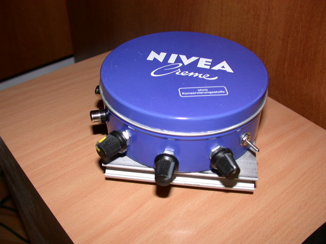

Vix said:This is what I did tonight....
Nice job Vix, and the perfect box for the job🙂 I am off to the supermarket to find a suitable cookiebox...
Thanks! It is going a bit slow, I won't have time for this till Sunday...but then I hope I won't need more than two hours to finish it
You can find various nice and unusual boxes in the supermarket. It is also funny. When I was choosing mine, I was looking for the prettiest (Choky translation: Ugliest
