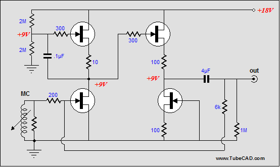

Jfet aikido
The circuit shown does not embody the Aikido principle. The filtering done by C2 means the power supply noise injected anti-phase by Q3 does not match, and therefore does not cancel. I am also sure that having an active current source to load the first gain element will sound different than a resistive source (as shown here).
I don't agree, perhaps the circuit is correct, because on R3 you have 1/2Vcc + supply ripple.
As you inject on gate of Q3 the same 1/2Vcc + supply ripple, on R3 you cancel.
Instead, I agree on an active current source to load the first gain element.
I'll simulate it.
This is my Aikido_jfet version:
http://img535.imageshack.us/img535/8338/aikidojfet1nappi84.jpg
It simulates very good.

You can use no feedback but you gain much more.
It saves Aikido principle and could sound as Tube version but I haven't try it.

Aikido JFET
I have found this schematics on Tubecad.com site. I haven´t built it, but will try simulating it.
