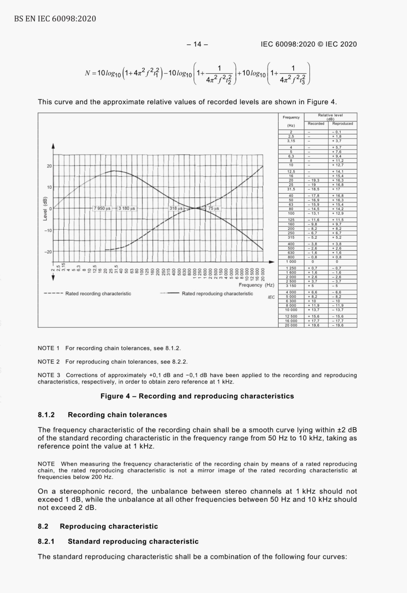

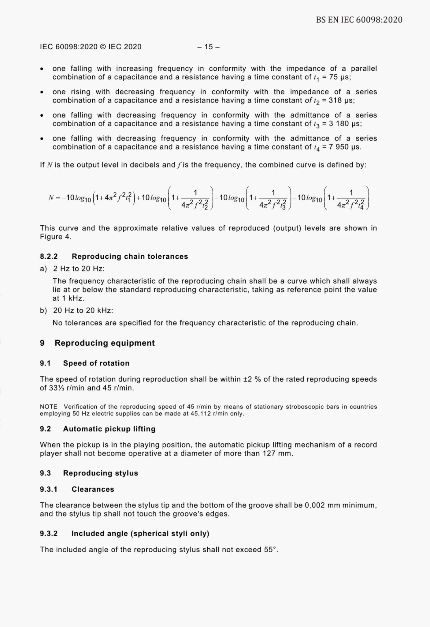

I would like to draw your attention to another part of the spectrum, namely the lower frequencies (7950 uS), which have been accepted as a mandatory part of phono preamplifiers for all CENELEC countries since 2020. See paragraph 8.2.1 of the current IEC 60098:2020 standard (attached). IMHO 7950 uS is much more important ammendment than Neumann pole.
