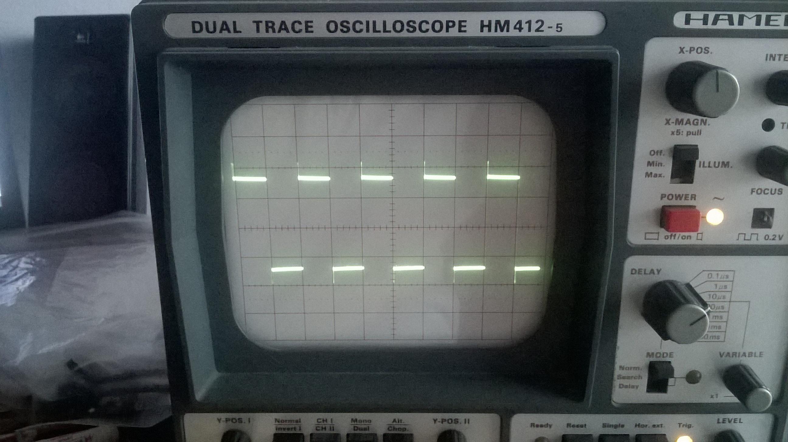

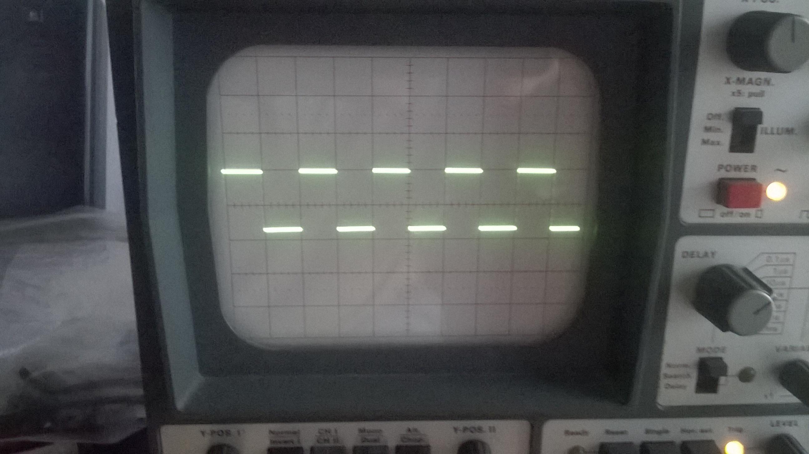

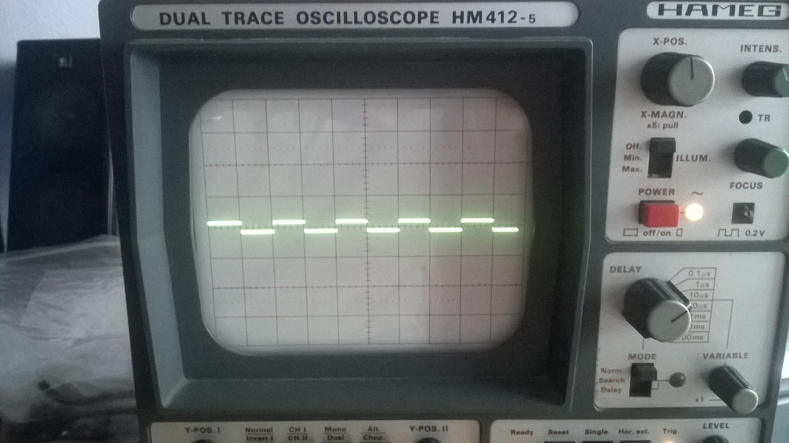

To simulate my MC of an output voltage of 0.3mV, the voltage divider to reduce the output voltage of generator of 3.3V using 14 ohms to simulate my cartridge output imepdance have to be 140 ohms in place of 100K, it's OK?
Felipe,
I used a squared BF generator very attenuated in the primary and looking for the minimal overshot-ringing at HF. The zobel for my mic trafo JK-115 (SUT use) is about a 18K + 50 pF.The final load is @ 12K and the cart reflected load @ 200 ohm.Is very different in the Jensen info.
I think is also important the Miller effect in the input grid (12ax7- 6n2p). No caps, only the 47k gid resistor . The capacity from the cables and connectors are enough.

Output voltage of what? Perhaps a drawing of exactly what your test setup is right now could clarify.

Chris,
What's the output voltage of your signal generator and what attenuation are you using?

The signal generator.
Then reduce the series resistor. Remember, it should be about 1000x the shunt. The 200k value was suitable for your higher resistance cartridge.
The scope shows an output signal aprox. of 5mVpp when the input is aprox. 1mVpp is OK for the ratio 1:10?
