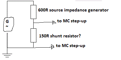

My square wave signal generator have an output impedance of 600 ohms, is possible lower to desired cartrdige DC resistance/output impedance?
Use an attenuator (which you'd want to do anyway- it won't be easy to get 0.4mV out of your generator. Series resistor with a 150R shunt, ratio of about 1000:1.
You need a resistor in series with the generator output. 100-200k will give you sufficient attenuation.

The range of values is unlikely to be correct. Morgan Jones suggests using a variable capacitor from an old radio along with a potentiometer. Tune for best square wave, measure the values, then sub in fixed value parts.
