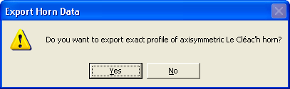

An option will however be added in the next release to allow raw data for the new profile to be exported, so that constructors can build the perfect axisymmetric Le Cléac'h horn, if so desired.
Hi Everyone,

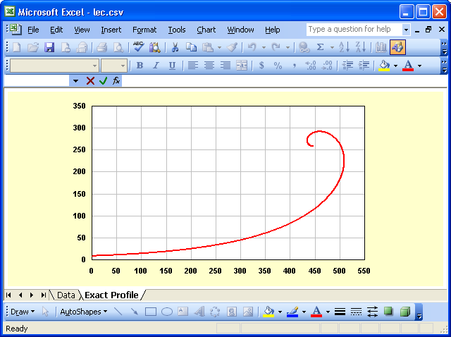

Hornresp Version 28.50 has just been released. It includes the Le Cléac'h horn "perfect axisymmetric profile" option.

Fta values are included so that the user can truncate the horn mouth at the angle they desire, usually somewhere around 180 degrees. Values up to 360 degrees are listed - see lec.txt attached.

Hi Bill,
I am particularly intrigued by your Note 3 - "For circular horns, wave front element area need not be calculated, just wave front length Rs. This approach will reduce calculation time."
Given horn cutoff frequency fc, flare parameter T, throat radius Rt, and assuming a plane wavefront at the throat (Art = 0) how is the isophase wavefront length Rs calculated at distance Ls along the horn?
Have you perhaps assumed in making your comment that the surface area of a plane circular disk of diameter CL is the same as the surface area of a convex circular disk (ie isophase wavefront) having a total convex curve length of CL? Unfortunately this is not the case.

I have made a slight refinement to the new method. It makes no practical difference to the results, but does replace an approximation with an exact solution.
Previously with the new method, the revolved surface area of the outer element of the isophase wavefront was determined by multiplying the length of the outer element circular arc by the circumference of a circle having a radius equal to the perpendicular distance from the horn axis to the MID-POINT of the outer element circular arc.
Now the revolved surface area of the outer element of the isophase wavefront is determined by multiplying the length of the outer element circular arc by the circumference of a circle having a radius equal to the perpendicular distance from the horn axis to the geometric centre or CENTROID of the outer element circular arc.
The new refinement means that the calculated revolved surface area of the outer element is now exactly correct. Previously it was just a good approximation - because the arc angle was small, the error was not significant.
The centroid of a circular arc of radius R and central angle 2 * A (radians) is located on the bisecting radius at a distance R * Sin(A) / A from the centre of the circle.
I have attached a copy of my latest code for your information. Assuming that it is not possible to directly solve for the outer element, I think that the results generated by this new code are probably as accurate as can reasonably be achieved, since all other simplifying approximations have now been removed.
