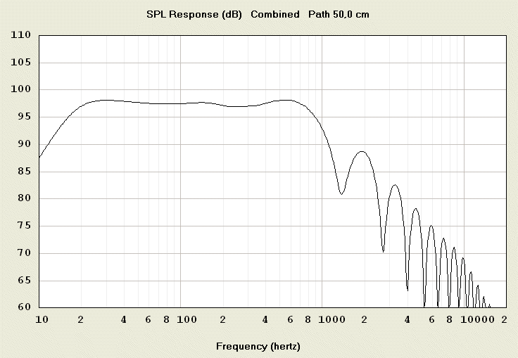

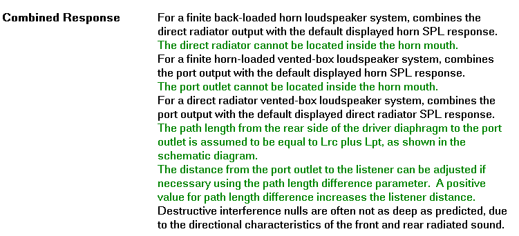

Hello Jack,
The difference of path we indicate in the "combined response" module of Hornresp is not related to the listening distance.
It is the difference of path travelled by the rear wave compared to the front wave. In the case of the Horn Open Baffle the difference of path is roughly a bit larger than the distance between the troat of the horn and the edge of its mouth + some additional.
See attached Hornresp help file related to the combines response.

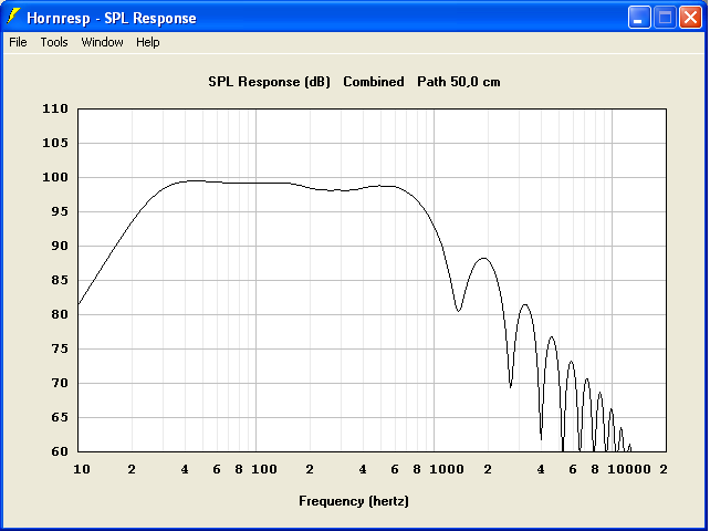

I have simulated several pro drivers and this one from STX seems good for this task? I could get better only with a large closed box. Isn't better show combined path at 2m at listening position?
This is 16Ohm woofer so Eg=4V.
Variable path length due to varying group delay of horn.
Probably off topic here but I would like to ask jmmlc whether the above is taken into account in horn response calculations. I ask because I have been modelling some front loaded horns working off an offset H baffle type open baffle and the results look good. I have used eminence beta 15A in the models as that is what I have and find difficulty in using them.
With two in an H baffle,8"or 20cm deep to the rear and a port opening equal to the H baffle cross section but .01cm deep and the front part of the H baffle about 8cm. deep but closed off to make a chamber with a throat area to the horn of 480 - 500sq.cm, mouth area 5000 - 600 sq.cm depending on profile, results look quite good. The lack of xmax shows up low down. I have modelled path difference as the length of the baffle plus the length of the horn. Is this correct.
This seems, generally to give better results than a bass reflex/horn combination. I suspect that better speakers would model quite well in this type of setup.

How do you know? You said you only ran OB. It also sims good as vented horn. Still you have to try IRL!
It also sims good with a vented backchamber with a 150Hz Tractrix down to 70Hz.

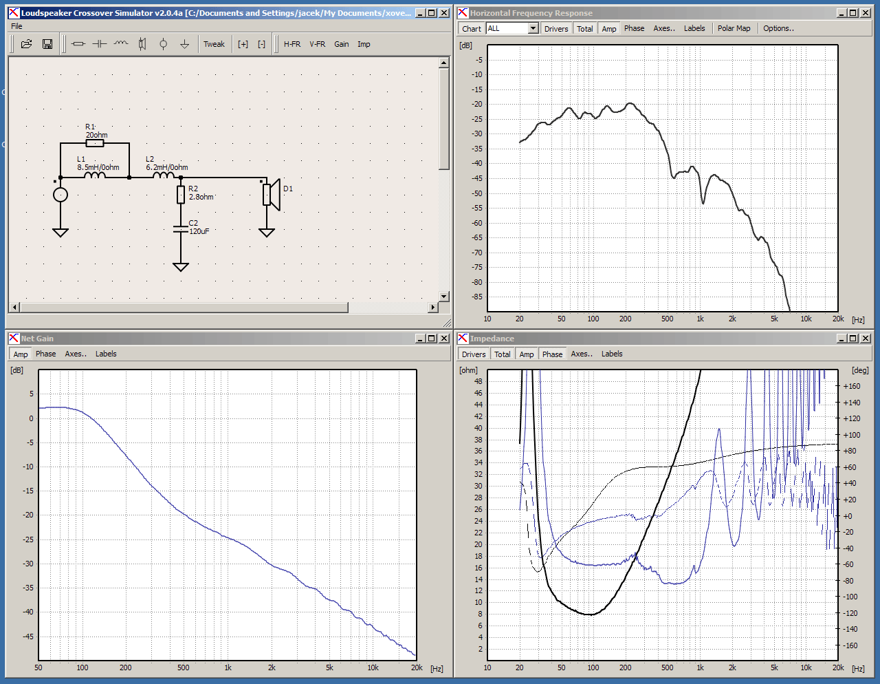

Do you? This is the 414 with 10ohm in series....
Low sensitivity though.
Better to use a coil
Hey Helmuth,
You probably missunderstood the use of the resistor. It is for making the driver get higher Q. Unfortunately you loose sensitivity so it isn´t the best of ideas.
Jack have suggested a driver giving us high sensitivity, Eminence Kappa 15A, that sims fine as OB without more than 2ohm. This is Zout of a typical 300B/2A3 SE. Will sim some more.
The reason is better impulse behavior and higher damping at resonance.For what reason? Absolutely none in my eyes! If the driver needs compensation you shouldn´t use it. Find another!
