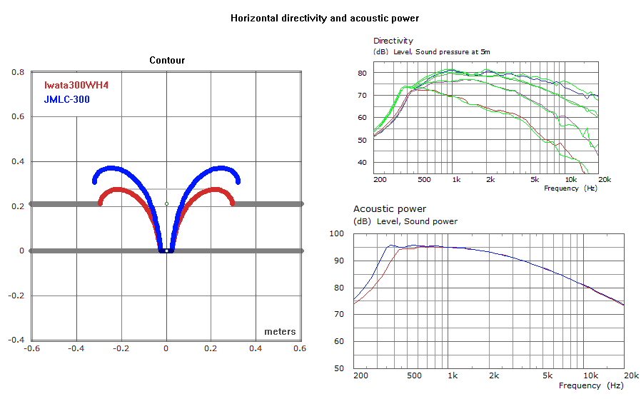

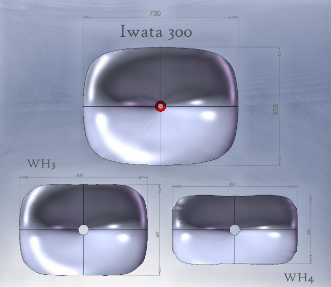

Horizontal directivity comparison between Iwata 300 WH4 and JMLC-300. Iwata flares more rapidly and I expected a wider directivity but couldn't confirm in Axidriver.
..axidriver only does conical waveguides (i.e. axis-symmetric). Iwata's don't conform to this. In fact they "trade" some of their vertical dispersion for horizontal.

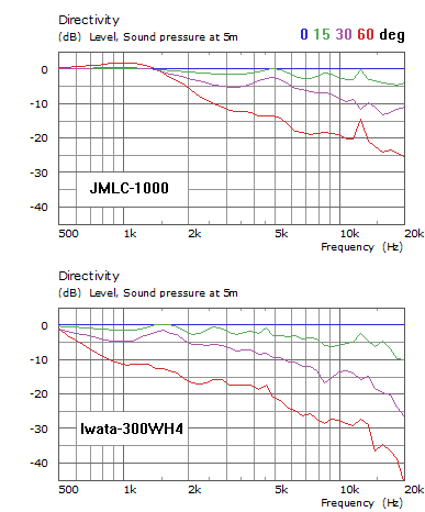

Ok. but we should see the trends. It is clear if we take JMLC-1000 and WH4. I'm interested in one plane only.
To some extent, yes..
This most recent comparison however is apples to oranges. 1000 vs. 300.
Why apples to oranges? Many ask how directive is JMLC. The answer is 8" cone but certainly not JMLC-1000.
JMLC-1000..........3.1"
Iwata-300...........18.5"
Don't you think that might make a rather large difference with respect to directivity? (..which is why I mentioned "apples to oranges" - i.e. they are dissimilar.)
Iwata is for those who want wider sweet spot and still use single driver concept. Knowing the directivity characteristic is essential. I expected something between JMLC-300 and JMLC-1000.
And you'll get that wider sweet spot *to some extent*, but it won't be displayed in axi-driver on an "apples to apples" comparison. It will however be much closer to the JMLC-300 than the JMLC-1000.

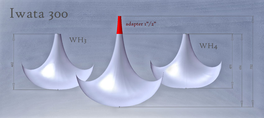

Iwata 300 collection used for simulation.
The WH4 looks more familiar to the Iwata horns I've seen, though the vertical expansion may still be a bit more.
