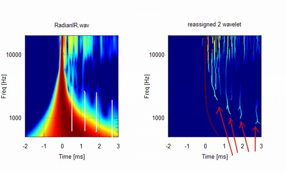

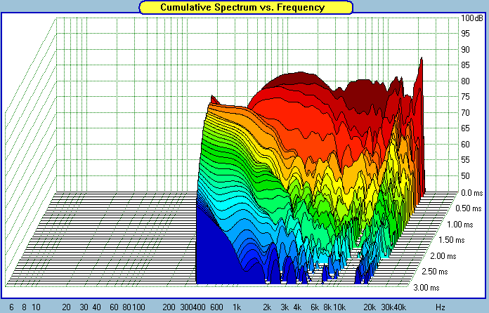

Azura425
I wonder why the new Azura425 horn measures so poorly?
http://www.diyaudio.com/forums/multi-way/100392-beyond-ariel-721.html#post2274681
Frequency Response - drivervault
First off, do not forget that wavelet analysis is quite a magnification glass - not really a tool of mercy - so no wonder wavelet analysis is banned by most audiofools.
And also don't forget that we have to distinguish what comes from the "horn" (Azurahorn in our case) and what comes form elsewhere.
Wavelet analysis does not care where the reflections are coming from - its just displayed and its our part to make some meaning out of it.
On Elias' plots we see heavy contamination on the top frequency range at short delay times. This is most likely not from the Azuahorn itself but from within the compression driver or from a mismatch between driver contour and Azurahorn contour at the joint (or more precisely: wavefront mismatch).
And finally do not forget that a (any !) horn starts out right at the diaphragm - and not at the joint of the compression driver - as most people assume!!!
This means that design of phase plug and matching to the "horn" is as crucial as the "horn" itself - at least if you are looking at the very details.
An as a PS regarding your question on extending the contour by a foam roll - I think at least regarding the department I was referring to - I see little chance for improvement from you suggestion - as the cause is elsewhere IMO
Michael
Michael
Pipe foam
The hash above 10KHz looks like a mismatch at the driver interface or just the poor performance of the driver and is easily seen in a common CSD of the GPA/Altec 288-16H on that horn as well as the wavelet transform of the Radian 745. Is the entry a little too small or is it just the drivers?
My recomendation of using pipe foam
McMaster-Carr
catalog page 3485,
is aimed at reducing the hot spots that are seen at .6ms intervals below 2KHz.The pipe foam could be a simple way to add a more complete spiral flair back to any baffle-less horn in order to reduce standing waves from the mouth termination.
Michael
