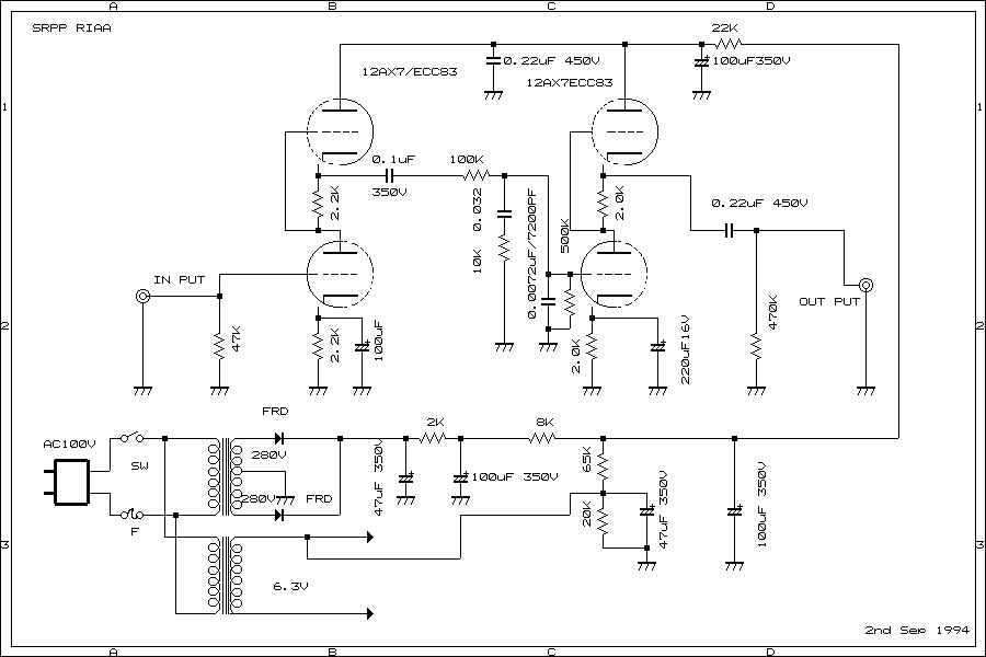

"Le tube" was single ECC83/12AX7a, both halves gain stages with passive as well as feedback RIAA correction.

I,m planning to build this phono stage. dumb question: fuse size?
You could do it with a 1 amp slow blow, if this is really what you want to build.
Ok. Thanks for your help. Is a 20 years old design, but buget wise i think is my only option now. And I think it would outperform the musical fidelity xlp.
