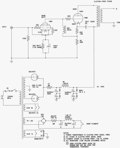

Well here is a schematic of the 7v 1.5a filament supply for a 300b.
Borrowed it off the web. It is a Electraprint design.
I have two Simpson analog meters, 0-100 microamps dc, that I would like to use in my design. Any suggestions as to how to hook them up so I can use them? Would like to use them to bias the amps.
Any way here is the pic:
