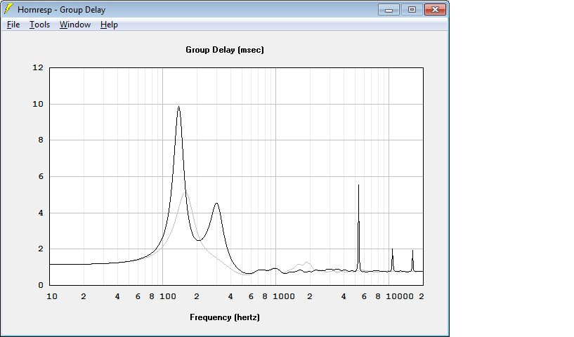

Here are a couple of Synergy bandpass group delay simulations, for the 4" driver I actually used and for a 15" that never went any further.

Hmmmm. Thought here.... In terms of phase response, a filter's order determines the rotation or group delay present, ergo the second order filter due to the bandpass chamber cannot be changed and thus the overall group delay cannot be changed, but correct me if I'm wrong, the q of the filter can be....?
Aperiodic chambers are designed to flatten the acoustic q of a system by introducing a resistive load instead of a reactive one. If the chamber in front of a driver was loaded with a resistive medium would the q of the filter not be flattened, thus increasing the bandwidth of phase rotation.
The reason I ask this is in regards to PB's comments earlier in the thread discussing group delay spikes at the acoustic filter locations. In my mind the smoothest (thus lowest q) filtering possible would produce the flattest phase response, which would be beneficial in both matching of driver's phase and overall system phase response.
Please feel free to point out any inconsistencies or mistakes in my logic, I've come a long way in understanding synergy horns but there's still far more to learn.
All makes good sense to me. 🙂
(Other than the resistive, reactive part, which I'm only just beginning to learn about)
To me, Low Q peaking or rolloffs acoustically, low order/Q IIR electrically, simply makes for flatter phase, .......which be very, very, good !
