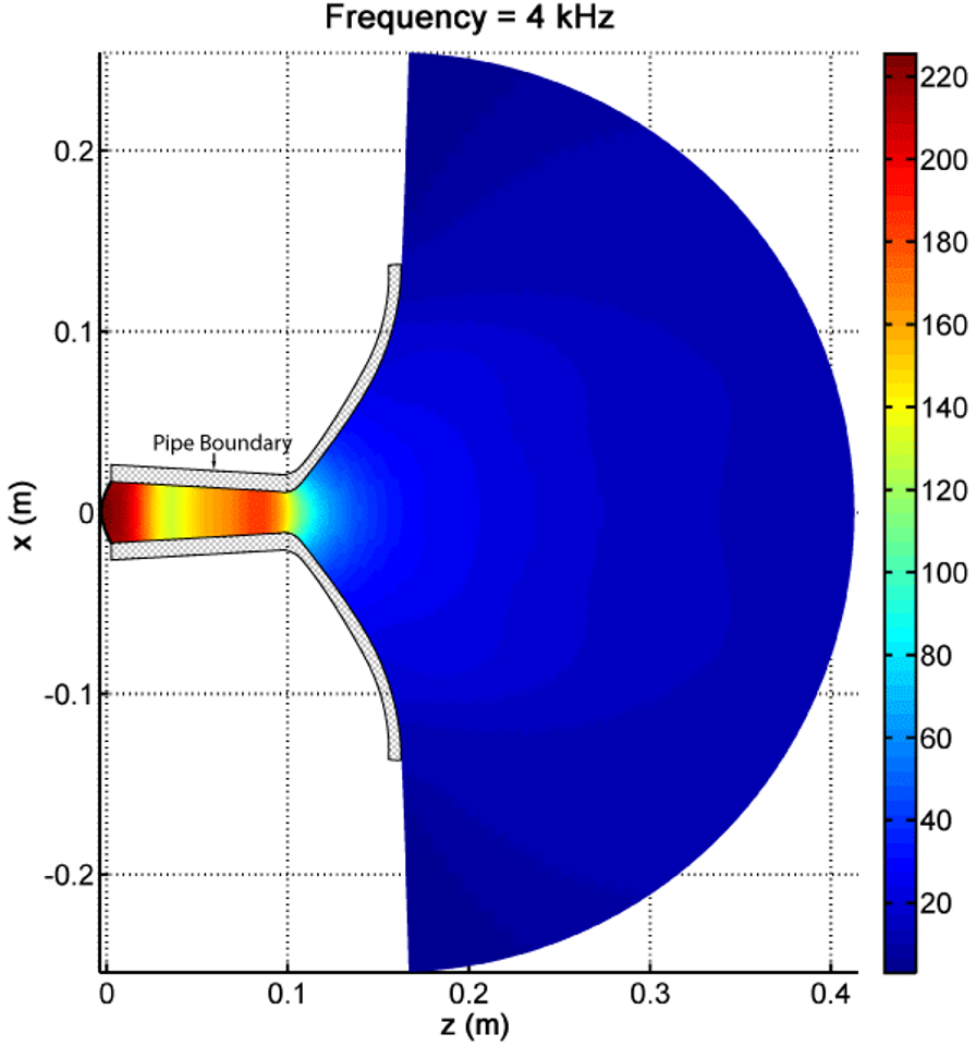

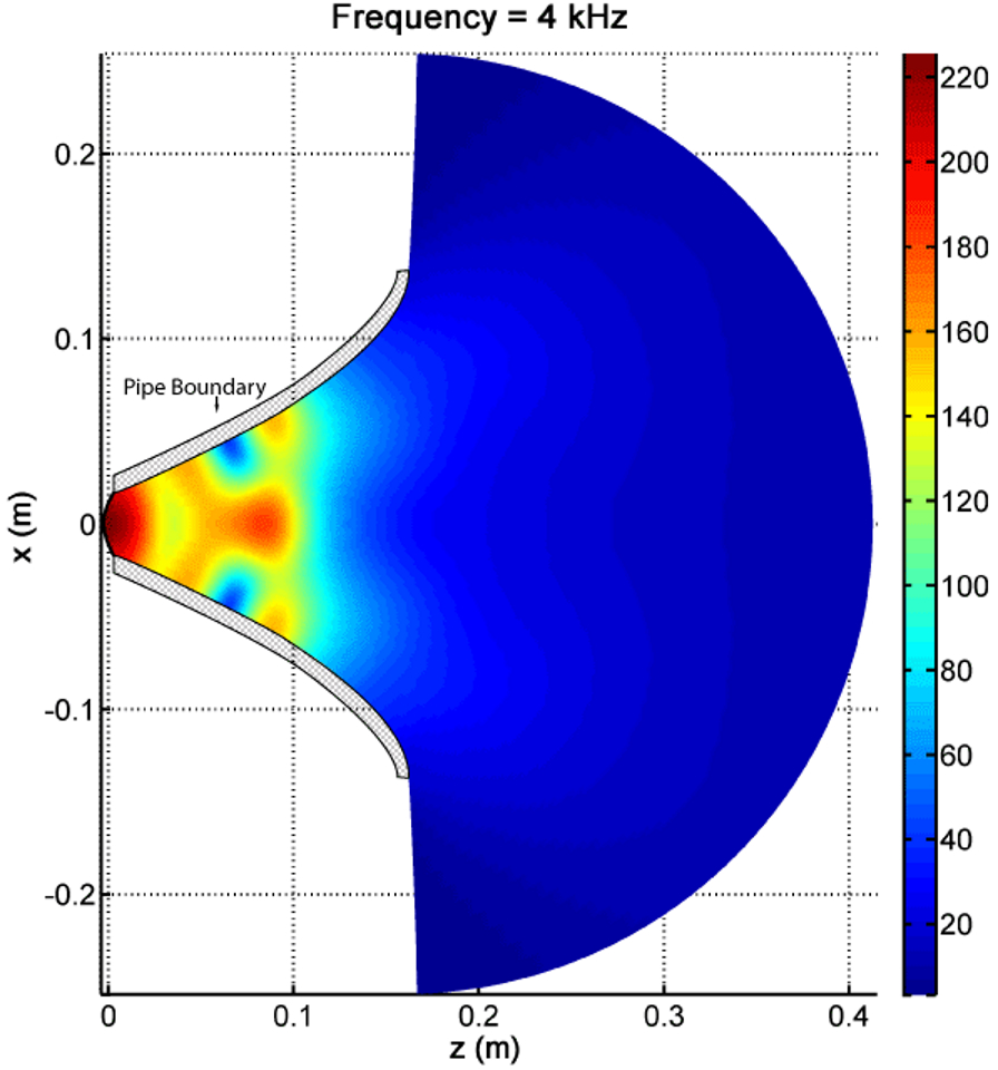

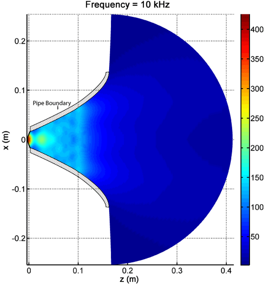

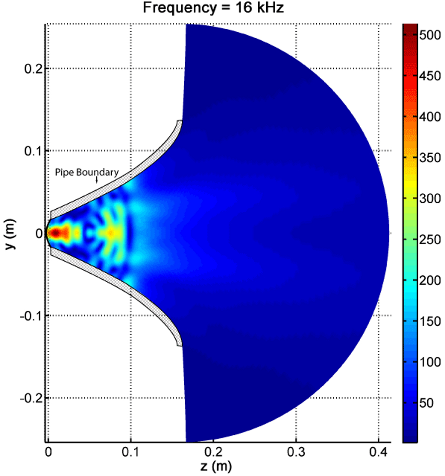

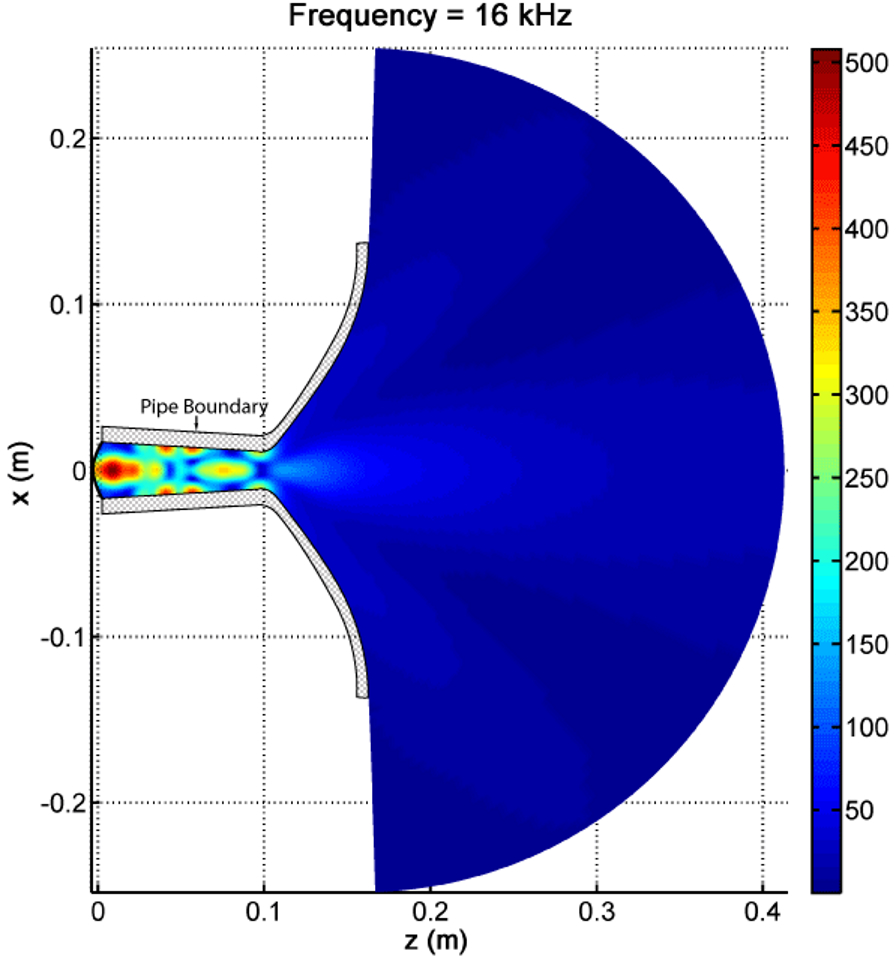

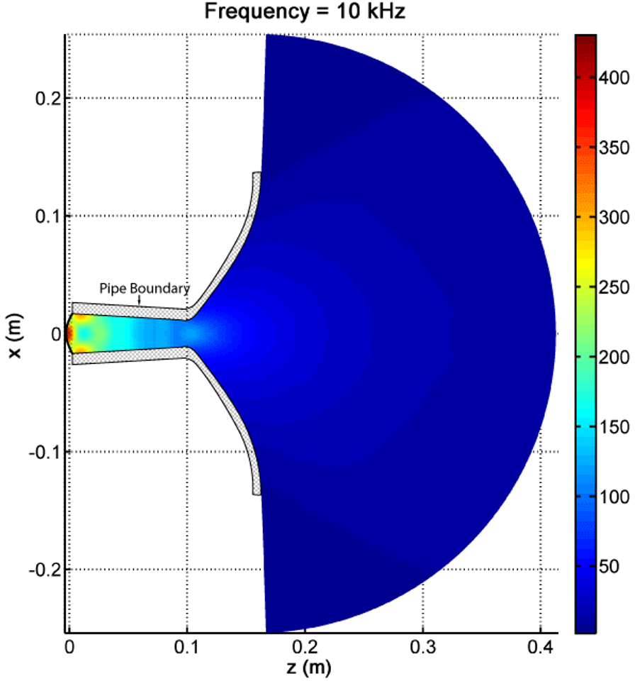

Simulation of HOMs in 120° x 60° Diffraction Horn
Below are some images of the Steady-State Analysis of a 120° x 60° diffraction horn with Simplified Excitation Signals.
This horn is similar to a JBL 2382, except for its depth: 30.48 cm (12") versus 23.495 cm (9 1/4″) for the JBL 2382.
Comment:
Although pipe modes and cutoff frequencies can be very different than those for a similar length horn, their analytical analysis is helpful as a horn can be thought of as a composition of several very small-length pipes. As the radius of the pipe gets larger, the amount of evanescence imposed on higher-order modes decreases. Thus, the amount of higher-order modal decay caused by a pipe will be larger than that caused by a horn. The figures show the magnitude of the interior pressure field for both cross sections of the 120° x 60° horn. The 120° cross section is similar to a pipe for the beginning portion of its geometry and prevalent decay of higher-order modes are observed at and below 10 kHz. In contrast, the 60° cross section opens up very quickly and higher order modes contribute much sooner. Significant amounts of higher-order modes appear to propagate much farther down the length of the horn for the 60° cross section even at 4 kHz.
As seen in the figures, higher-order modes are seen to be computationally insignificant at a frequency well below the cutoff frequency for the first higher-order mode where only the plane-wave mode contributes to far-field pressure radiation. Although higher order modes do not evanesce as much within a horn, a similar phenomenon is observed. The 120° x 60° horn agrees with the experimental measurement at higher frequencies, likely because of the pipe-like effects of the first half of its geometry, causing more rapid higher-order evanescence.
Higher-frequency disagreement may also be a manifestation of the incorrect representation of physical excitation source. The excitation source used in the BE simulations is piston like where a physical diaphragm would break up into modes, coincidentally, at frequencies around the cutoff frequency for higher-order pipe modes. As a result, when the excitation signal is well below the cutoff frequency, such that experimental measurement and numerical simulation are reduced to single-mode propagation, simulation and experiment agree. Otherwise, the simulation cannot accurately assign relative amplitude and phase to propagating pipe modes, without an accurate displacement profile for the diaphragm, which results in incorrect far-field pressure predictions for higher frequencies.
Comment:
Pressure magnitude of the interior pressure field along the 120° cross section at 4 kHz.jpg254.3 KB · Views: 271
Pressure magnitude of the interior pressure field along the 120° cross section at 10 kHz.jpg239.3 KB · Views: 268
Pressure magnitude of the interior pressure field along the 120° cross section at 16 kHz.jpg270.3 KB · Views: 274
Pressure magnitude of the interior pressure field along the 60° cross section at 4 kHz.jpg318.8 KB · Views: 263
Pressure magnitude of the interior pressure field along the 60° cross section at 10 kHz.jpg279.1 KB · Views: 171
Pressure magnitude of the interior pressure field along the 60° cross section at 16 kHz.jpg302.2 KB · Views: 172
