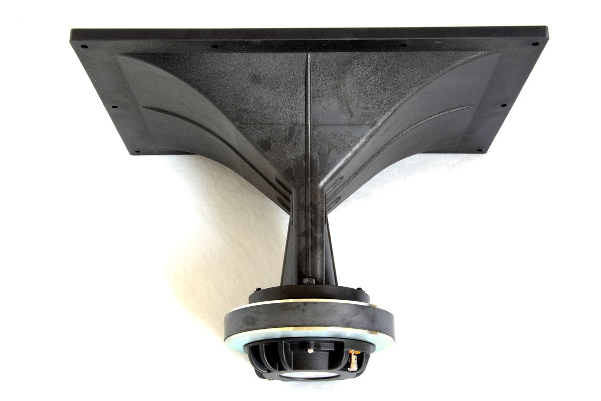

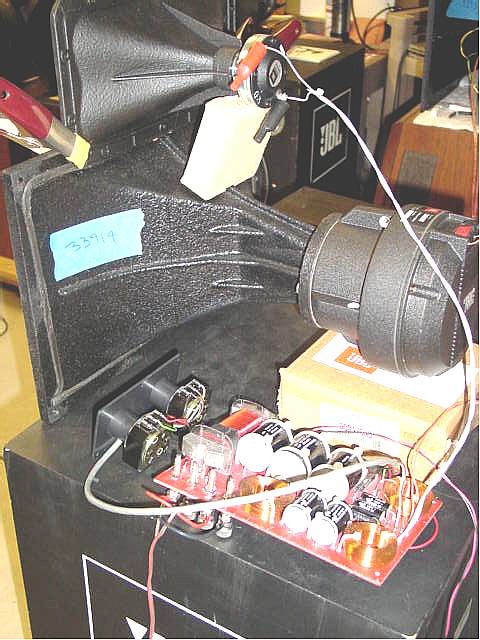

I have 2380A in stock and I can confirm what djk mentioned.

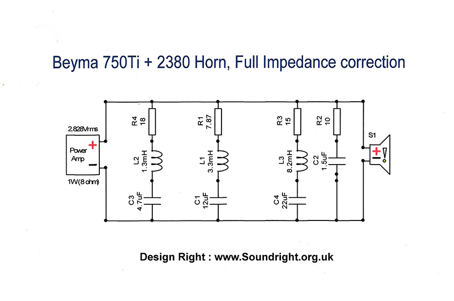

It occurred to me that the horn and driver combination will usually create complex impedance to the amplifier. Although there should be no difference in measured FR by using an impedance notch filter I have found in the past it certainly helps the "sound quality". Flat impedance ( and phase angle) will also benefit those who choose to use "esoteric" low powered single ended valve amps or even low powered transistor amps?
Although the horn cut off is indeed around 400Hz with recommend use from 500Hz this will usually fall right around the compression driver resonance for many drivers. It would be interesting to test them with the BMS coaxials with a resonance of 300Hz.
Another issue is of course the vertical directivity at this lower part of the frequency spectrum and the "old boys" would usually suggest you should use horns at twice their cut off..so 800Hz might be a good starting point?

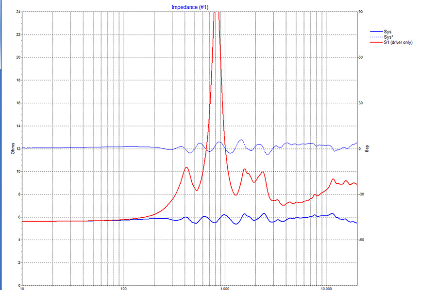

Back to resonance circuits..the DAT's software has become an integral part of my test kit and thank you Xsim for your wonderful program! I ran an impedance plot of the Beyma 750Ti + 2380a and then derived a resonance circuit to flatten the impedance.
I am attaching the Impedance plot, original impedance in Red and flattened in Blue..and the circuit (yet to be tested!)

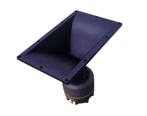

JBL launched the Optimized Aperture Horns and Low Distortion Drivers to have:
1. The phasing plug coupled directly to the horn throat.
2. Lower distortion than earlier JBL and competitive combinations.
3. JBL's traditional 100 mm (4 in) titanium diaphragm integral to the design.
4. Excellent pattern control, extending down to the crossover range.
5. Consistent on-axis frequency response, model to model.
It's all in here:

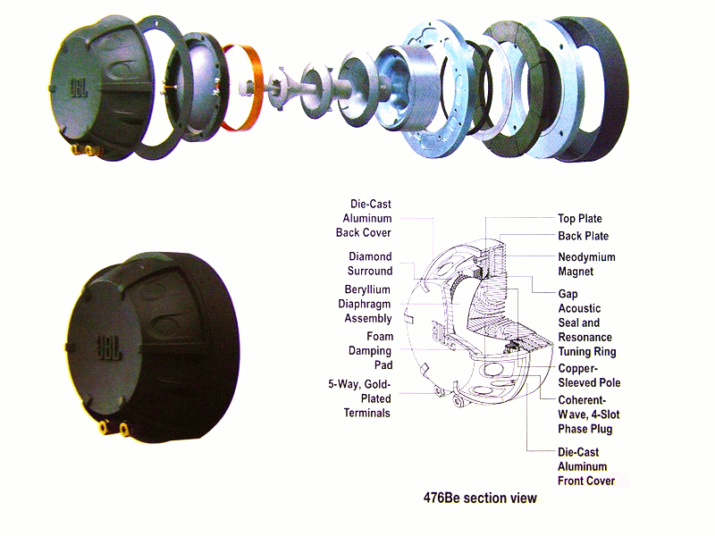

Don McRitchie in reference to the 475Nd:
"It's the same basic design as the 2450 as far as the motor and phase plug goes. The major differences are that the 476Be has no throat and uses a beryllium diaphragm with an Aquaplas coating. It shares the same "Coherent Wave" phase plug. It should be noted that the 475Nd from the M9500 uses an internal magnet structure and is thus shielded while the 2450/476Be both use an external structure. The lack of a throat means that an optimized flare rate can be chosen depending on the application. The throats on all of JBL's previous large format compression drivers used the 300hz flare rate from the original W.E. design. Since there is no need for that low a cross-over frequency for this compression driver, an optimized horn can be designed for any specific use."
Zilch:
"I recall concluding from the text description of 476Be that its design was distinguished in other ways, as well.
I can tell you that "Next Generation" 2452H-SL measures and sounds VERY different from 2450 with SL diaphragm"
Additional comments:
"Most likely due to the "throatless" design...better HF extension, less "honkey"? Reduced HF phase cancellations without the thoat."

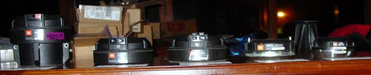

subwoof (member of LasingHeritage):
"A bit of history ( as far as I can remember )...
The first Nd driver was a combination effort:
The internally shielded 475 as used in the flagship K2
And the 2450 as used in the last gen Concert series.
There is a good article on this but cannot find it right now.
Now of course many prototypes and other applications must of been used
but this is what was generally disclosed and marketed by JBL.
During this time the new generation horn design / size ( 1.5" ) was being introduced
to address the nagging throat cancellation / HF roll off that the 2" driver/horn combo's
had. Large touring systems had a hard time meeting response, distortion and of course,
WEIGHT requirements. So Nd drivers ( then the cones ) became the new norm.

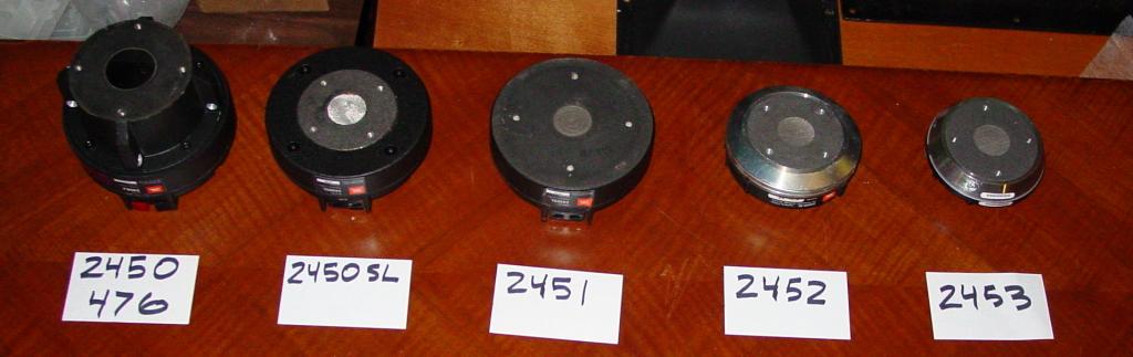

Since the 1.5 horns are essentially throat-less, and the phase plug is right at the exit,
new computer modeling allowed superior performance from all area's.
And of course keeping JBL's " continued improvement " mantra meant that each newer

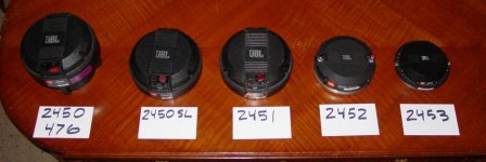

version becomes smaller, lighter and less costly to manufacture. Here are the drivers to date
( as of fall 2013 )
From left to right:
2450 2450SL 2451 2452 2453
Note the mounting hole pattern is different for the 2450SL and the 2451
- otherwise the motors are identical.

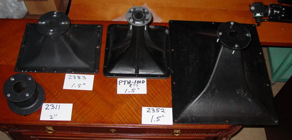

A group picture of a few 1.5" horns ( and a 2311 for ref ) shows the mounting flanges.
NOTE that since many of the newer PT horns have SMALL flanges the wider 2451
( and the sister ferrite 2447 ) cannot bolt to them HOWEVER the larger horns for the
most part can be re-drilled to accept the smaller pattern ( the 2383 is shown modded )."

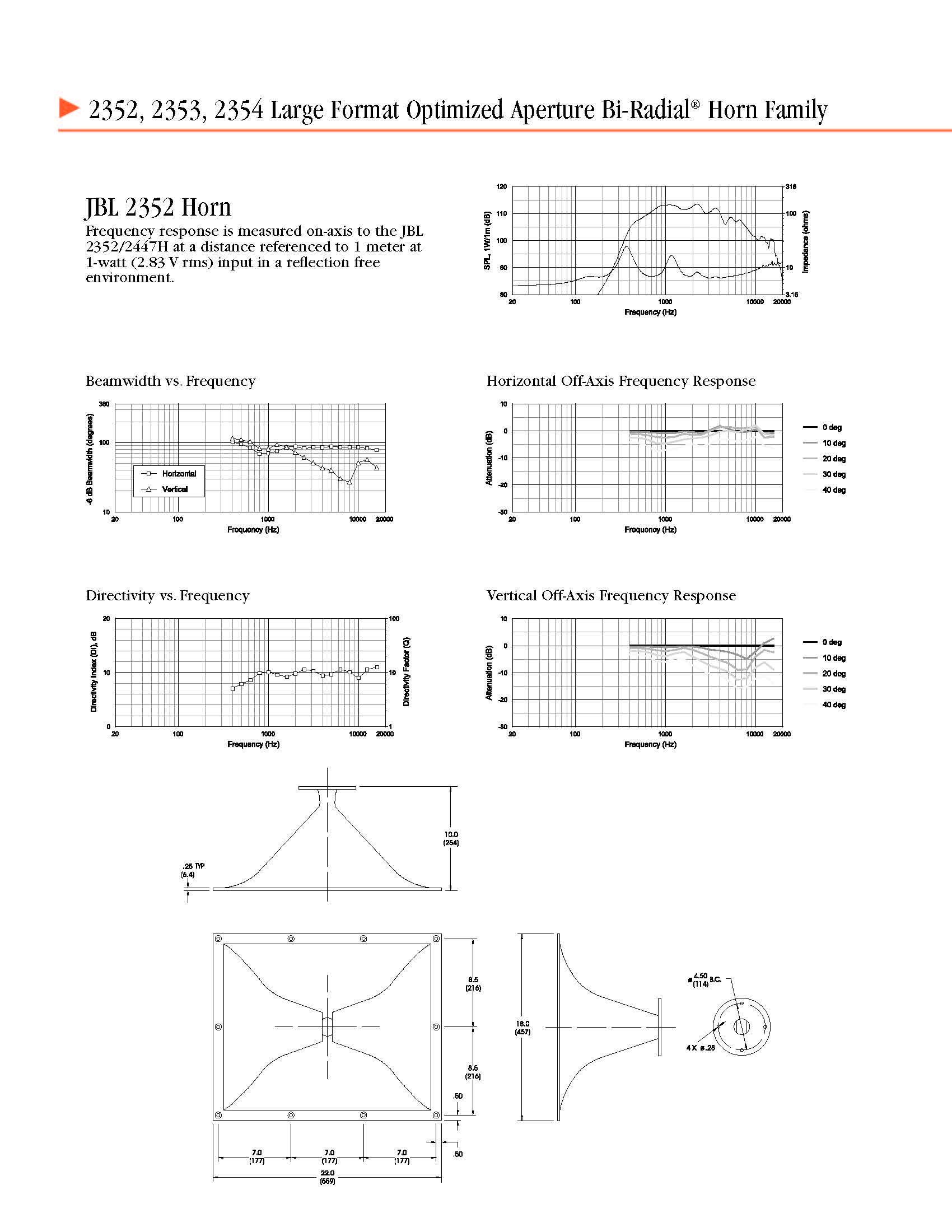

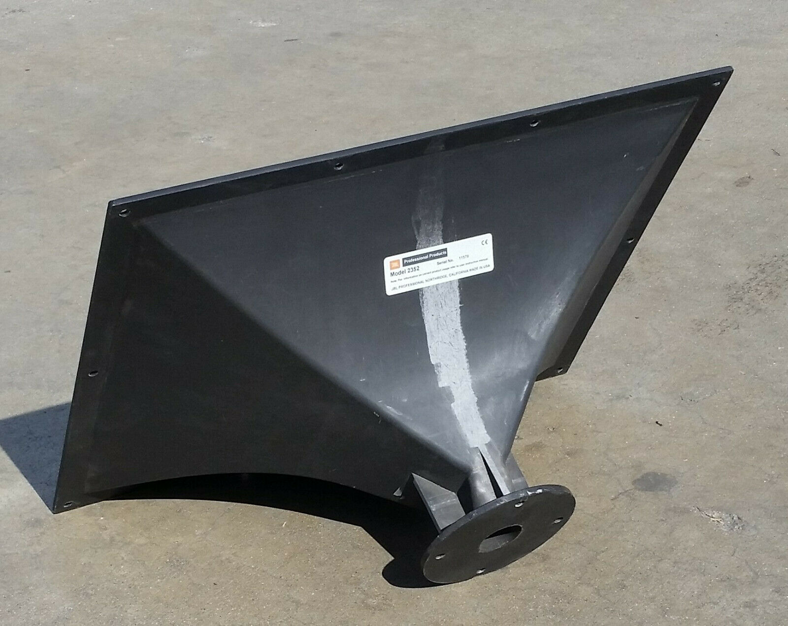

Rob, do you have experience with the 2352?
It is arguably one of the best JBL horns ever.

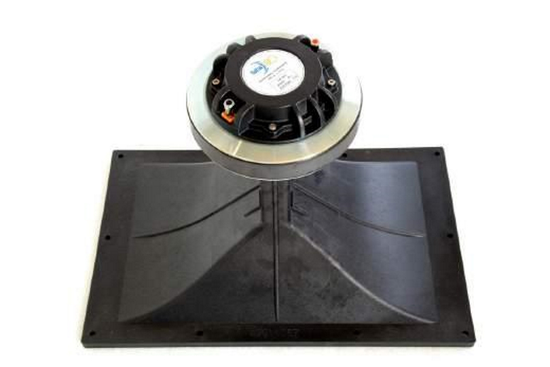

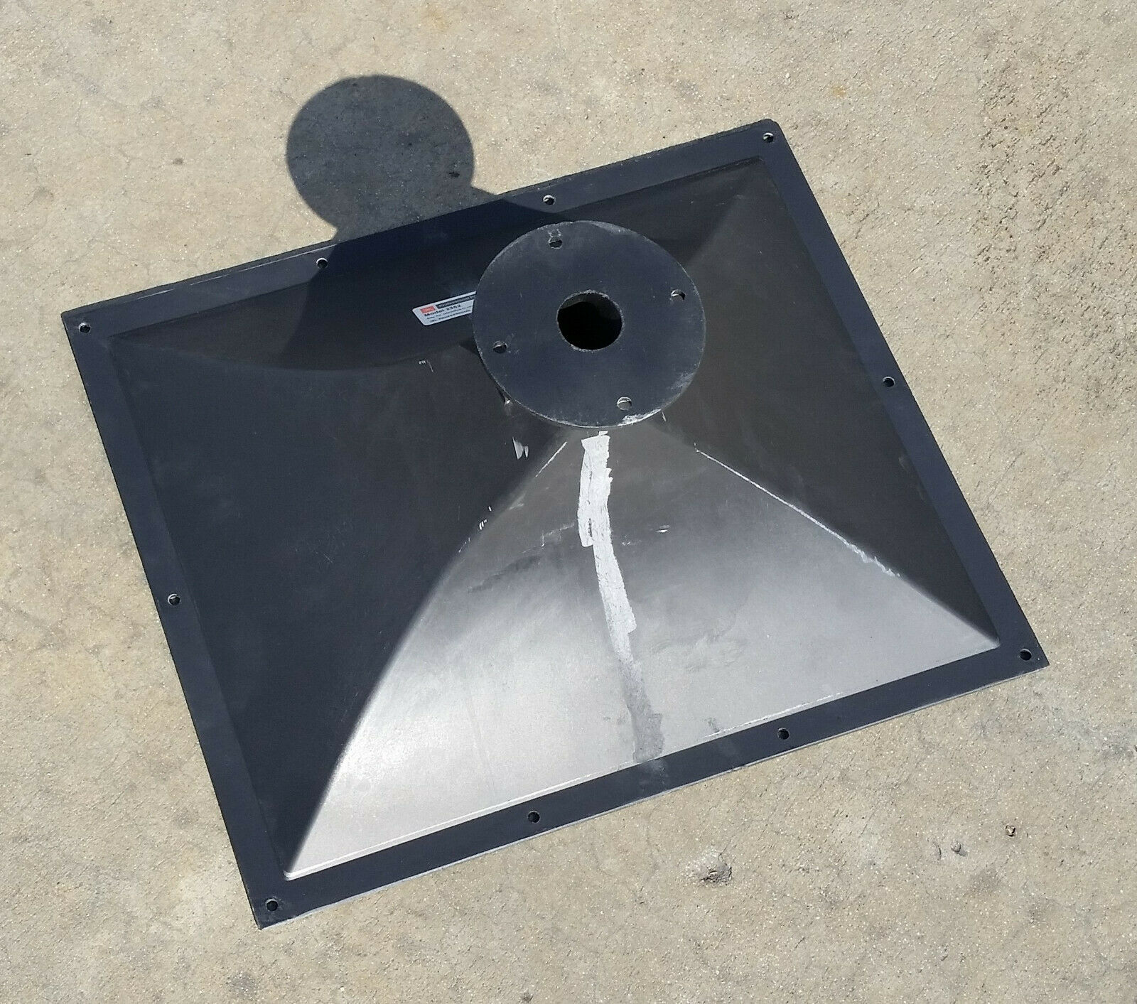

Though, these horn-driver combinations also work pretty well.
