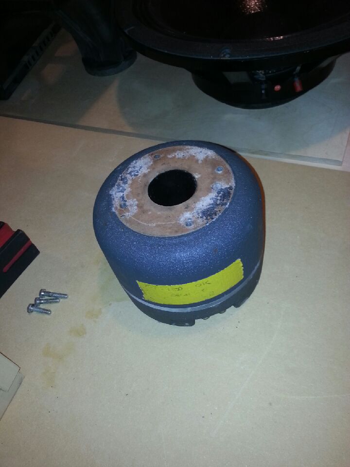

I currently have 2 pair of 2445 and one pair of either 2240 or 41..no backplate on it and the diaphragm is blown on one..

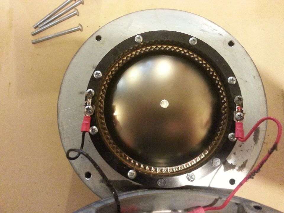

I opened up the driver and this is the diaphragm inside..
Looks like a 2441
Cleaned it up and it works. ..nice

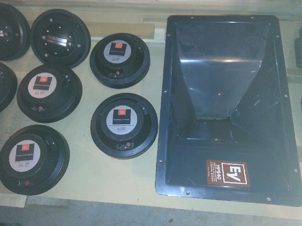

Also got 4 EV HP940 so I now have enough parts for 8 tops consisting of a 15"rcf and a JBL 2445/2246.....maybe a 2404 also

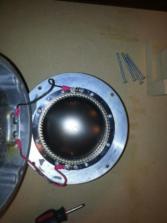

I was curious if the radian diaphragm in the 2445 would make a 2446 out of them

"I was curious if the radian diaphragm in the 2445 would make a 2446 out of them "
Of course not.
The 2446 has a smaller magnet than the 2445, a different phase plug, and the diaphragm has a pattern of stiffening ribs embrossed into it.
A 2450SL is the hot ticket (if you can't afford Be), it is a 2445 with a damping compound.
The Radian is OK, but has a big resonant peak around 16Khz.

The Radian diaphragm will make it Radianesque, not 2446.... I have a pair of Radian 1.4" drivers on RCF HF94 horns in my club system, they sound smoother (to my ear) than the JBL drivers in my friend's SRX715 tops. ....just opinion....
I've never heard their JBL replacement live, but if there's too much "air" at 16kHz, there's always EQ.
