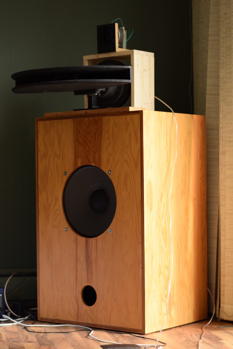

Here is my JBL speaker using 2225 driver in an 8.9 cu. ft. cabinet tuned to 30 Hz. I biamp with an analog active crossover.
The speakers are positioned in the room corners and the bass is good enough for me.
interesting, what are your cross over cut off settings ?
I have Nelson Pass' LX Mini active crossover modified for my speakers and the crossover between the bass and mid/highs is 1000 Hz. The JBL 2397 horns don't do well below about 900 Hz. I have a 2405 tweeter with a capacitor high pass at about 10 kHz.
Interestingly, the port for the cabinet is just a 4" diameter hole in the 5/8 inch plywood baffle.

Those ports look kinda small to me, both OP's and pinholer's. All of the D130's, K140's and others I've run for decades have been in 5 and 8 cubic foot cabinets, are tuned much higher for the improved efficiency, are expecting heavy equalization, and are expected to tolerate being run hard. The port areas run typically 2 to 3 times the 4 inch diameter ones you fellas are showing; they're deeper (longer), too.

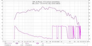

Can you post a FR and an impedance plot of that speaker? Or better three frequency response plots, one of each speaker from 1m distance and another one from the stereo pair in your listening position?
And schematics of the crossovers used so far with a note what belongs to what post about the changes.

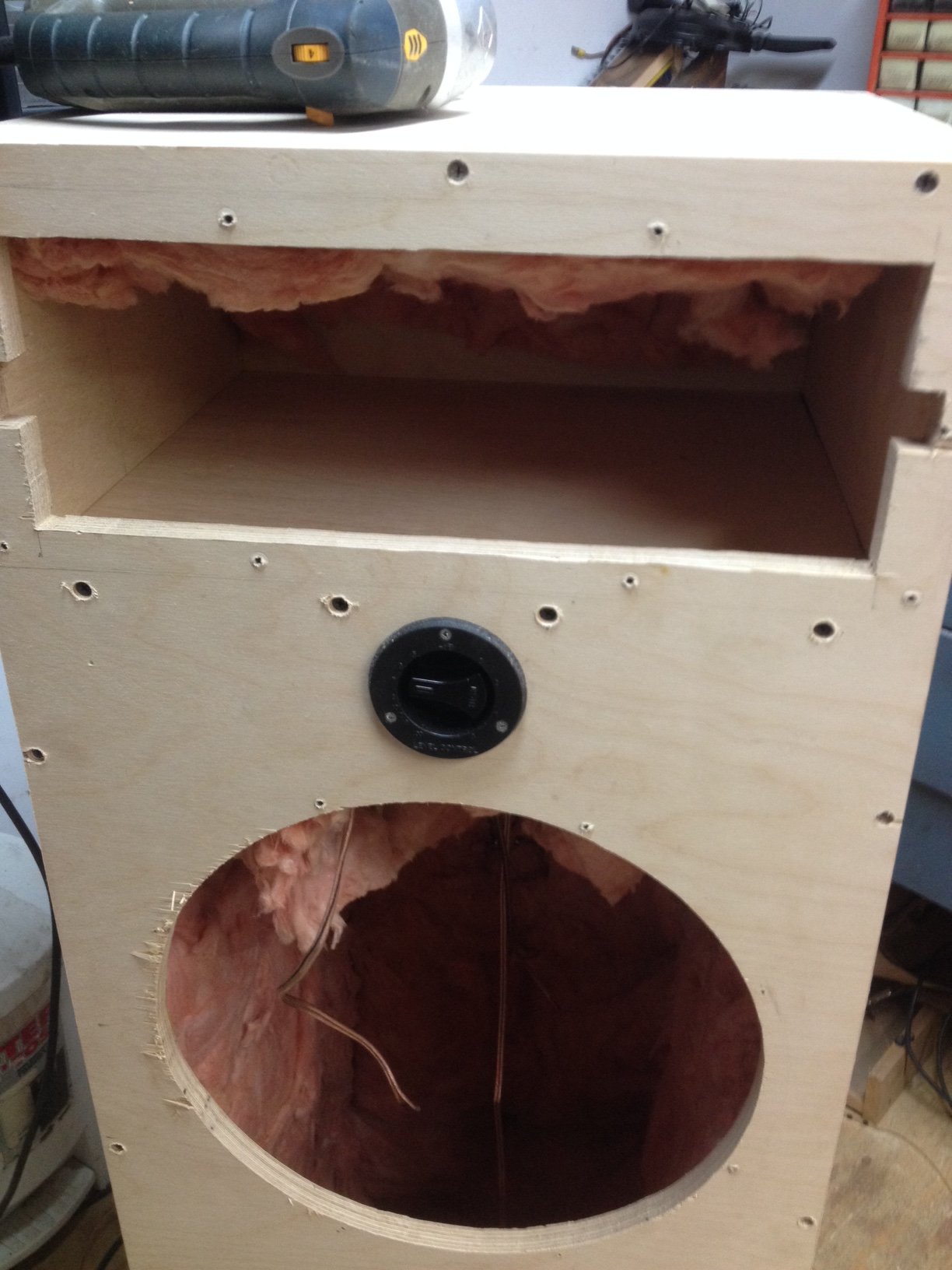

i think this 2225 has a mechanical failure in it. at very low volume the mid seems to rub against the magnet. ie, voice coil is mechanically damaged.

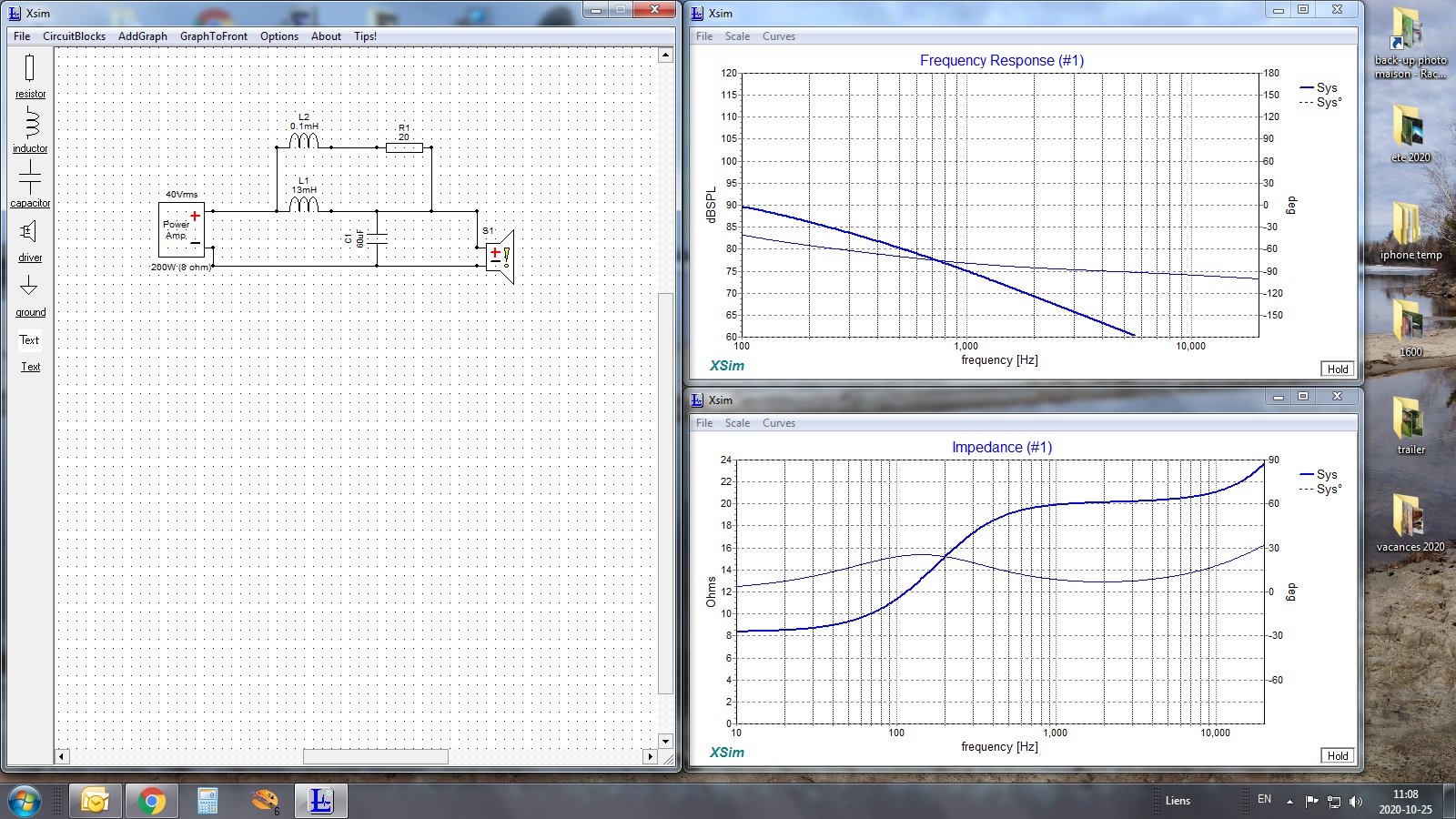

i have noticed a severe gain in the 2k-6k from the horn. so i guess the econowave compensate for this ?
i was attempting to try a notch filter, so i simulated it in lxsim.

i reduced the internal volume by enclosing the horn itself. i am at 5ft3 dead on by doing so.
i also found out that the heavy mass of the unsupported horn is probably the source of the 120hz resonance i was experiencing. dont blame me on the fiberglass wool hanging....i will get sucured#tacked back on properly once finished with this.
now in the process to reduce the port lenght to the prescribed 40hz tuning so about 1.2" long...damns thats short !
I DONT HAVE 6 inche tube in stock....loool. where in the hell can i find 6 inch tube.

6 inch diameter and 1,2 length?
Doesnt seem right to me.
I would expect more like 8x10cm BR?
Anyway good to see you try stuff but please measure your drivers free air. If the coil is hitting / scraping the gap you’re out of luck with the driver.
