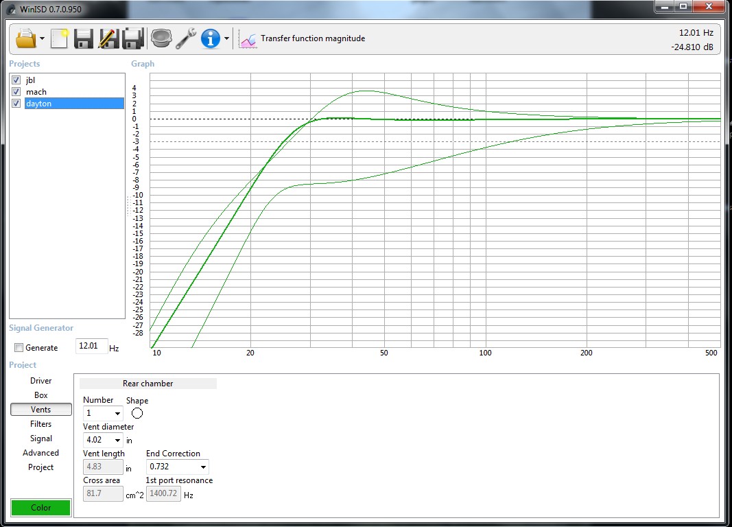

Even the product data sheet recommends 140l cabinet with 5x5 inch bass reflex tuned at 40Hz and it’s clear that the LPF should be perhaps 1st order at 200-400Hz max to have baffle step compensation in place for the smooth transition to mids. In a two-way design you would need an extremely good horn with flat response from 800 Hz.
https://jblpro.com/en/site_elements/2225h-j-information
All I was going to offer was that a 4 inch diameter port seemed pretty small to me.
Pat, if you're still here -- did you miss the suggestion regarding TWO 4 inch ports? Seems like THAT wouldn't violate your *Prime Directive* ..

i am stuck with the 4 inch port for now, at what power level will it max out ? can you tell me ?
