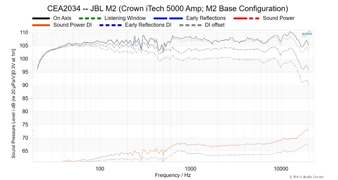

Erin detailed some roughness in the JBL M2 bass driver due to the surround 'accordian' edge. (300-600hz)
Is there a better measuring 15 inch bass driver for use up to 800hz? (M2 crossover point). I assume there are limited choices of non accordian surround 15inch bass drivers?
I guess only a foam-surround driver would be better in this regard. Ordinary rubber surrounds would be worse than a cloth accordian surround.
The one that just crossed my mind is the new edidtion of the Beyma Studio Woofer: https://usspeaker.com/beyma 15BR400-1.htm
