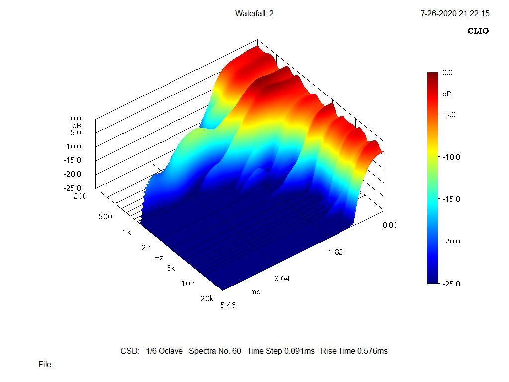

The time frequency resolution tradeoff. ARTA Burst Decay is a very good way to look at this, a good middle ground has been used.Wheres the complication at?
Have a read through this document where this quote comes from
https://www.artalabs.hr/papers/im-aaaa2007.pdf

When you have the original measurement then the parameters can be adjusted to get a better view of each end of the spectrum. A single graph posted does not offer this. It can be useful for comparisons if different devices have been measured and graphed with the same settings.
No disagreements...while I have your attention...within rew, whats the FFT view fur? Looks like REWs version of burst decay.
If you mean the Fourier mode in the spectrogram, then it looks similar but it is not the same as Burst Decay. The Wavelet spectrogram is a better option.

In REW CSD is a mode in the waterfall graph, a Wavelet Spectrogram is just that, both are graphs to show frequency vs time but they are not the same thing.
CSD is Cumulative Spectral Decay and appears like a waterfall graph.

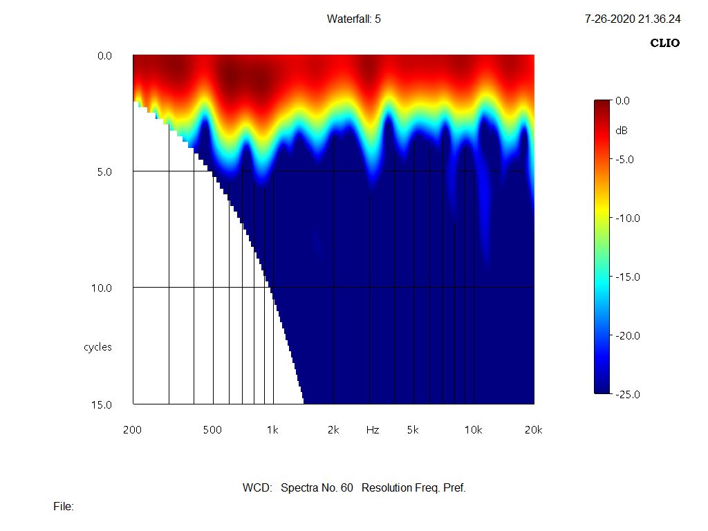

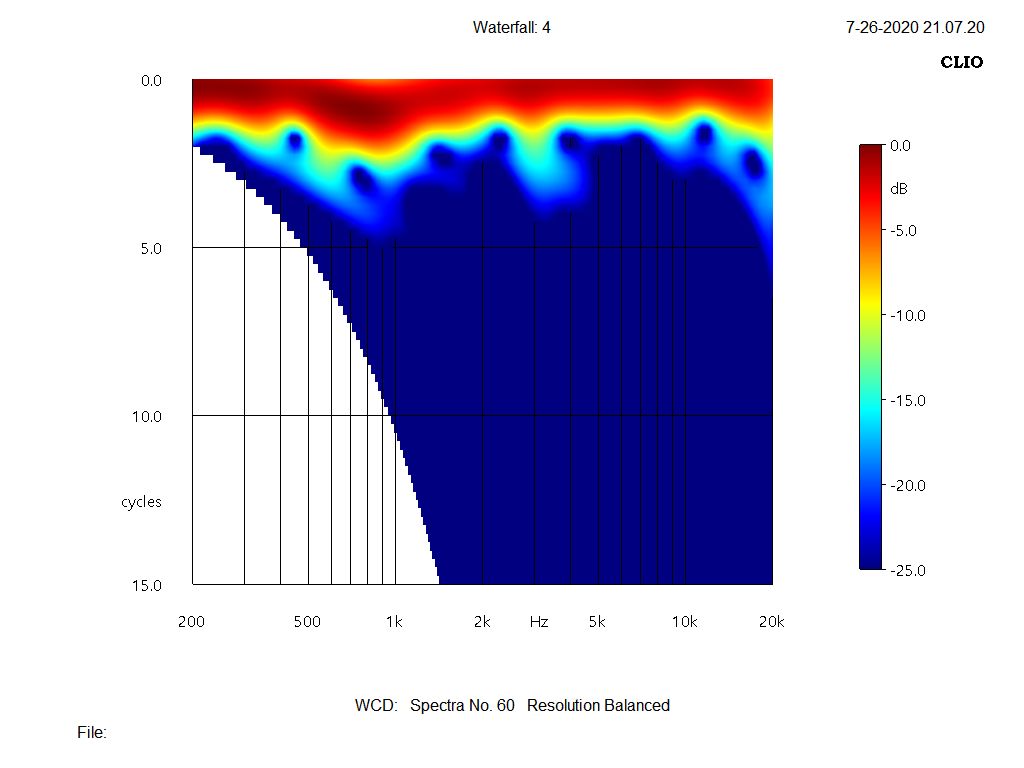

Just so you can see the differences, same measurement one a CSD waterfall a Frequency biased wavelet and balanced wavelet. This is from Clio Pocket

Ok, I'm going to check it out in rew; waterfall, wavelet, FFT
Ill pick up the details eventually...whats more interesting to me, is the idea that people don't respect them (them being this "genre" of information expression; frequency and spl over time) ...like its a side note....when we could replace the normal FR with it, for a more intimate view....via these different types of graphs of this nature. When they do all the fancy stuff to the diaphragm, harmonic, geometric sculpturing....it is these very details they are trying to improve. Big money is spent on making the harmonic decay be flat and non existent.

The details are important and not knowing them makes discussion difficult. The time and frequency domains are linked what is in one is in the other that is what allows an fft to work. Frequency response graphs are more widely understood and generally easier to interpret.
REW has just added burst decay
Changes in V5.20 RC15:
I couldn't resist slipping in one more feature before the V5.20 release, so the waterfall and spectrogram now have a Burst Decay mode. The Burst Decay mode provides a way to more easily distinguish resonances of similar Q but different frequencies. It does this by showing the way a Gaussian-shaped tone burst at each frequency would decay, but along an axis denoted in periods of the frequency rather than time. On a period axis the extent of a decay is the same for resonances of the same Q regardless of the frequency of the resonance. The plot is produced by convolving the windowed impulse response (using whatever current window settings have been applied to the measurement) with a complex Morlet wavelet analytic signal (a Gaussian windowed complex exponential) to extract the decay envelope then resampling that decay on a period-based scale. That is repeated at 48 points per octave across the frequency span of the measurement, with 10 Hz as the lowest frequency allowed and the burst bandwidth below half the sample rate as the highest.

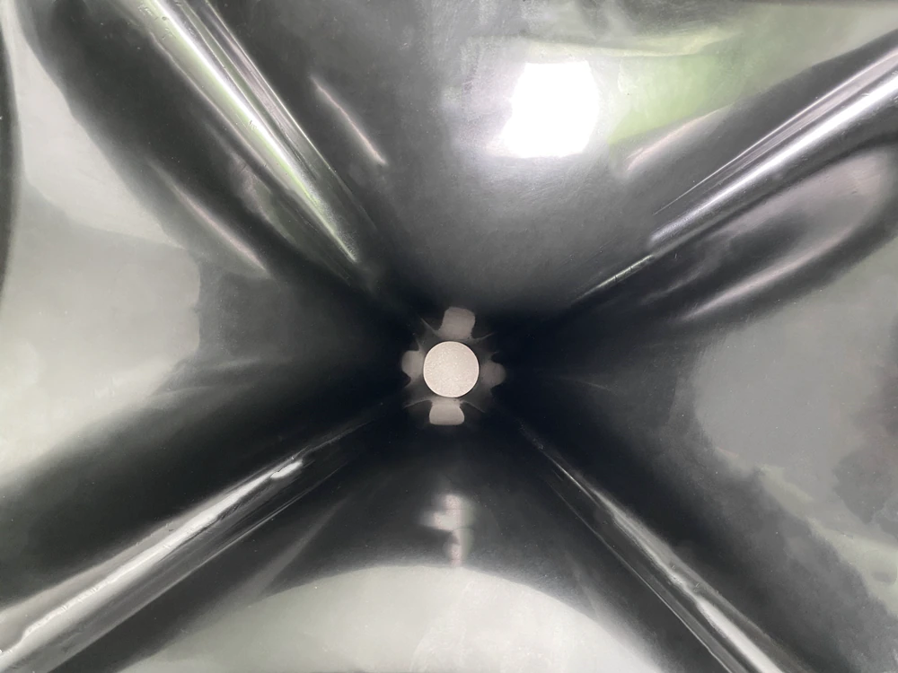

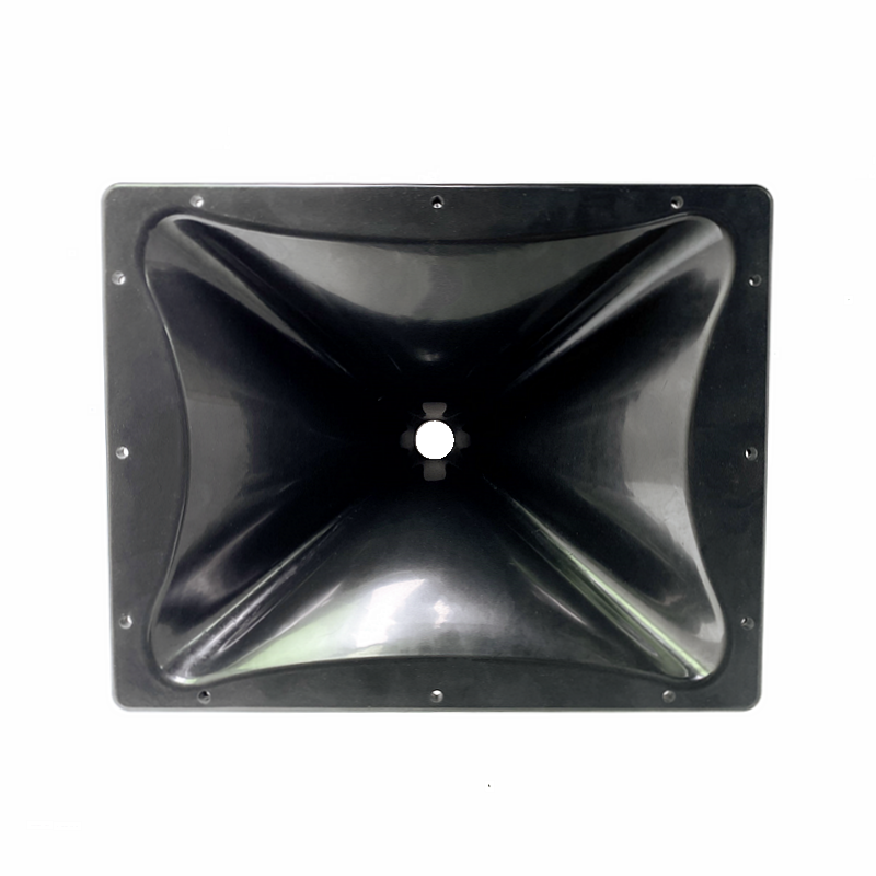

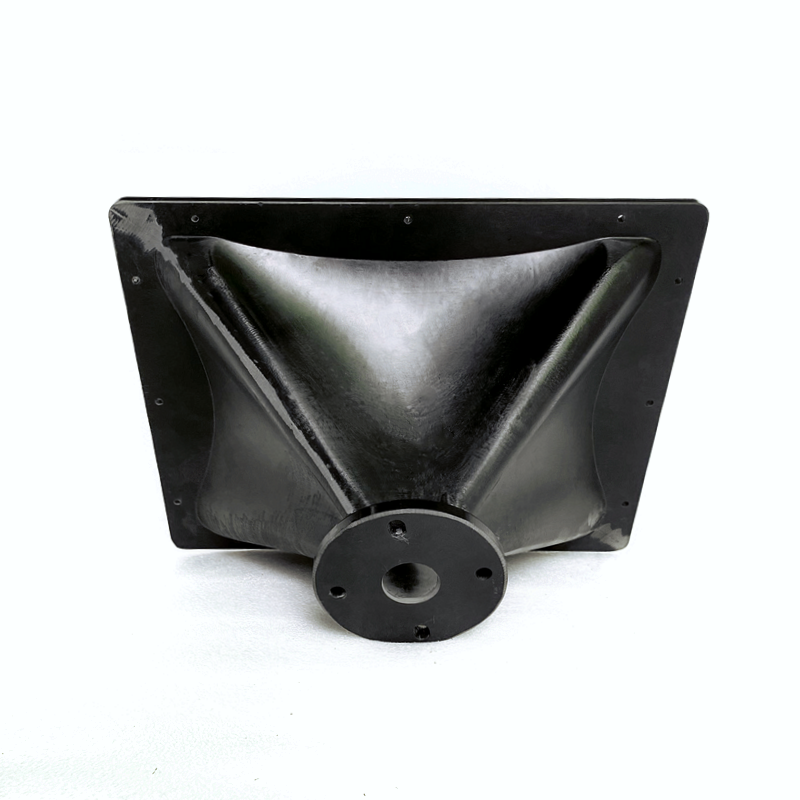

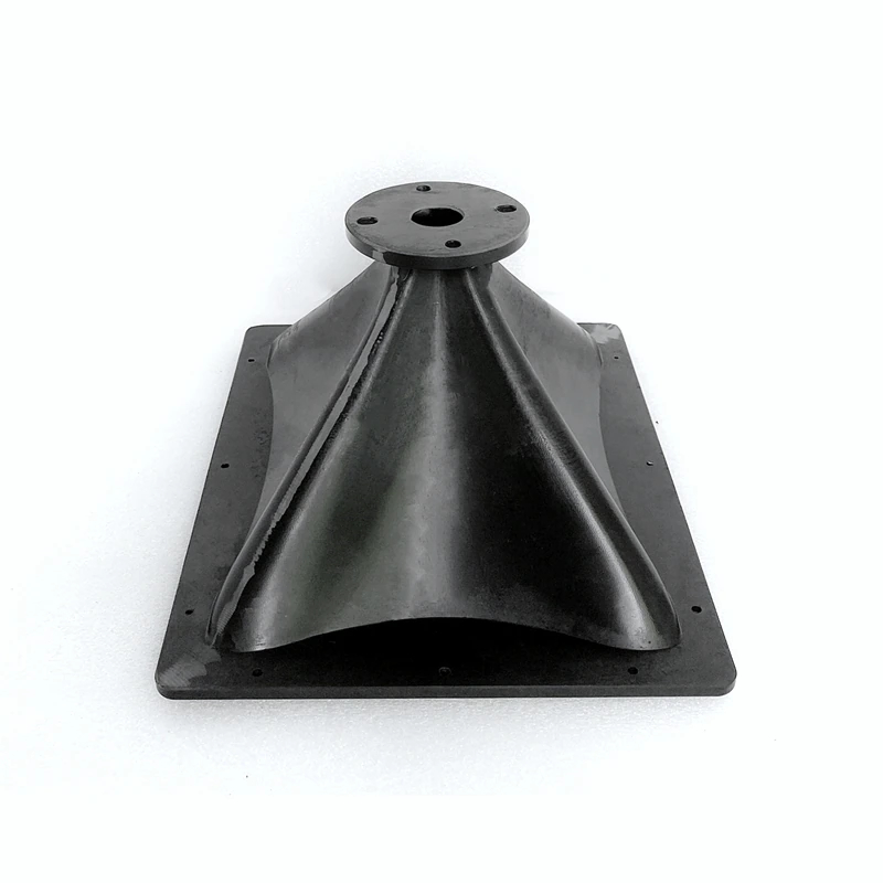

Those looking for a large horn (340 x 270 x 170mm) for 1" drivers, that allows a crossover point below 1000Hz, may be interested in this one.
It is a kind of cross-pollination of the PT-F95HF-1 (Dayton Audio H6512) and the M2 waveguide.
Available on ali for €53.
- JBL M2 for The Poors
