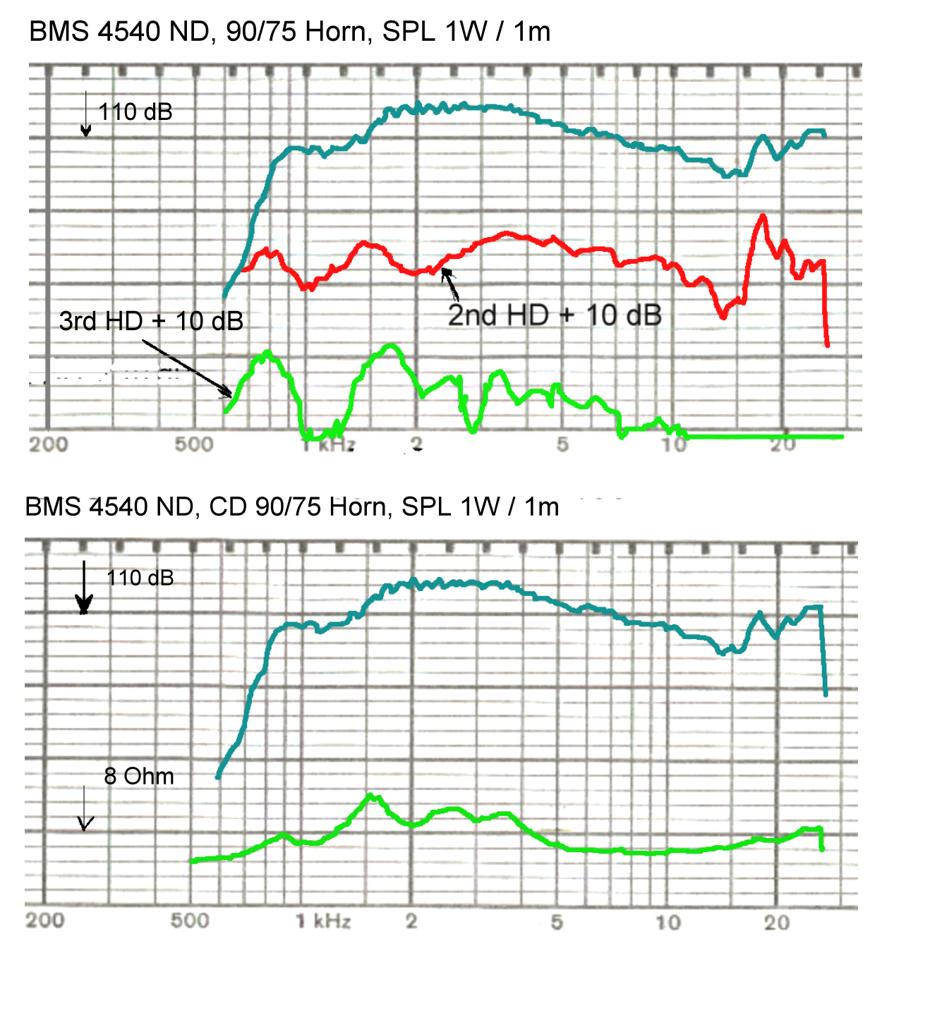

I'm a huge fan of smaller compression drivers; I've used BMS 4540ND and Celestion CDX1-1425 almost exclusively in all of my diy projects for about half a decade now.
My reference monitors use B&C, and in the top octave, the smaller compression drivers sound 'airier.'
I know a lot of people prefer the BMS 4550 to the 4540ND; the former goes lower. This is because the 4550 has a 1.75" voice coil and a larger diaphragm than the 4540ND which uses 1.5".

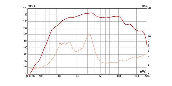

Looks like Eminence has introduced a compression driver that's similar to the 4540ND and the 2408H, but at around half the price.
Here's how it stacks up against the competition:
power handling : 45w vs 60w
efficiency : 112dB vs 114dB
diameter : 9.1cm vs 7.2cm
voice coil diameter : 3.8cm vs 3.8cm
I like the fact that the Eminence is a bolt-on. Way easier to work with.

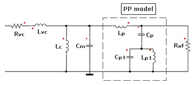

In layman's terms and to give an example of what you'll be dealing with in development of custom phase plugs, here's a simplified (theoretical) electrical equivalent circuit of a compression driver with concentric annular slot (Clifford A. Henricksen).
These are the parameters:
Cp capacitor representing phase plug – diaphragm air mass (Cp =ρoSdld²/3(Bl)²h)
Lp inductor representing phase plug – diaphragm air compliance (Lp =(Bl)²h/ρoc²Sd)
Cp1 capacitor representing phase plug – diaphragm air mass closed to the slot (≈ 1,5Cp)
Lp1 inductor representing phase plug – diaphragm air compliance near to the slot (≈0,099Lp)
Raf horn radiation resistance (Raf = (Bl)²ST/ρocSd²)
Rvc voice coil resistance
Lvc voice coil inductance
Cm capacitor representing total diaphragm mass (Cm = MT/(Bl)²)
