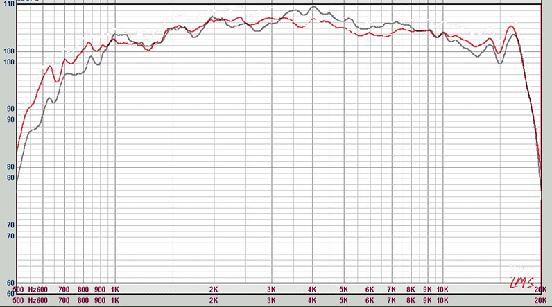

To tell the truth, I've seen a lot of waveguides with charts that look kind of like the SEOS, having 5dB ripple pretty far up into the passband. It's the hardest part about constant directivity horns and waveguides - Many of them have lumpy response.
Hmm, guess I missed it or forgot. I'd prefer to look at it like this, I think.
Now, somebody go get JBL measurements. Nobody has even mentioned it's a full-fledged DSP crossover, have they? Perhaps the averaging is smoothing the spec. sheet lines a lot, sure, but they could have made pretty much everything that isn't inherent to the polar response as smooth as wanted, after all.
I was alluding to the fact that there was evidence of active correction to make the response that flat. Apparently the correction that was done was enough to greatly impress te few that had heard them. If it sounds great, does it matter how you got to that point?
Well, now we're back to a common theme, where a problem must be consistent to correct with EQ- horn artifacts are almost always 3d and not consistent across multiple points, and thus, a correction for one angle/distance would be a further deviation from another.
Of course, a high q notch for particularly problematic resonances/colorations might not be too problematic, since we're less sensitive to dips, but still, I'd expect some artifacts from the weird oblique profile arrangement.
