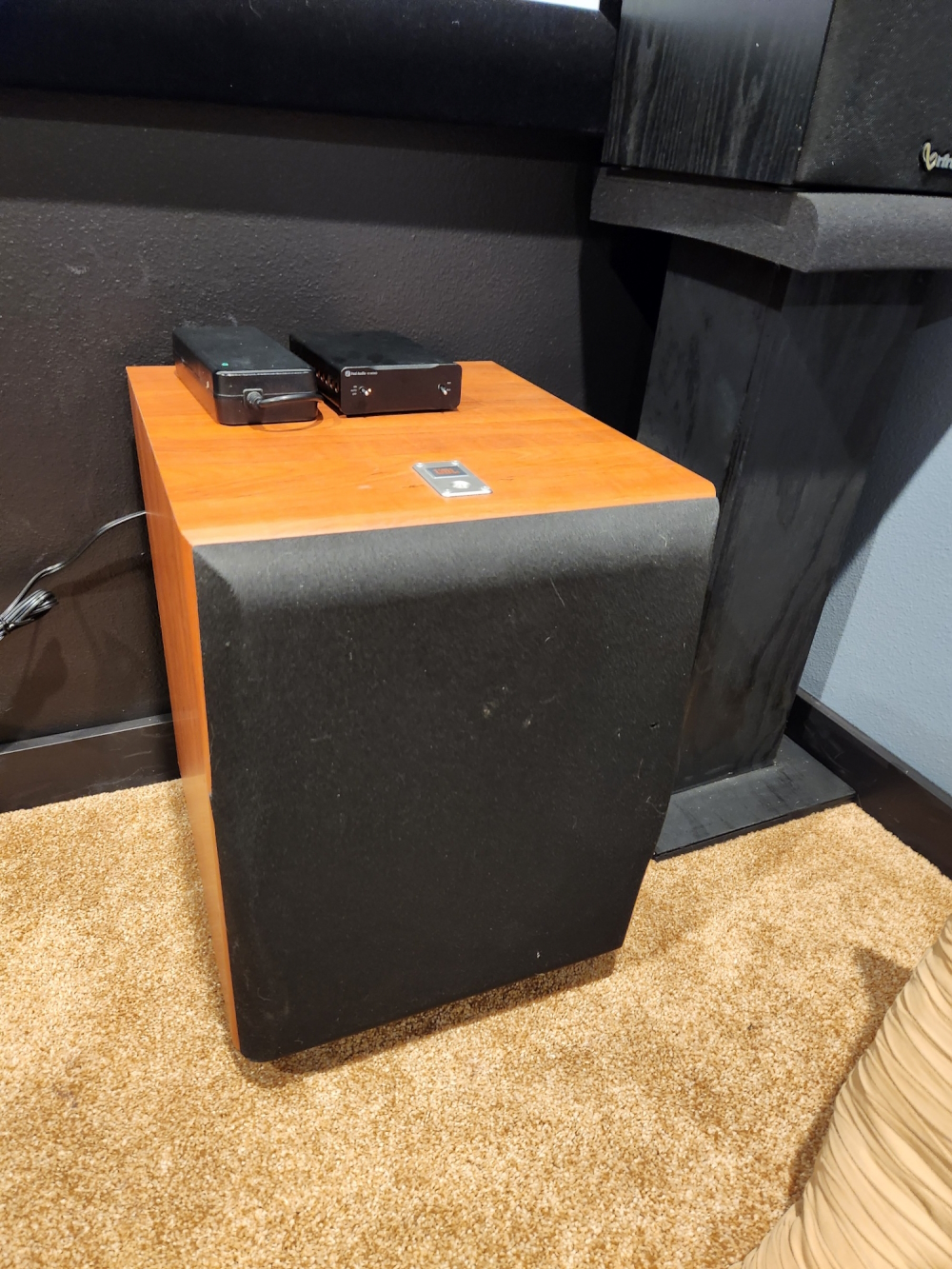

@CH-53K - I've had this for several months and only just got around to completing the install (been busy with home improvement projects!)

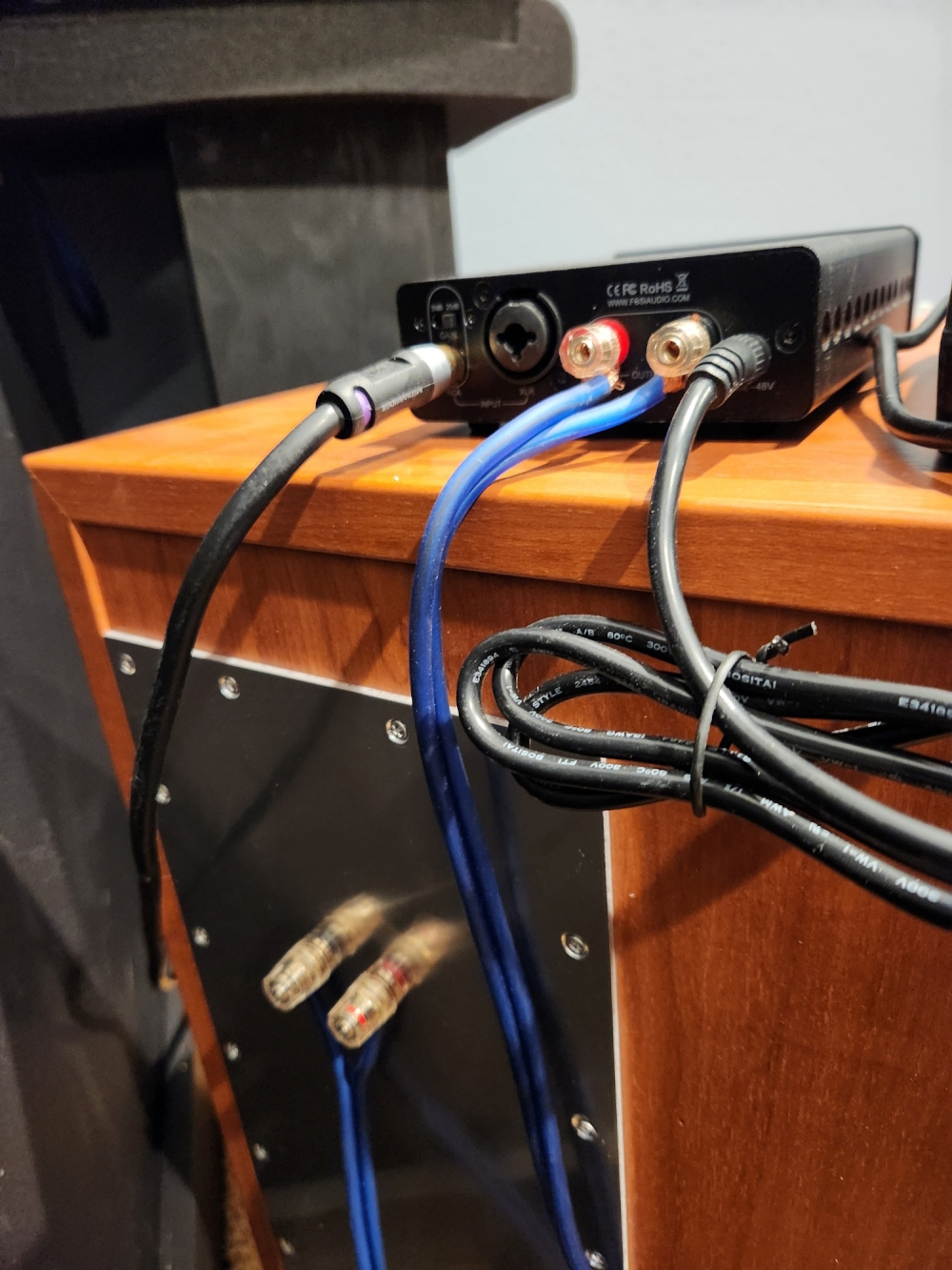

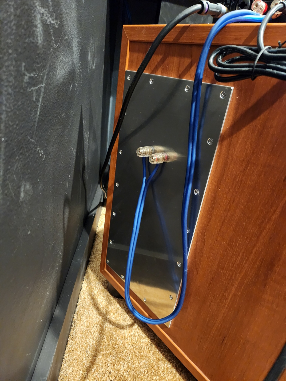

It only took a little over an hour, which included drilling the mounting plate, installing the audio feed-throughs, connecting speaker to those on inside then mounting the plate. Only need to then connect the speaker wires to the amp and the RCA input and connect the Power Supply.
You can see I decided just to leave the Amp and Power Supply external, made for much easier connection with only the two speaker feed-throughs to mount on the plate.
I didn't show the inside but literally you simply remove the original amp and connect the speaker wires directly to those feedthrough terminals.
The result was REALLY pleasing!
I tested with 'Edge of Tomorrow' which has some intense Sub feature at the very beginning.
It did great!
Very pleased with this upgrade.

This is the plate I bought - https://www.amazon.com/gp/product/B0CPLD6Z96
I didn't cut it, that dimension on images is as-received.
Only had to drill holes
And the feedthroughs - https://www.amazon.com/gp/product/B0CPLD6Z96
Those take 1/4 hole and have insulating bush. The spade tabs are a bit small but I just squeezed the female spades on the speaker wires with some pliers before pushing them on and they held securely. You could solder if you prefer.

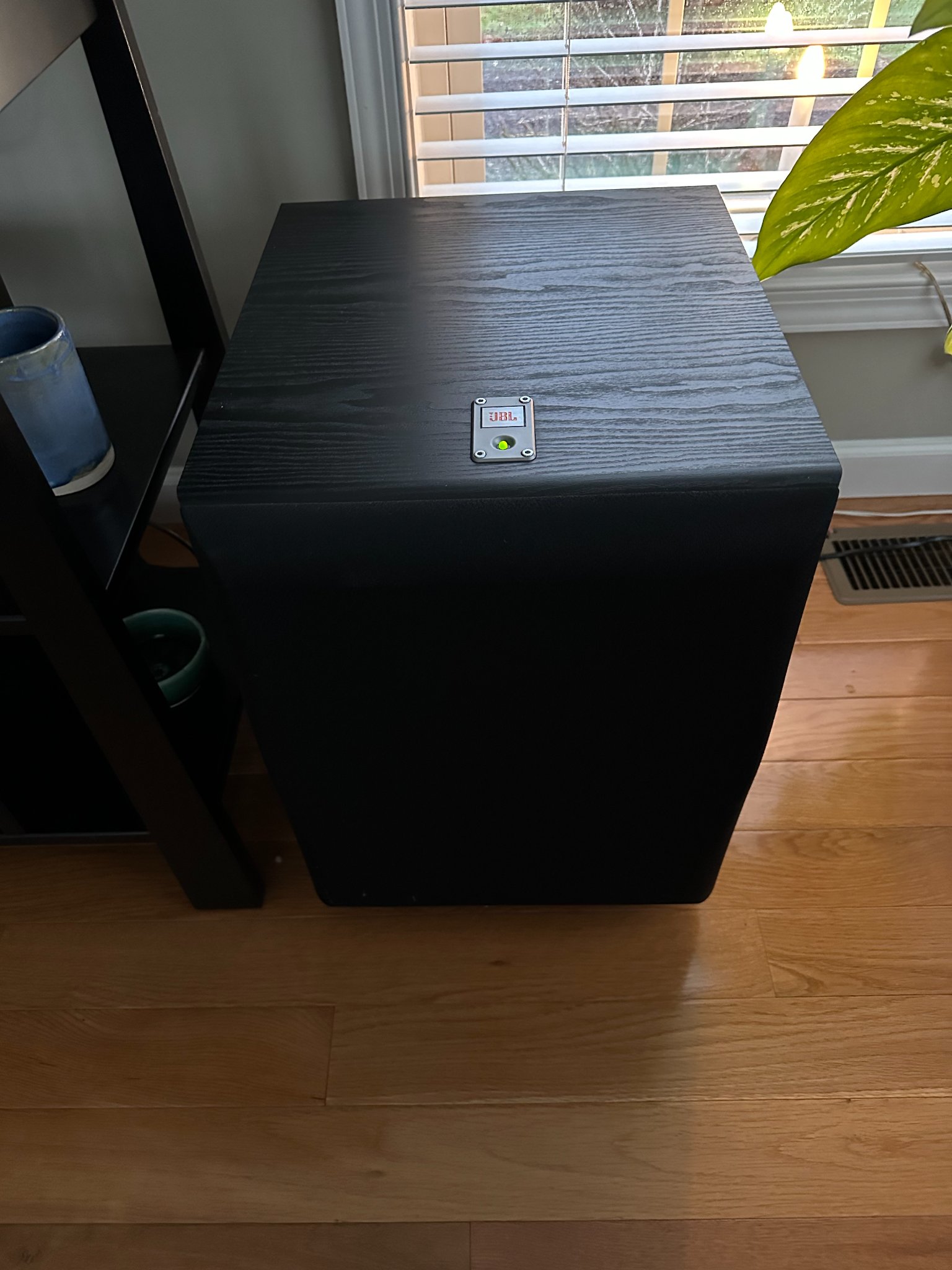

Decosse, you're gonna love this. - Received the new Amp yesterday and figured I would do the install today. My plan was to try and use the the front panel off the old Amp for the cover on the opening. Removed all the screws and gently pried the housing off the face plate. Once inside I noticed a small 5 amp slow blow fuse. Visually couldn't tell if it was blow so put my meter on it and it was open. At this point I figured what have I got to loose. Replaced the fuse, blew out some cob webs, and put the amp back together and reinstalled it in the housing. Brought it back in the den and hooked it back up to the receiver and fired everything up. Found the movie trailer to "Edge of Tomorrow" and turned it up to 11. So far so good! Something caused the fuse to blow so I'm keeping the replacement parts handy. 😁
