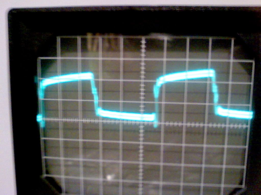

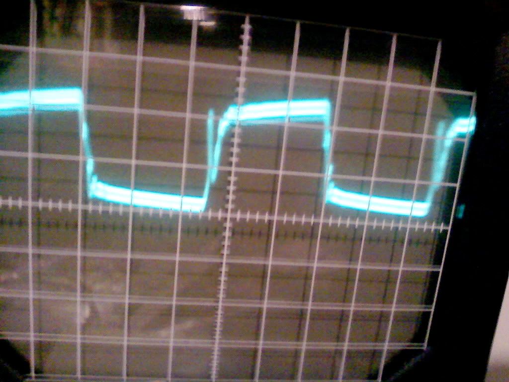

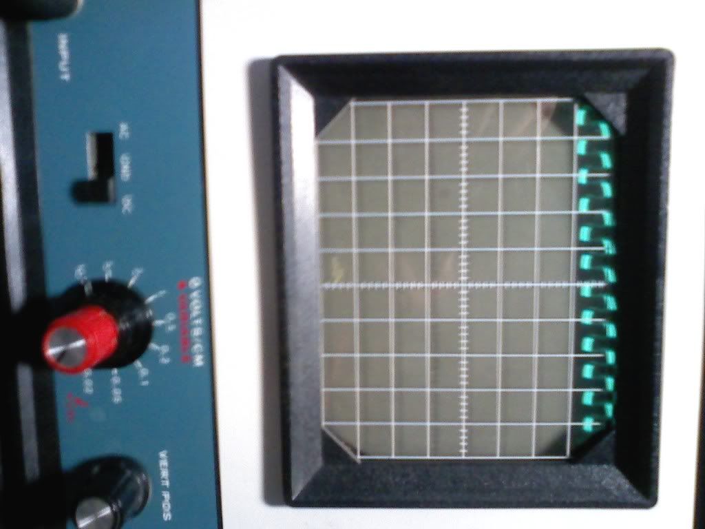

Pics of scope one side of amp then other:
Scope does not show amplitude voltage, cooler side is 35.5V
hotter side is 36.4V Taken at idle no sound input.
paul

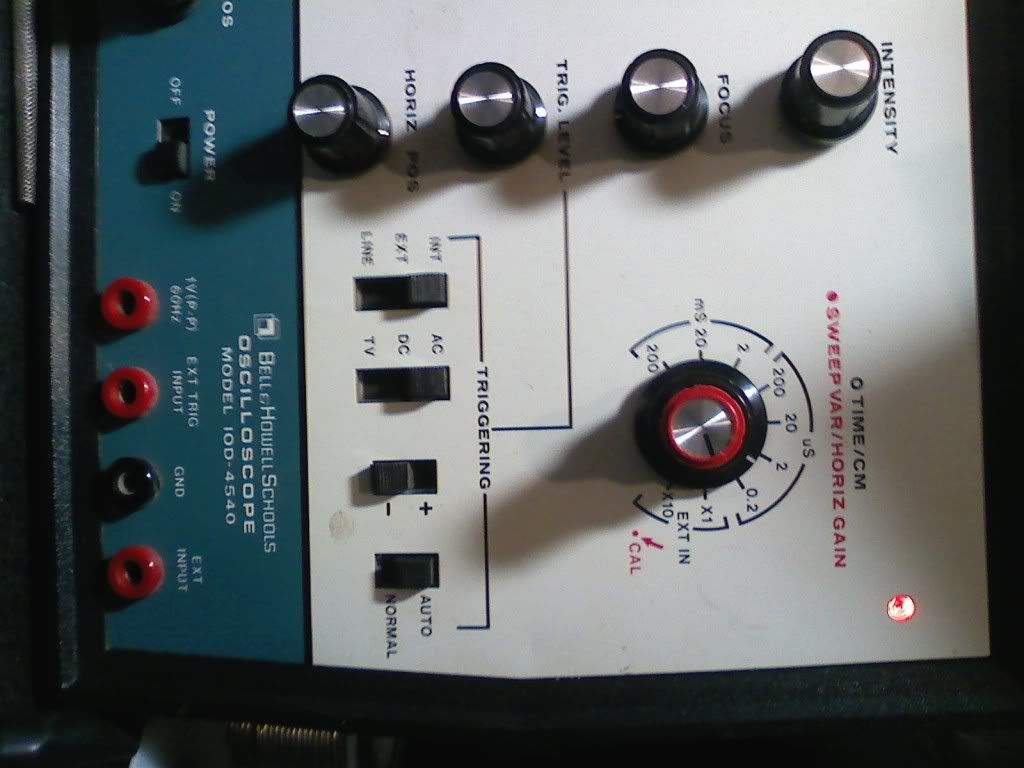

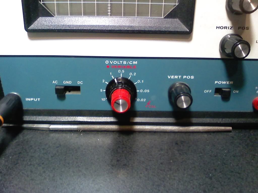

The red knob needs to be in the fully clockwise position. Check the calibration of the scope (roughly) by positioning the trace precisely on the reference line, setting the vertical amplifier to 5v/div and touching the probe to your 12v power supply. It should deflect upwards ~2.5 divisions.
You should also calibrate the probe. There should be a cal test point somewhere in the scope (banana jack marked 1v p-p?). Set the probe so that the tops and bottoms of the calibration waveform are perfectly flat.

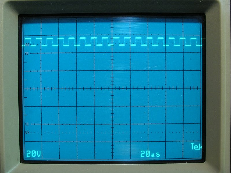

Set the scope the same as in the photo. You should have a drive signal very close to what's shown in the photo (it's DC coupled). If the amplitude is significantly less, we'll have to try to determine why.
After you set the scope, touch it to the B+ terminal to see if it deflects just over 1/2 division.
If this is set to 20v/div, it looks about right but I think your scope needs to be adjusted. That's far more than 3v.
Did you calibrate the probe?

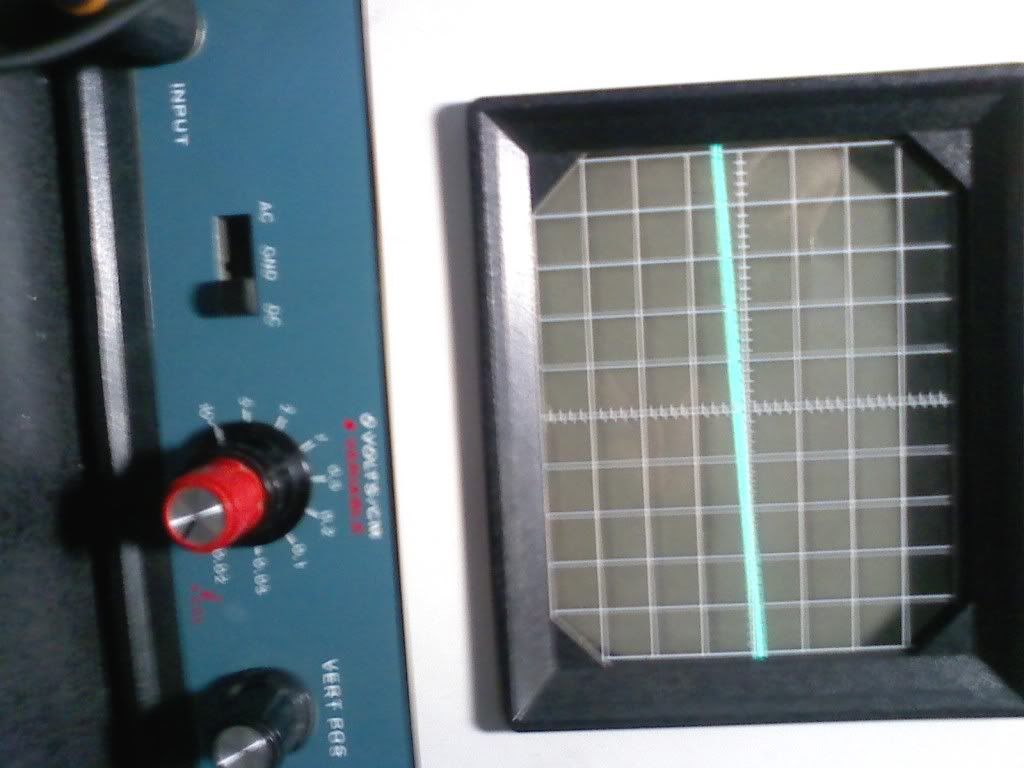

You need to find the astigmatism and focus controls. Adjust them (alternately) until you get a clean, sharp trace.
Also find the trace rotation pot. it will straighten the trace. If the trace is straight when the scope is in other locations, you may have a strong magnet near the scope that's pulling it off.
